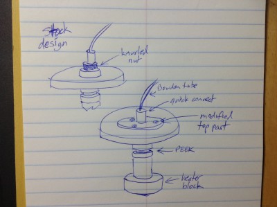

Why do all the hot ends I've seen on the web have a mount that cannot be secured? The stock Rostock Max hot end depends on a single nut staying tight, and groove mounts seem like they were designed to make their attachments fail.
I'd think it would be simple to put a horizontal disk at the top of the hot end with three equally spaced holes drilled vertically through the disk, all one piece with the cooling fin area. This could be securely fastened to the platform using screws, and wouldn't rotate when swapping the nozzle or tightening the joint between the heat block and the thermal break.

I'm talking about the top piece. It pretty much depends on friction to keep it from rotating. If the top piece had an integral disk with three holes to bolt it to the melamine piece rather than using a single knurled nut, there's no way it would rotate.
A groove mount depends on friction to keep it from rotating too. It just doesn't seem like a good starting point, and I was wondering how it came about.

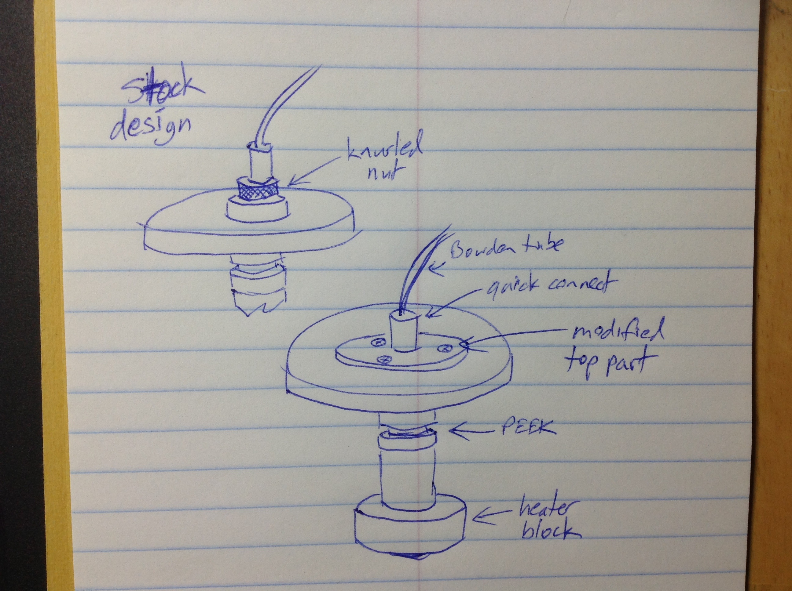

Here's a sketch of what I'm talking about.

Well, of course it'd work better to bolt the disk to the bottom of the melamine piece to avoid the need to take the hot end apart to mount it.
How did you bolt in your Jhead? Did you drill holes in the groove mount for the 3 bolts?

What keeps the hot end from rotating inside the kossel mount?

dbarrans wrote:What keeps the hot end from rotating inside the kossel mount?
- dan
Friction. The groove mount I'm using for my E3d is a very tight fit that get's tighter when you bolt it down to the effector.

There is no real force trying to rotate the Hotend, so it's unclear why you would complicate the mount when friction is sufficient.

It just seems a weird way to design something that's subject to lots of vibration and high acceleration in random directions for hours at a time. I would have started with something involving screws rather than friction to hold it all together. Seems like something that depends on friction alone would work itself loose after a while.
Yes, I know *all* fasteners ultimately use friction, but at least screws have the mechanical advantage of leverage to help hold objects in place.

I would guess the current groove mount originated with the JHead, it's popularity is likely what established it as a standard.
I've personally never had an issue with a Hotend rotating and causing an issue. So my assumption is the design is sufficient.
