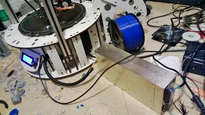

I had a cheap power supply I bought off ebay.
http://www.ebay.com/itm/261199349527?ss ... 1497.l2649
Well it now glows bright orange on the inside when the heated bed kicks on, so needless to say, I no longer feel comfortable using it. I imagine the Onyx bed is pulling more amps than it can supply. I was curious where everyone else got their power supplies? Hopefully it's fairly cheap as I've already put a ton of money into my printer.

what's glowing bright orange?
the onyx draws 18amps max.
not that it matters but that's a 14amp power supply you linked. what's more curious is what is glowing bright orange? just a light or something actually overheating?

It appears to be a ceramic pill shaped cap. There is debris around it that looks to be chips of its casing and its the exposed leads that are glowing red hot. It only glows when the Onyx is drawing power. Other than the glowing, it still functions. Its good to know that the fuse right next to it doesn't feel like popping

I'm sorry, I must not of done a very good job explaining what was glowing. Its actually a component inside the metal case of the 24 volt power supply unit. My RAMPS board is actually running off a 12 volt ATX power supply. The only component running off the failing power supply is the Onyx bed.
Re: Source of 24 volt 20+ amp Power Supply
msdevstep wrote:I'm sorry, I must not of done a very good job explaining what was glowing. Its actually a component inside the metal case of the 24 volt power supply unit. My RAMPS board is actually running off a 12 volt ATX power supply. The only component running off the failing power supply is the Onyx bed.
ic, i misunderstood you then, in that case return that power supply some of those are known to be bad out of the box. there cheap for a reason..

Do you think getting another 14 amp one would work for the Onyx or should I look for something bigger?
14amp will work just dial down the voltage a little to keep the onyx from overdrawing from the power supply, but higher amp wont hurt either. I'm using the same supply that eaglesoar posted.msdevstep wrote:Do you think getting another 14 amp one would work for the Onyx or should I look for something bigger?
onyx draws 18amps at 24v for few seconds at power up. then drops quickly to whatever current it needs for the set temperature.

I'm pretty much using the same supply. Here is what I am using.
http://www.amazon.com/gp/product/B007F7 ... UTF8&psc=1
My Onyx measured 1.6 ohms. I lowered the power supply to 21V with the adjustment pot on board
21V/1.6 Ohms=13.1A
I don't have an ammeter that can check to see if it surges more than that at first startup, but my supply has been working for months with no issues.
21V/1.6 Ohms=13.1A
