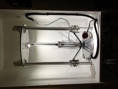

Update 2-26-14 My printer is almost complete
Posted: Wed Jun 19, 2013 9:50 pm
by thenewguy
Going to hook up a arduino separate to the printer. This will allow my glass window to open and close with a push button, stepper motor, limit switches. Ect. May also use it to control temps inside the case or other needs.
May put some amp and volt display at the bottom of the case for fun next to the buttons.
Have two rolls of film ready for dual extruders at the top right.
Have most of the parts to switch to magnetic ball joints.
Since I upgraded my power supply which is still 12v but almost 60amps now I beefed up my heating bed with mic-6 and around 300watts to heat it up. Takes about 15 mins to get to 100c which is still longer than I thought but not bad! Before with the onyx under it took over an hour for that big mic-6.
This is also on a relay to the Rambo.
Can level the bed with screw adjustment so far no problems with heat.
Had to fill in the slot that I cut out for the onyx. So just put some blue leds on one of the heating elements so I know when it turns on and off. : )
Hopefully more mods to come and better pictures...

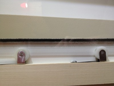

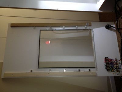

The buttons are for power, reset on Rambo so I don't have to take the front cover off all the time and two are for my 10 watt leds. One at the top and a adjustable one on the side. Two buttons are spares and the blank two holes will be for up and down buttons for the glass window which I'm impressed with. It seals pretty well from the room. Just need to rig something up to move it. I'm thinking a timing belt stepper motor and some limit switches on an arduino will work ok.

Back of door
Back of door
Closeup
Closeup
Front door off
Front door off

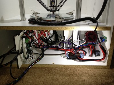

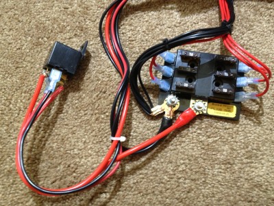

Relay for bed. Each one is fused
Relay and fuse holder for bed

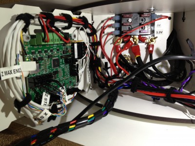

Rambo
Rambo
I have a little bit of clean up with wires to do...

Can I ask why after all that work, amazing btw, you don't have an lcd controller mounted outside that box?
Re: My printer is almost complete
Posted: Thu Jun 20, 2013 5:51 pm
by thenewguy
Because I bought this in December. Tried many ways to get the thing working right with Rambo. Don't know if it was a lose wire. Something was backwards or the firmware.
So I said I don't need you anyways... Haha
Been anti ever since.
I like using host on my 32inch pc screen. I have a dual video output on my graphics card and had a old thick but decent size pc screen laying around maybe 17 inch. Ended up being to heavy, thick, and just really had no place to mount it. I thought about putting it on a hinge and mount on the side of the box or something. Just felt like overkill. I got it from work. So it's old school but was very expensive at the time. Maybe $1500

So I thought I would give you a good update. I have taken this thing apart so many times with constant upgrades I don't get to many chances to print. But I do finally have it working close to how I want it. I do still have to install the Arduino controlled glass window. Other than that
Enjoy.

Now those are some nice upgrades! And a nice enclosure.
A very good job!
