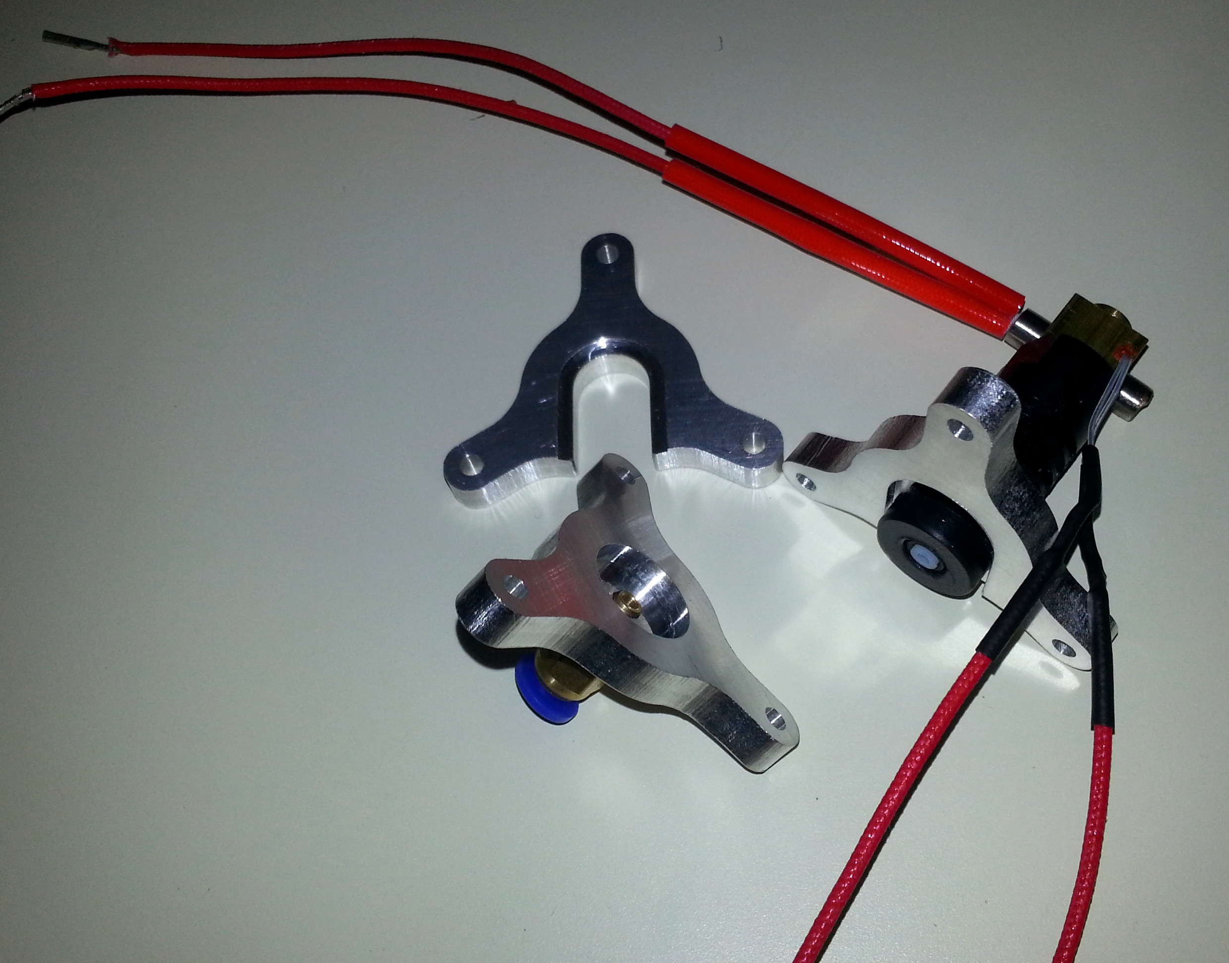

I don't know if you have seen these but Cambo3D has a very cool two piece J-head mount for sale that accepts the brass fitting from the stock Rostock Bowden Tube. These are designed to fit on the stock Rostock effector base.
In this photo, I have a hotends.com j-head that I have inserted into the bottom piece of the mount. The other mount with Bowden tube brass fitting goes over the top of the head keeps the J-head securely in place.
Also in the photo is a mount for the E3D head.
To install these, you can use the stock 1" standoff (metal tube); however, i think you'll find the distance between your head and the effector base a little tight. You might consider 3/4" standoffs. (Don't forget to recalibrate!!!)

hey that mount looks good.. :D
but just for anyone that wants one, this is same mount (well almost the same) listed on thingiverse that is 3d printable.
I just made this version in aluminum and custom fit for the ed3, rostock, and also other jheads.
