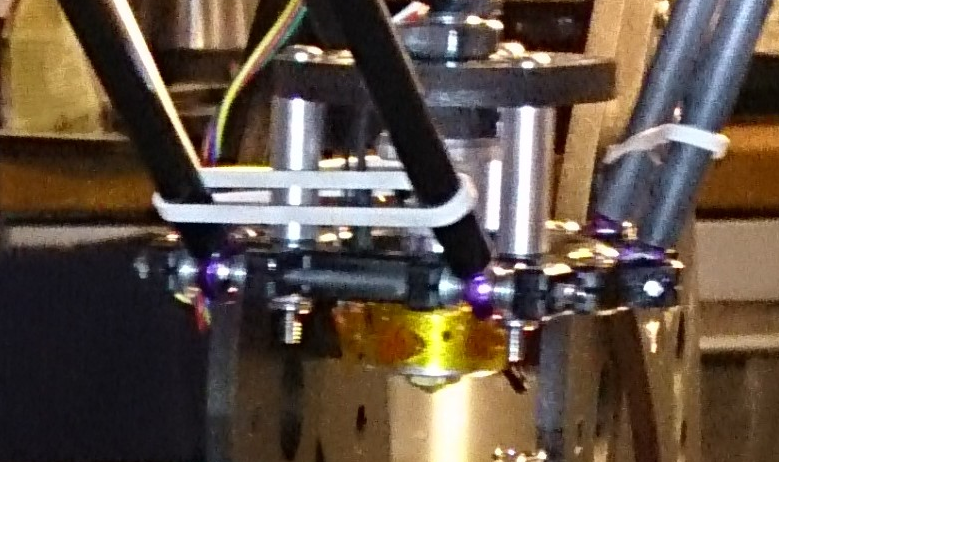

I thought I was being very careful when I spent over an hour sanding the Ujoints. And even after that I ended up over sanding two spots. I now have a little side to side action, about 0.011" on the worst one. What should be used as a shim?

Use rubber band, it takes up the sidelash

Yes Tricklaser are fine but for a quick fix i think rubberband will do it in the short run, i made my own 6mm carbonfiber arms with ballends from Hobbyking 3mm 5pc 4.88$, but then you have a problem with the axles witch are not metric

When I built my effector, I didn't like the pockets molded in the brackets. The ones that look like they accept a nut. So I machined a delrin washer to fit in the pocket. Does two things-1. more(flatter) bearing surface for the aluminum joint to run on, and 2. I could control side lash by the washer thickness. It's tricky because it's a small part to machine. They seem to be working though.

I went out and picked up some delrin washers from my main shop. I haven't fitted them yet, I think I can make them work.
So the rubber band idea is to please the rubber band around the two the arms to act as compression, is that the idea? When I first read Gimbal's reply I was envisioning placing the rubber band between the housing and the alum ball joint.

So I guess I was wrong. I didn't over sand them, at least that turned out to be the case once I installed the ujoints on to the carriage. Once I did that I had to sand them again. Now I feel like I have been sanding parts for two days. I think I'll put the beer down, go to bed, sleep, grad a cup Joe and continue in the AM. This build is taking a bit longer than I was expecting it to.

I am finally past the point of sanding. YAY
I used a wood file and then the 7 emery board trick from here:
http://forum.seemecnc.com/viewtopic.php?f=42&t=1527
A little lithium grease helps out too. On to the next part of the build.
