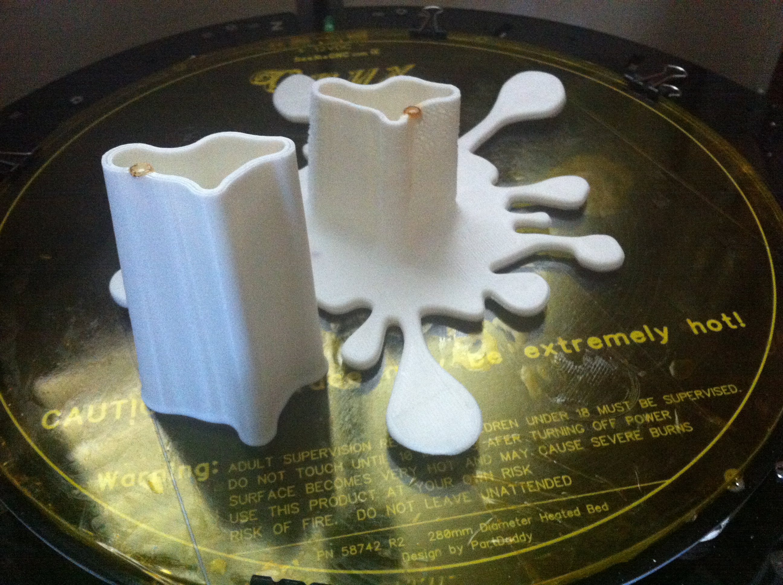

Hey folks
I'm not sure if it's the model I'm printing, mechanical, something with the Cura slicing code, but it's STOPPING the printing...yet the bed and Nozzle heat stays on.
Seems to always be a ways into printing a larger model at different heights.
Reset the printer and the motors run, heat works etc.
The only mechanical change was I added a small Fan to the board and it's on during the whole print. I've seen people with 3 or more fans on the Rostock and I insulate any exposed wires.
I also upgraded to the ONYX but this happened before I installed the ONYX bed.
Anyone else experience this problem and know the solution??

Re: ROstock Stopping during printing?
That is one pretty blob.
Seriously, I suspect something in the code is causing the problem. The first thing I would try is a different slicer either Slic3r or Kisslicer and try the print again.
I suspect that the print will continue with a different slicer. What is in the code causing the problem? To answer that would require that you post the code generated
by Cura and someone on the forum with more knowledge than I would have to take a look at it and try to find the offending line. Please try the different slicer and let
us know the results.
