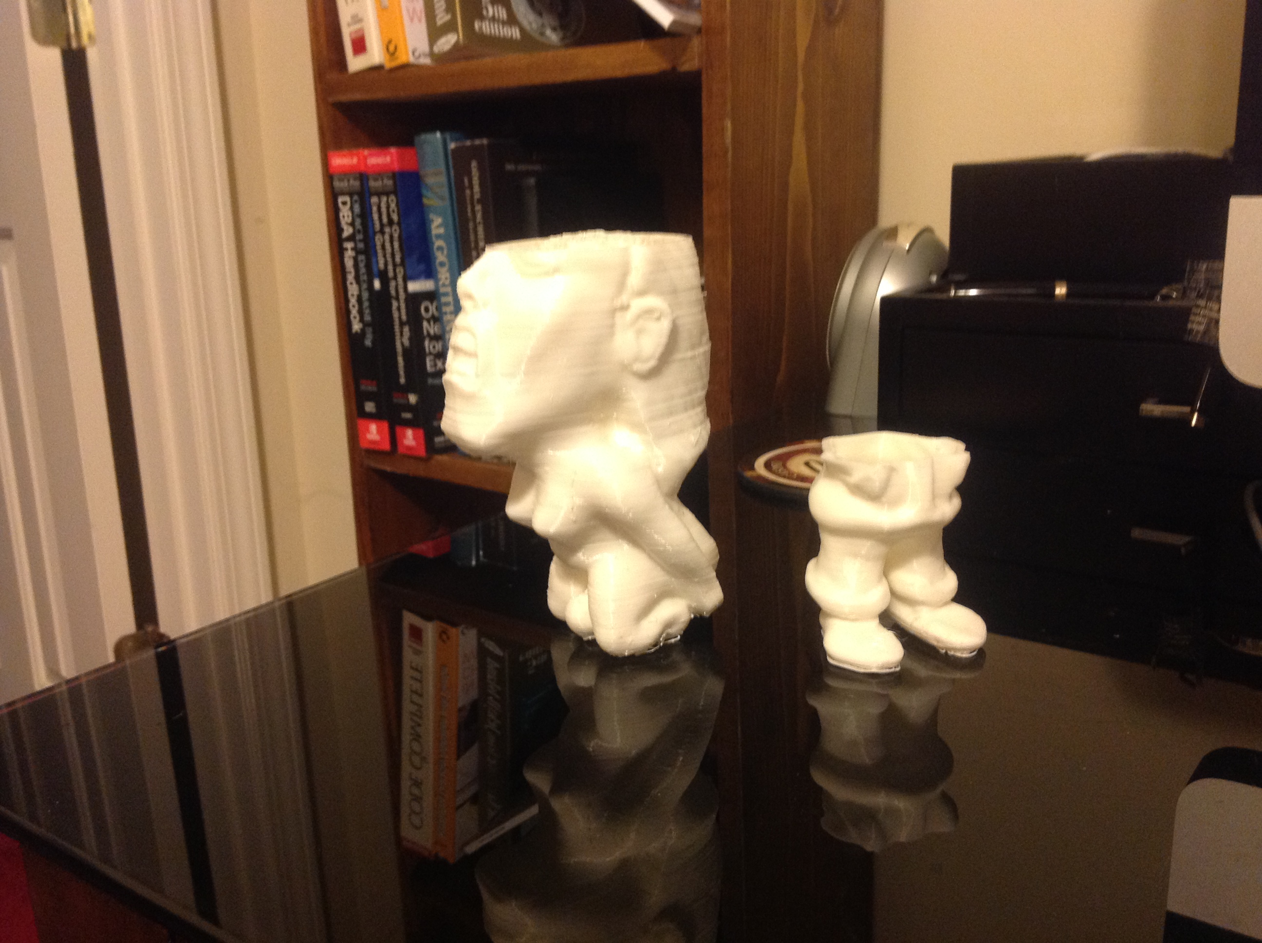

I did several prints over the weekend since I finally seem to have my hotend working (yay!). Most of the prints came out great. There are two that I ran into a problem with however. The first was this guy: http://www.thingiverse.com/thing:27408 He was printing great until about halfway through. It appears that the nozzle tugged just enough on him that he was spun and then of course the print was ruined. I initially put this down to the base coming unstuck for some reason. I wasn't in the room at the time so I can't be for sure exactly what happened. I do have a great looking half of a gnome is someone needs one..
the second print I started was this one: http://www.thingiverse.com/thing:89654 This one was going to be a 7 1/2 hour print. I went ahead and started the job as I figured this would be a good test of a long running print (the longest I've done so far took 3.5 hours and came out great). At 7 hours of the 7.5 I heard a tearing sound and saw the print get pulled up a little from the bed. The layers got shifted at that point and the remainder of the print was going to be ruined so I killed the job. (I have an idol that looks like she's had brain surgery. I may turn it into a planter..) Now if the point where the job got messed up was at the same height I'd say it was definitely a calibration issue of some sort, but the idol was at a point nearly 4 inches higher than wear the gnome got ruined.
So, could it maybe be a slicer issue that would cause the nozzle to "dip" during a travel and catch the print, or might it still be a mechanical calibration issue of some sort, like a belt slipping or something?

On tall prints with small bases, the nozzle dragging over the print will have a lot of leverage will easily knock a part off of its base. Why this happens is the harder part to figure out. The part could be warping as it cools. This tends to magnify on each layer and will cause problems the taller a part gets. The other thing that may be causing behavior like this is when your extruder steps per mm or slicer extrusion multiplier is off. If you're overfilling the part, it will eventually become convex and hit your nozzle.

I have had prints where a small loop or bump of abs, that gets raised, catches the hot end. This has caused my glass to shift. Make sure you have plenty of clips holding it. I also have z lift set to lift the hot end over/ crossing perimeters and on retracts. My last print of the Voronoi lady was pretty tall, and was set to use a raft, which I think printed as just an extra base layer. Consequently I sweated every little raised loop and bump!

Here's the two candidates for the island of Misfit Toys that I got ruined.
