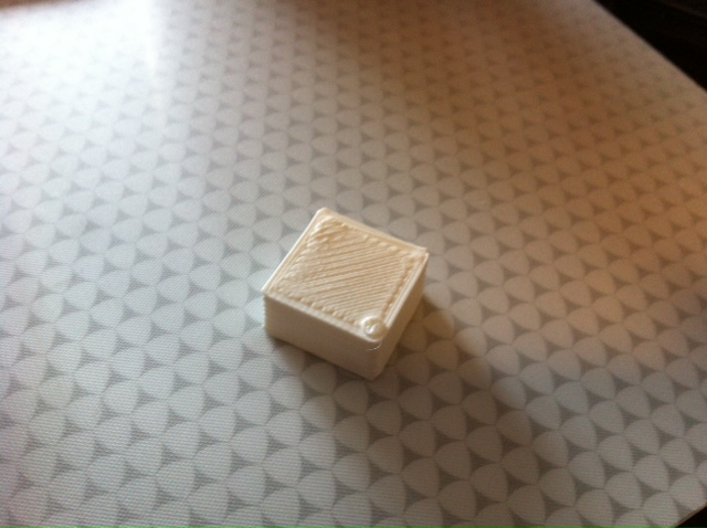

The postman just arrived and delivered my PTFE tubing, so I got to try some more printing.
I'd had marginal success with a couple of hollow test cubes in yellow PLA before I clogged the PTFE tube beyond rescuing.
I thought I'd take a step back and just print the 20x20 text cube to get the settings a bit more dialed in.
Using White PLA this time on blue 3M masking tape, I had a heck of a time getting the bottom layer to stick in the end what worked was slowing down the first pass to 20% of the regular speed, and setting the first layer layer height to 0.9 in slicer.
There is certainly more improvement to be had, but the prints look pretty good.
The bottom layer is overly squished as you might expect, but considering I'm still using the plastic bearings, and no fan or other additions I think it came out pretty well.
Hopefully others having issues with the base layer will find the slow the base layer down tip useful.
Anyone else have tips for getting PLA to stick better to Blue tape?
I think there is some fine tuning that can be done with the temperature that could improve it further.

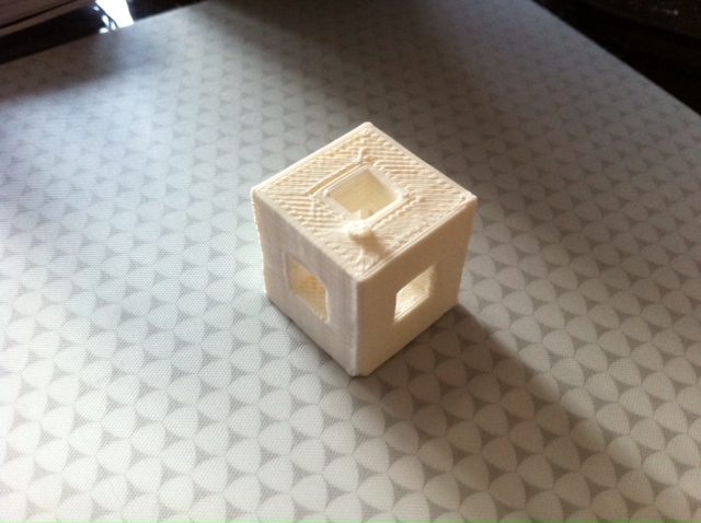

Just finished a bridging test cube
Quality is pretty acceptable, watching it print I have some pretty clear backlash in Y, and given the way the plastic idlers are squeaking, I'd guess at least one of them isn't turning. I have some skate bearings, so I may try and replace them, then tighten the belt see if that helps.
I Also have the bearing upgrade kit but it'll be at least the weekend before I get to that.
Overall though I have to say I'm impressed how well the completely stock kit prints, though I'm using a RAMPS board in place of the stock electronics I doubt that has much impact on the print quality.
