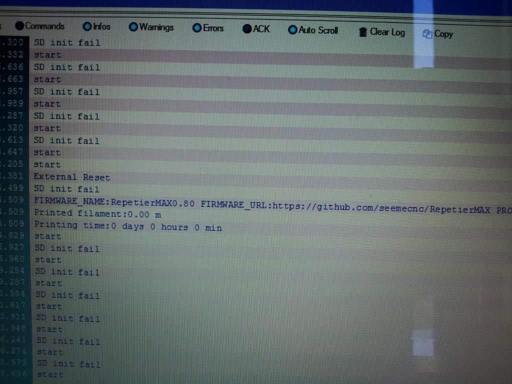

I've installed Repetier and my comp recognizes the printer (com 3) but once its connected Im getting "SD init failed" after the successful host log info comes up.
[img]http://i1326.photobucket.com/albums/u65 ... dd866a.jpg[/img]
"SD init fail"

Do you have the lcd controller? Is there an sd card plugged into it?

i have the lcd and just started installing the software. i was following the manual and i got to this point.foshon wrote:Do you have the lcd controller? Is there an sd card plugged into it?

Is there a SD card plugged in?
What firmware did you upload?

I FIX IT. I was following the manual, but the manual did not show how to install the firmware in Arduino or that i should do that first. Once I figured that out, it works like its supposed to.

You already had firmware installed, it says so in your screen shot. Did you install a newer version?

I installed Arduino, then Repeteir, then the Rambo driver. I started getting the issue when I started Repetier. After rereading the first couple pages of the software part of the manual, I downloaded the Repetier MAX zip from github.com and installed it through Arduino. Apparently I needed to do this first in order for Repetier to full recognize the Rambo, but the manual doesn't mention installing the firmware until 8 pages later. At least for me, that was the steps I needed to do before moving on.

There must have been an issue with the original firmware, weird.
