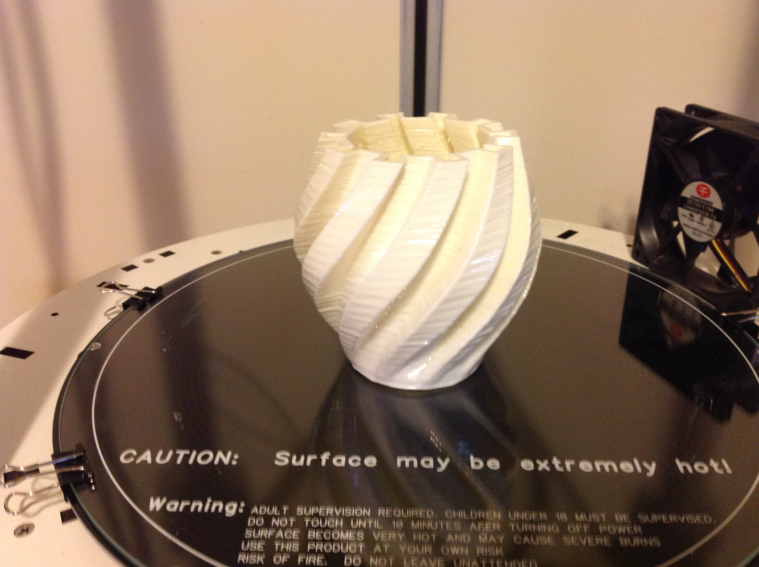

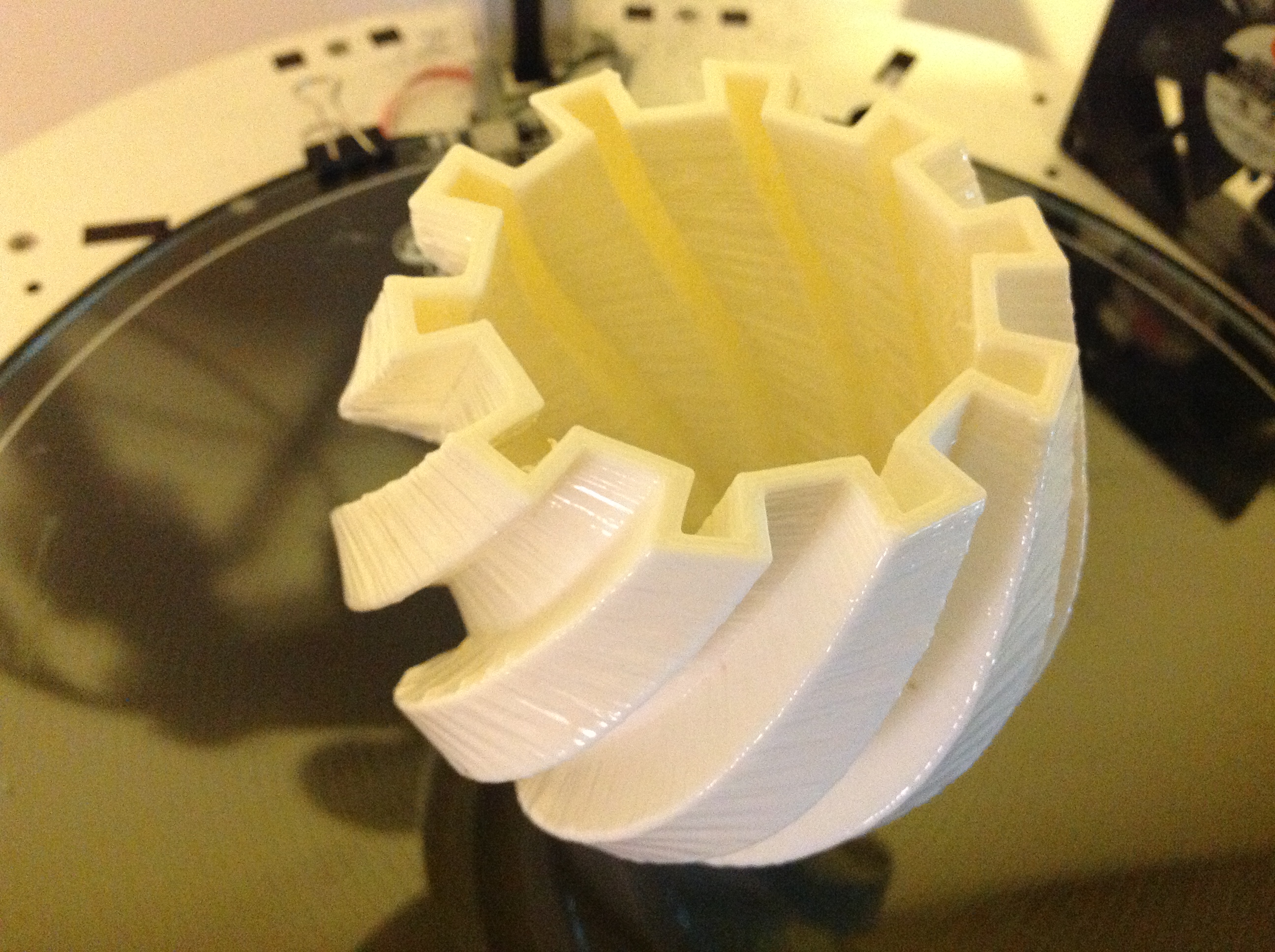

I finally tried one of these twisty vase things. I wanted to bump up my print speed to see how the printer would perform at a higher print rate (for me). I printed this at 60mms. I also tested some acetone vapor smoothing on this too - put it in a covered sauce pan sitting on a canning jar lid and set the print bed to 100c. Left it in for a few minutes. Came out ok.

Try printing them with a single wall thickness and use continuous Z lift during the print. Reduce the model to 70 percent size (.7 scale) and it's perfect for LED tea lights. Use translucent plastic. I've done probably 40 of them in PLA.

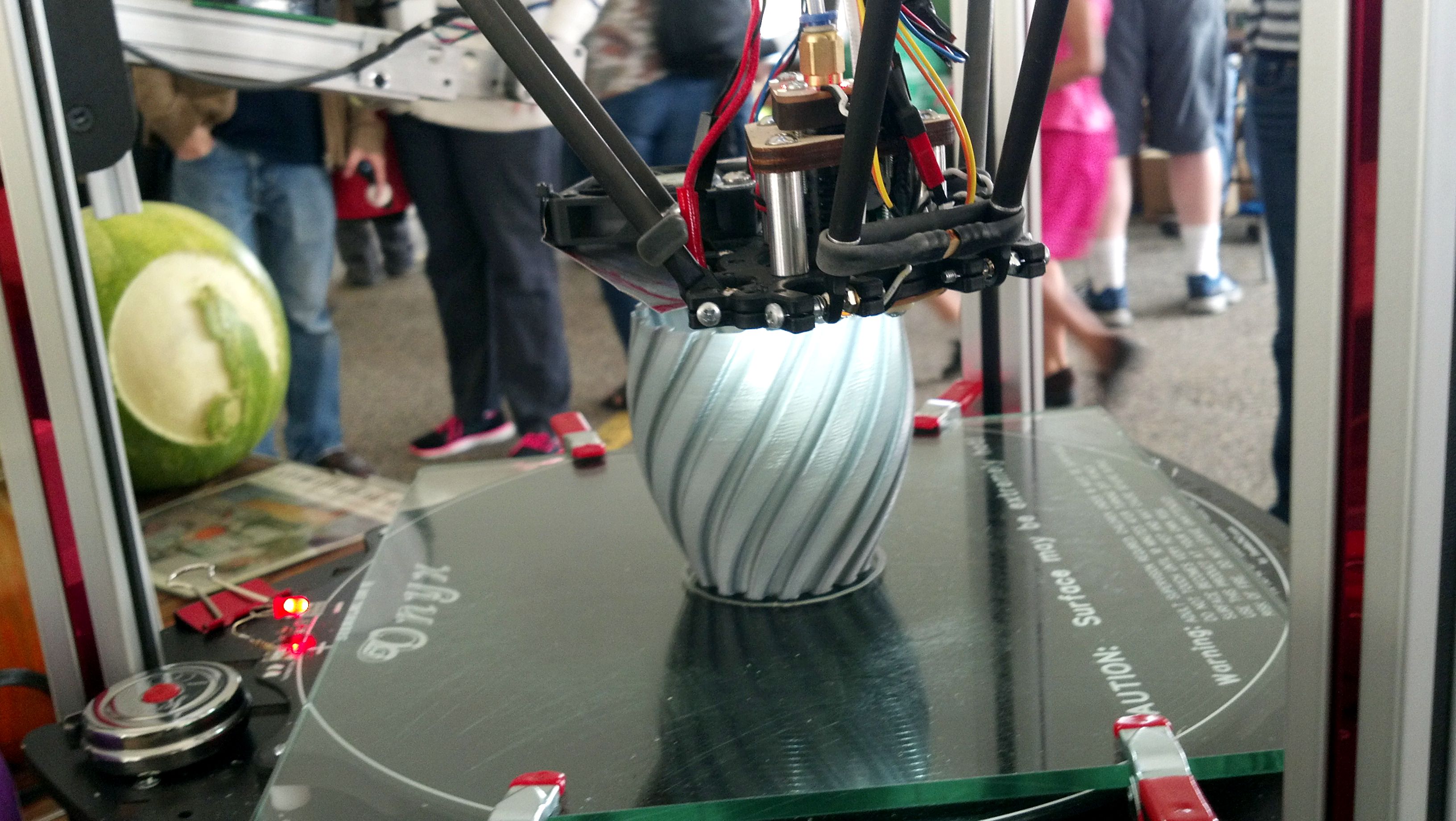

I was printing gear vases at Maker Faire Detroit this weekend. What a great event, tons of cool projects and ideas! At the Henry Ford Museum to, which is awesome.

If you have a room fan handy, aim it at the print bed (on low) and turn the speed up to "11".
You'll need to bump your extrusion temp up a bit to keep up with the higher speed. It goes like a scalded cat.
