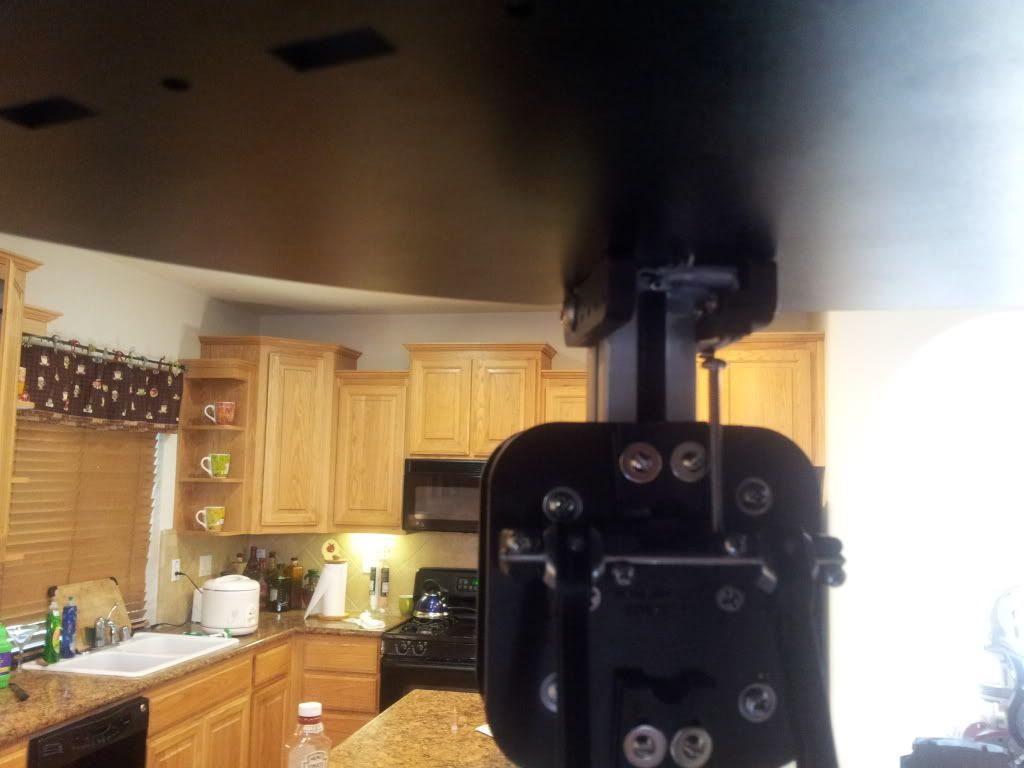

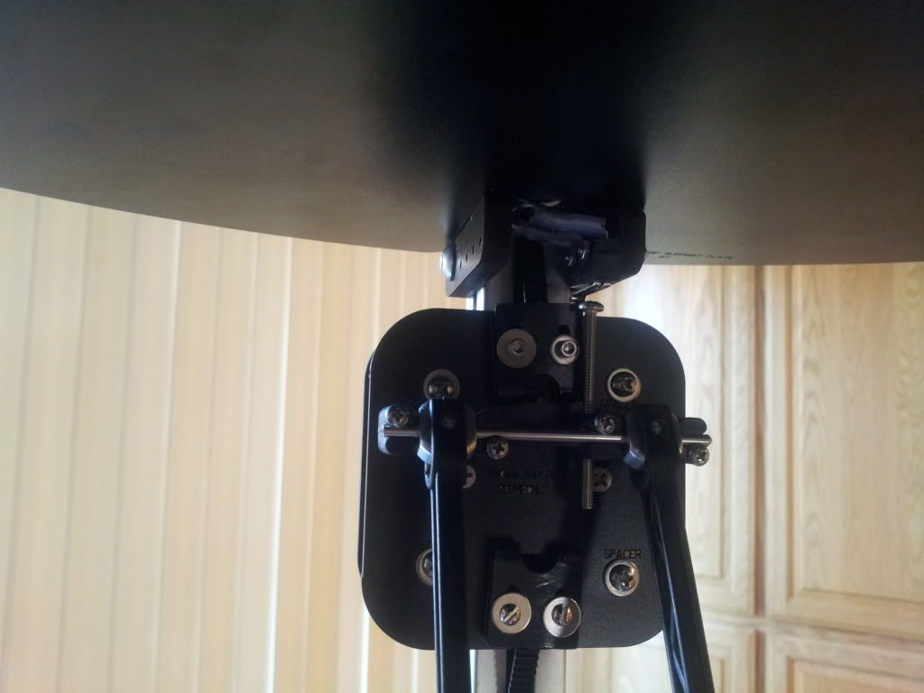

So I've been messing with the X axis screw stop to adjust the length, BUT i still have about 2.9 mm to go and I'm looking like this...
[img]http://i1326.photobucket.com/albums/u65 ... 7a1536.jpg[/img]
ANYONE have a solution to this???? The other 2 stopscrews look like this....
[img]http://i1326.photobucket.com/albums/u65 ... 5383db.jpg[/img]
Re: Calibrating, hitting the bed
I would say you have a mechanical issue, at the top the 3 carriages should be even when homed.
All the screws are for is to dial that in.
Think about it this way when all three travel downwards by the Z height the Hotend should be on the bed in the center.
Or possibly you have the Steps/mm mismatched between the firmware and the EEPROM.
What firmware, and what changes did you make and what vales are in the EEPROM for the steps/mm
