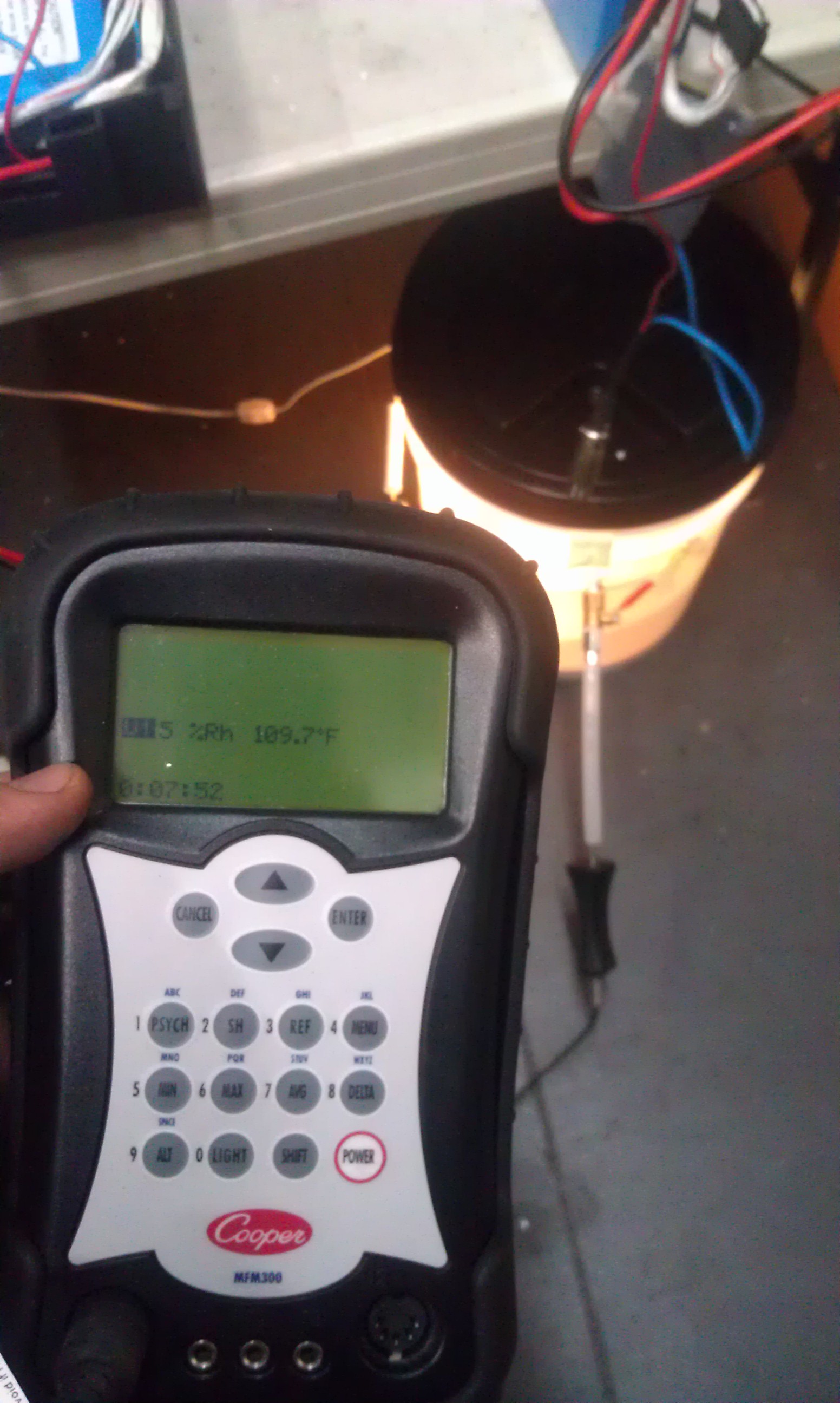

I looked at the low-humidity molecular sieve desiccant from McMaster, and I am confused on what it is and what to order. Is it a bulk powder or what and how did you figure outCleveralias wrote:Wow, cope, thank you very much for taking the time to make this comparison. It's something I've been wanting to check so I'm glad to see your results. I've been using a large amount of silica in a sealed bin but I've never been able to get the RH down below 30%, which seems to agree with your sample 1.
This seems a decent place to share that I finally ordered some low-humidity molecular sieve desiccant from McMaster this week. I threw it in my bin when it arrived Tuesday afternoon and by the time I got home from work yesterday the RH was already down to 19%. So it does seem to be much more effective in low humidity than silica (as it is billed to be). I'm still watching to see how low it can bring the bin over time, but I was encouraged by the early results. I'm hoping this will get things nice and dry and keep me from having to build something more involved, but we'll see.
It comes in Tyvek pouches so it's ready to use and you won't have to deal with bulk powder, and there's no color change. I ordered their #1523T63 (http://www.mcmaster.com/#1523T63). It's 5 bags, each good for 1,425ci, and I threw all 5 into my bin, which I think is 30 gallon... Since it seems to be working I'll probably order the next size up next time (1523T64) as that might be a better fit for the container.Eaglezsoar wrote:I looked at the low-humidity molecular sieve desiccant from McMaster, and I am confused on what it is and what to order. Is it a bulk powder or what and how did you figure outCleveralias wrote:Wow, cope, thank you very much for taking the time to make this comparison. It's something I've been wanting to check so I'm glad to see your results. I've been using a large amount of silica in a sealed bin but I've never been able to get the RH down below 30%, which seems to agree with your sample 1.
what to order? It sounds like great stuff but I need your help in determining what to order. Also, is this a color change desicant?
Not too bad...Eaglezsoar wrote:That's one expensive meter that you got there.
