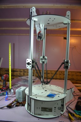

RamBo+LCD board done.
Re: Zerosink's Rostock MAX build.
Posted: Sat Aug 10, 2013 3:59 pm
by Zerosink
now to install the flux capacitor and get the 1.21 gigawatts of electricity needed.
Posted: Sat Aug 10, 2013 6:08 pm
by Zerosink
Well the "build" is done.... Now I might turn it on :)
Posted: Sat Aug 10, 2013 7:53 pm
by Zerosink
Power-UP
No magic smoke escaped.
Posted: Sat Aug 10, 2013 10:04 pm
by Zerosink
First Moves.
I have heat and x-y-z moves :)

While doing the PID config....
I set the extruder, then went to edit the bed pid and RH crashed.
Restarting RH, I can send g28 and also make manual moves.
When I click on firmware eeprom config, RH crashes
I reverted back to a new fresh copy of configuration.h
When I click on firmware eeprom config, RH crashes.
I uninstalled/reinstalled RH, no joy, same problem.
Could use some guidance on this problem ... please :)

Are my eeprom / firmware / config files corrupt?
In RH, after many crashes when I trire to opened firmware eeprom config
It let me in a few times.
I did manage to set the z height max. then did a M500.
I did G28 and the LCD showed the proper z max height. (first time in past 3 hours)
Then I saw this in RH
"Error:Binary cmd wrong checksum."
I got back into Firmware eeprom config. Here is the screen shot.
In green is the number I entered for "PID D-Gain"
But that line says "steps" ?
Posted: Sun Aug 11, 2013 5:17 pm
by geneb
I would write down the figures you changed and then set EEPROM_MODE to 0 in Configuration.h and reprogram the board. Power cycle it and then change EEPROM_MODE back to 1 and see if the EEPROM table corruption has been fixed.

Thanks geneb, I did what you said and all is well :)
