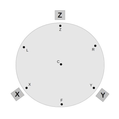

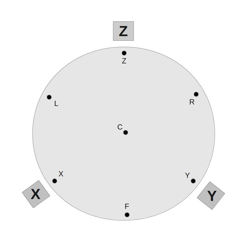

Since this thread seems to describe the same issue that I am experiencing (XYZ posts and Center are all level, effector raises at FLR - see attachment image or link), I'm going to jump in to the discussion. I've had this issue since my machine was first operational (purchased beginning of June), and have been getting amazing prints as long as I stay within a ~100mm diameter circle right around the center.
Originally I had a borosilicate glass build surface on top of the Onyx. It was domed even when cold by 0.5mm high in the center. I have recently made a huge overhaul and upgrade (which I had naively hoped would fix the problems) by going to xnaron's mag-arms and a 5/16" cast aluminum build plate that I verified to be flat to better than 0.001." My towers were recently re-squared with a 10"x18" machinist's blade square and the inter-tower distances set with a large caliper to within 0.002." The six carbon fiber arms are measured to have <0.2mm variance with the chrome balls in place.
Right now I've got a dial indicator in my effector. As I said, just like the OP, I can get XYZ and C exactly level. Move to F, L, or R and I'm 0.01-0.018" high (points F & R are 0.018" high and L is 0.01" high...I haven't been able to explain the difference or clearly identify the source).
The only irregularity that I have found is between the Y and Z towers. Starting around half-way up the distance begins to increase to the point that it is 0.012" wider at the top than at the base. To me this suggests a slight twist in the Y tower, but the XY distance matches top and bottom exactly (and is identical to the XZ distances). All towers are square to the aluminum plate, up the 18" side of the square, to better than 0.001" (that is the thinnest feeler gauge that I have and I can't insert it at any place along the square).
At this point I am completely at a loss for ideas. I've tried EEPROM on. EEPROM is currently disabled. I've tried Marlin-Delta. I'm back on Repetier. Since it's now so easy I've swapped around the positions of the mag-arms to no effect. I've measured and mic'd every thing I can and just don't get it.
Do I understand that most of you get XYZ & C level and it's all gumdrops and rainbows at points FLR?
Sorry if this sounded like a mini-rant. I'm frustrated and really interested in getting this fixed.
Any thoughts?

After going through the Delta forums at RepRap.org I found some insightful comments for calibrating the delta platform with regards to the auto-leveling routine.
After a short bit of adjusting the tower positions (I had to move the X and Z towers toward the center by something like 1-1.5mm) I managed to get the FLR error to be consistent. Still high, but equal at all three points. More than a couple hours later of slowly adjusting the DELTA_DIAGONAL_ROD and PRINTER_RADIUS parameters I now can sweep the bed to better than 0.008" (~0.2mm). A huge improvement, but it still seems like quite a bit of variation compared to what I am reading around here.
I've yet to print with these settings, but I'm worried that since both of the aforementioned parameters are so much higher than the actual values (several millimeters over measured) my scaling will be wrong.
We'll see...
