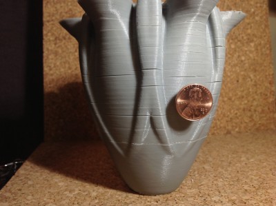

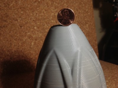

So this print failed at about 90%, it decided to detach itself from the bed and make spaghetti with the last 10%. I'll likely reprint the top and just abs juice it together.
Ah yes, back to the original question. The print went great for quite a few layers.
Bottoms Up
Bottoms Up
Then it tried to make like a banana.
It cracked up too
It cracked up too

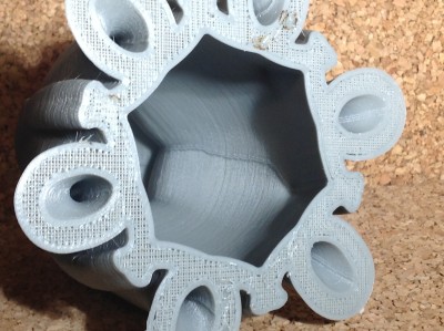

Deep down though, it was beautiful on the inside...The bastard.
The inner-self
The inner-self
So I assume the problem is cooling related and would be resolved with making an enclosure of some sort. Can anyone tell me if that is a correct line of though or is there something else causing this split personality in my print?

I'm thinking you are running your extrusion temp too low for the speed your printing or just not high enough for good inter layer adhesion. Bump up your temp 5c.
Re: Does this means I NEED an enclosure?
Posted: Mon Aug 19, 2013 11:46 pm
by Polygonhell
It's fairly typical for ABS to delaminate like that. Your options are print hotter, though you're limited in how hot with the stock Hotend, or reduce the density of the infill and loops. Basically the denser the layers the greater the warping forces.
The easiest solution is just to print it in PLA.
FWIW I'm currently printing ABS at 250, and it pretty much resolves the delamination issue, but don't do that with the stock Hotend.

I'm printing at 235ºC on an E3D hotend so I can go higher. I guess I need to go through and do a temperature calibration print.
It makes me curious though, is the inside not delaminating like that because it doesn't have any material to block/resist it's shrinking? Then I also think it is odd the base didn't delaminate for many layers even though it was relatively more solid (having a higher % of it's layer be solid loops than infill), so I'd think* those bottom layers would have more force to delaminate than the higher layers with higher amounts of the less dense infill. I guess that must be the hot bed doing it's job though.

I think the base isn't as prone to delamination due to it's proximity to the build plate. Double checking those photo's you are going fairly dense on the infill without any doubt. could easily get away with 1/3 that amount IMO.
But I certainly feel your pain, I have a number of really nice prints that were aborted after many many hours to my great disappointment.
I have saved one or two that had very very slight delamination through vapor polishing, but not as bad as your level of seperation can be saved like that.
