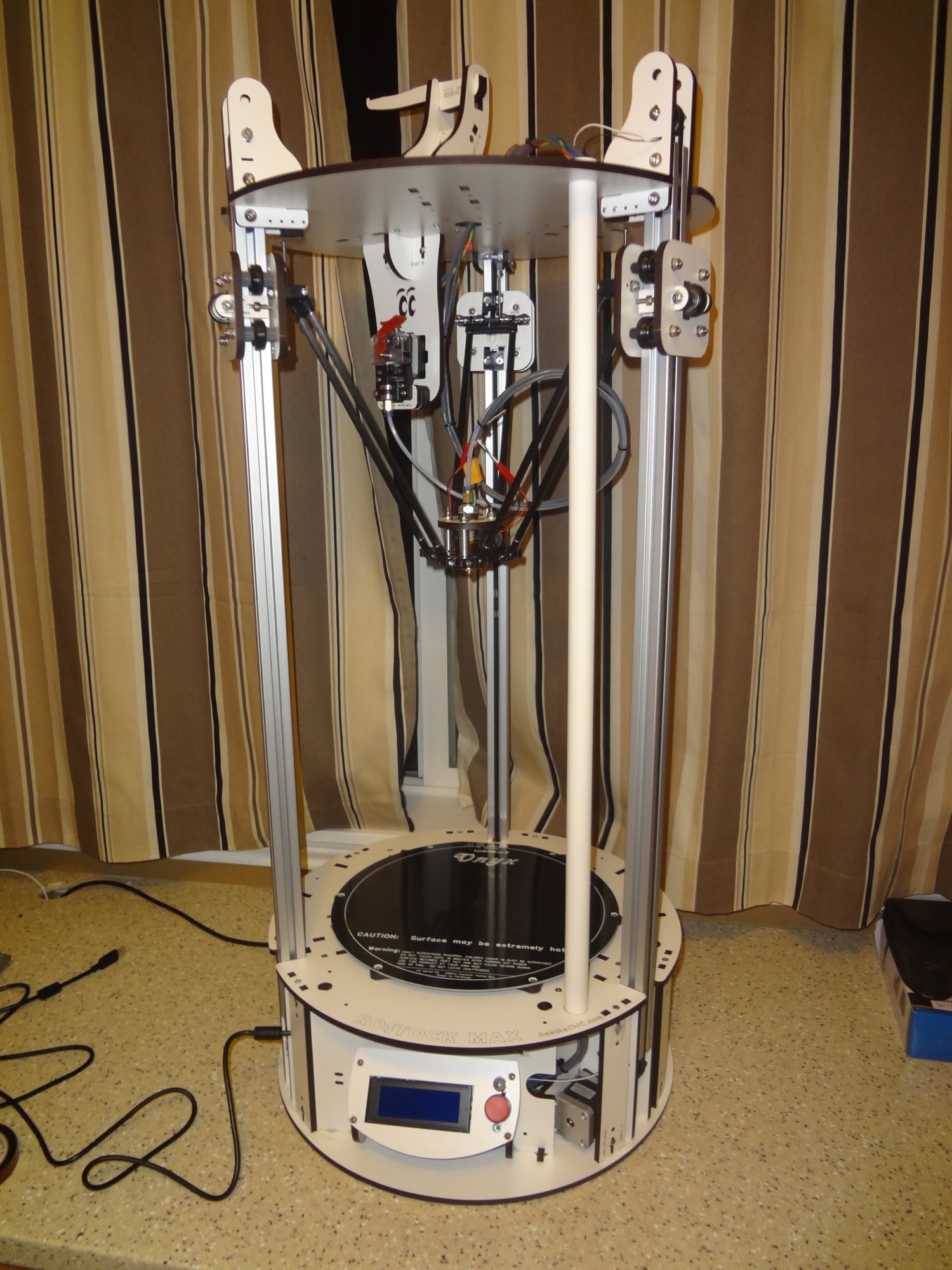

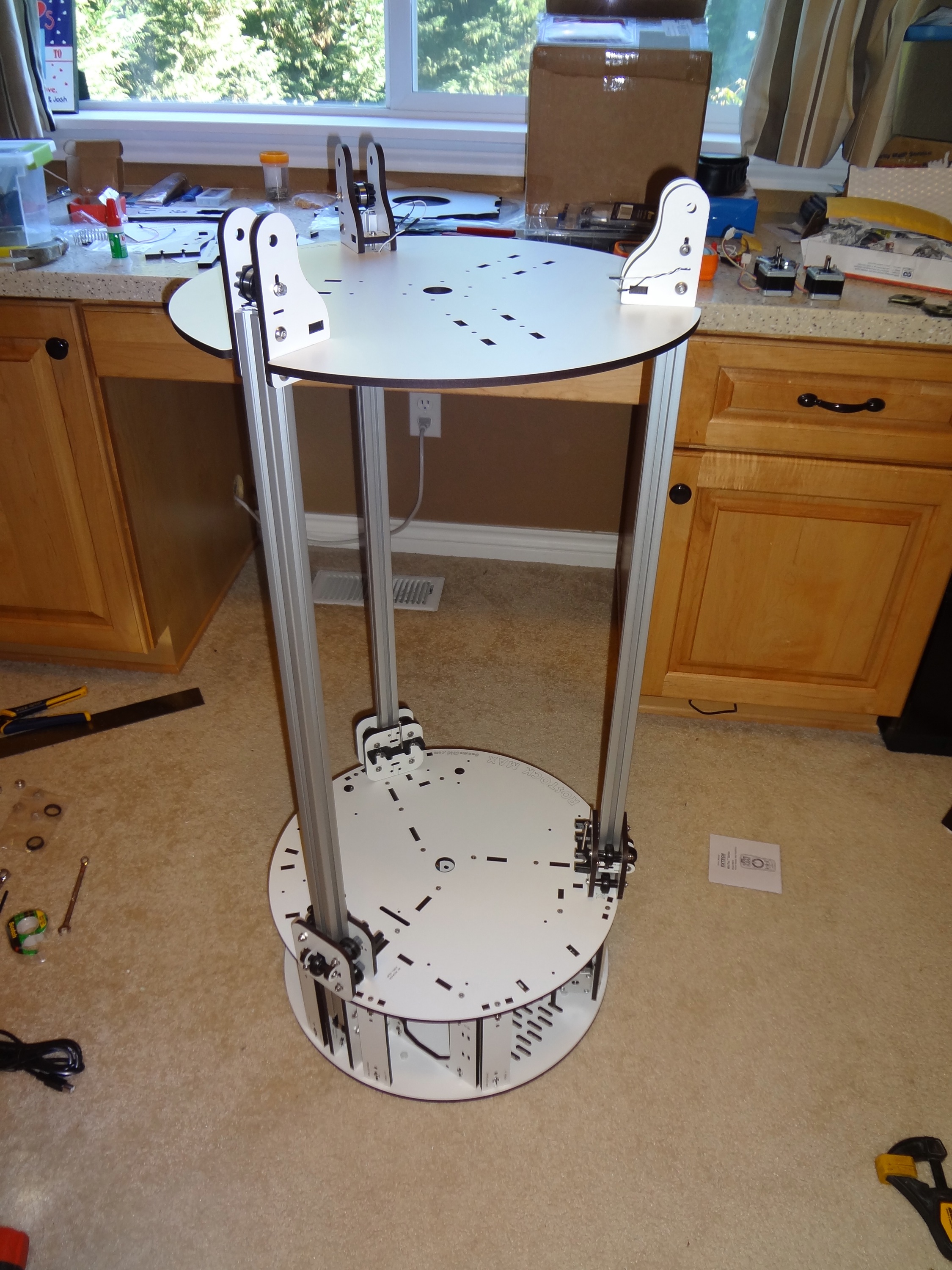

Well, after some on-and-off building over the long weekend, I got everything put together and wired up. Here's a picture of the finished product:
- Dean' Rostock MAX - Finished!

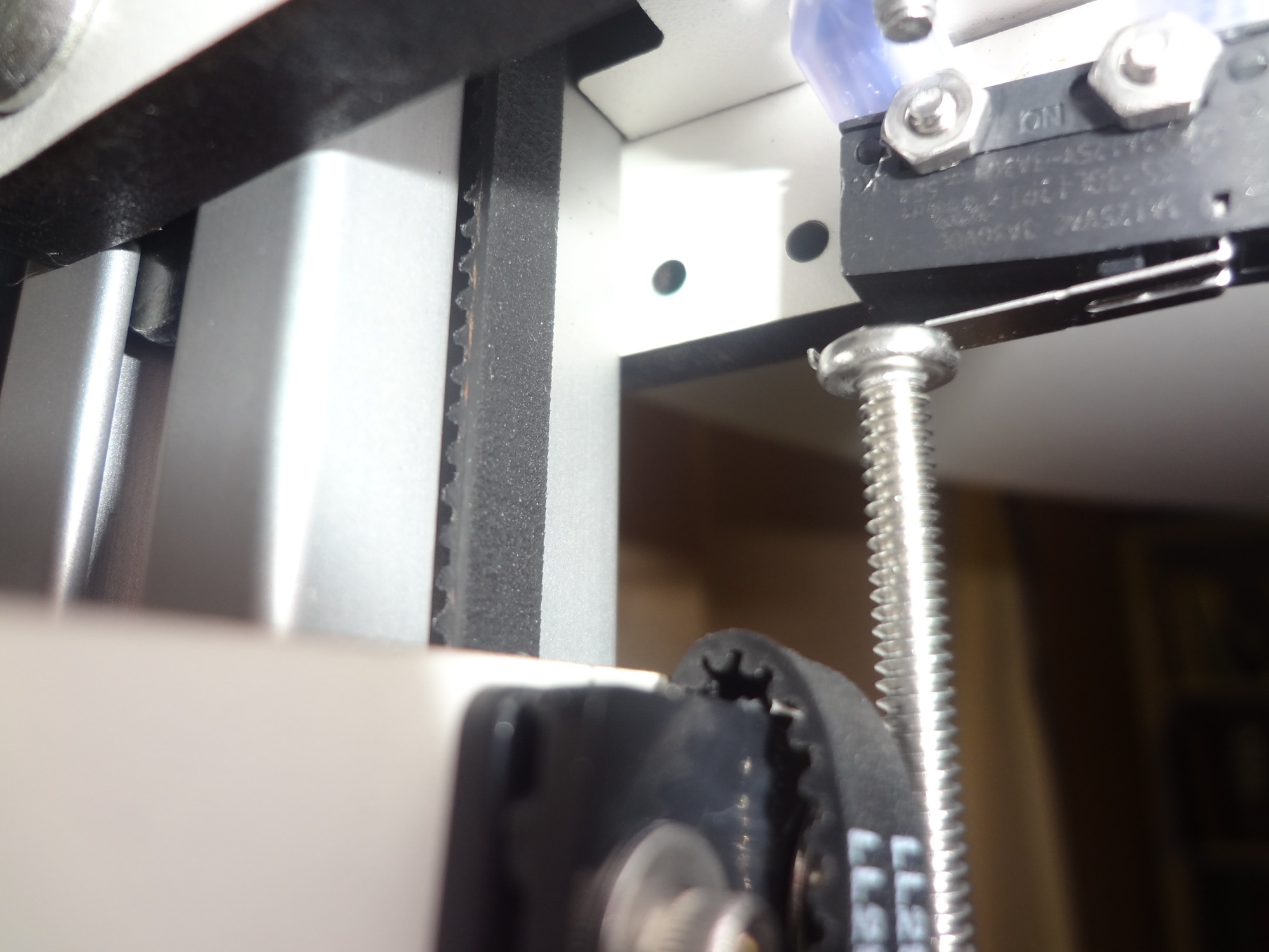

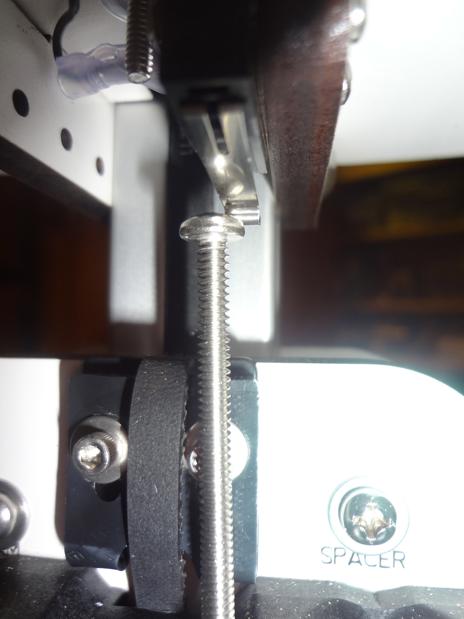

Once I figured that out, I issued a G28 and the print head drove all the way to the bottom -- I panic'd! Wasn't sure what to do! So I manually hit each of the limit switches by hand as the thing was jittering in one of the corners. Of course, you have to hit each of them "twice" because of the bounce mechanism. In hindsight, I should have thrown the power switch
Anyway, after that, I inverted all of the axis in the firmware and re-uploaded. Then I was able to get G28 to work and move the carriage around -- fun!
