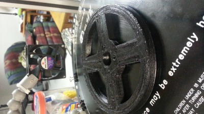

Trying to print a pulley, it started to pop loose about 3/4 through, severe ABS curl. Lesson learned: When something is symetrical, probably better to print it as halves and assemble later ;) Rookie mistake :oops:

Print with UHU glue stick covered glass at around 90-100c for ABS with a skirt of 5-15mm and your all set and no more curl.
Also, you have way too much plastic being extruded and looks like 100% infill, both of these will also doom you to curl city.
WAY too much plastic being printed there. Have you calibrated your extruder?

I would probably also caution the use of the giant fan in the background. That massive airflow is causing uneven cooling which is going to introduce all sorts of internal stresses, inducing warp.
Consider a localized fan (duct) on your effector, and leave it turned off for the first several layers so as not to cause early shrinkage.

I also feel the use of a aluminium heat spreader/evener plate under the glass helps in many ways. Another really essential upgrade IMO.
