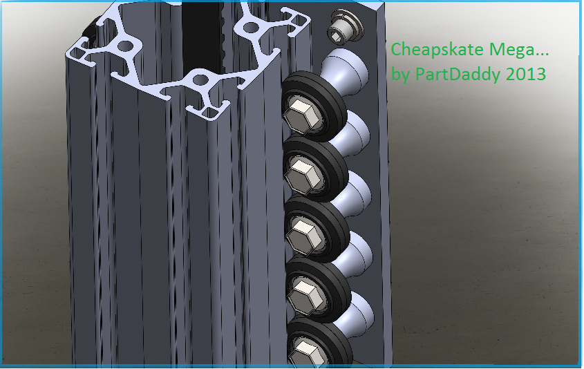

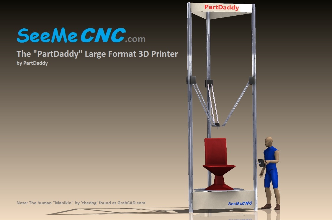

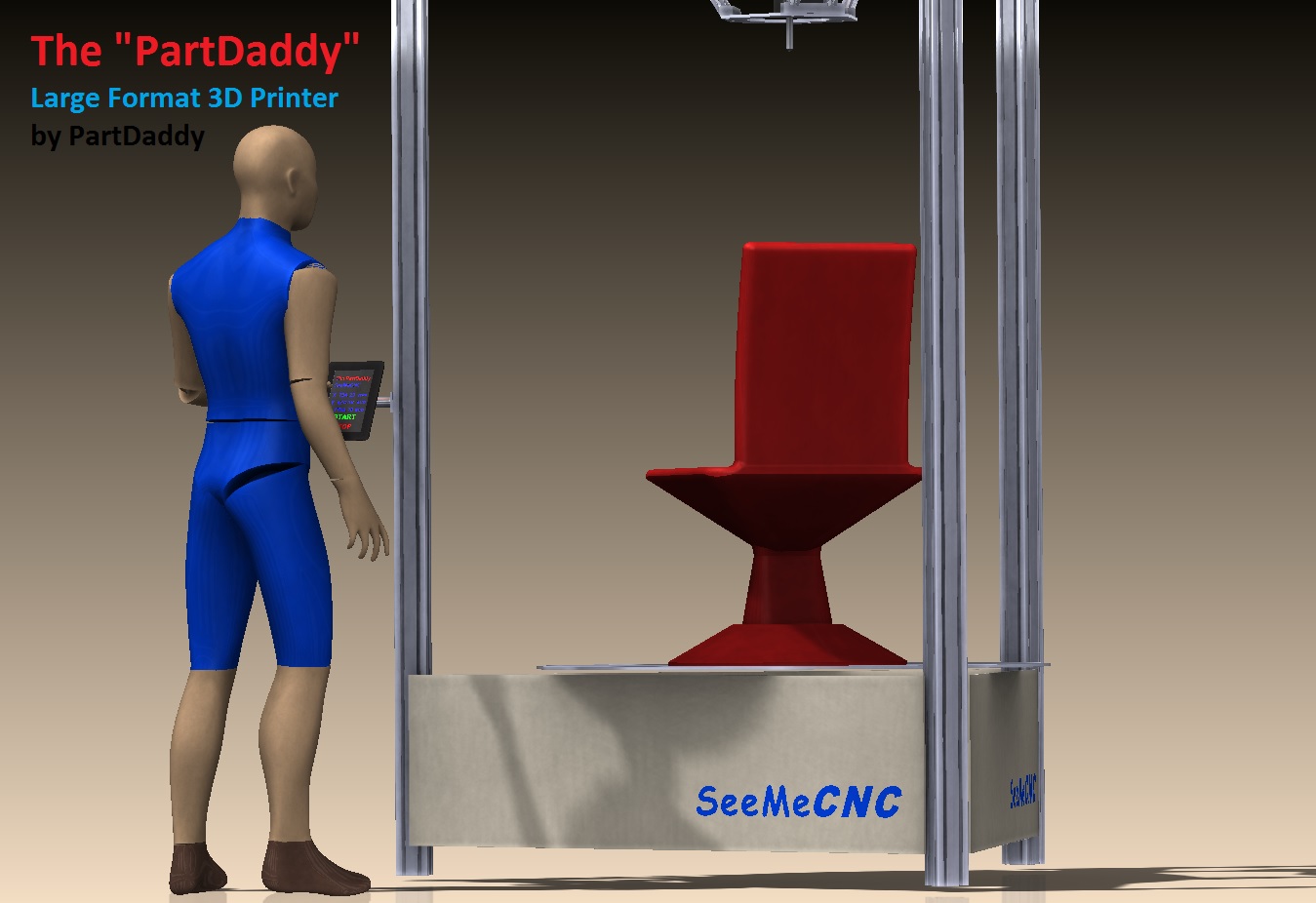

The "PartDaddy" is a large format delta 3D printer. The manikin in the picture is 5'-9" tall.
The build table is 1.2m (about 48") in diameter and build height 3 meters (or almost 10 feet)! The printer will use plastic pellets instead of filament. Plastic pellets will be transferred to the extruder using compressed air or vacuum. The extruder mounts directly to the platform and will be a custom designed. The general construction is similar to the standard size t-slot design I created for the Rostock MAX. However, many parts for this beast will be CNC machined aluminum.
The 5 meter tall linear t-slot rails have my Cheapskate design. The bearings will have plastic sleeves, and on one side ride on the eccentric cams. The carriage roller bearings have a spring tensioners that will allow for an even force to be applied between the bearing (with sleeve) and t-slot rail. The reason I use a standard size t-slot aluminum extrusion is to allow lower cost and world wide availability. This makes it easier for someone wanting to source and build their own machine no matter where they are in the world.
While the larger vertical three inch square aluminum t-slot rails are for rigidity and the linear motion, the one inch square t-slot rails make the structure of the six arms. The t-slot for arms provide a very good weight and rigidity combination.
I look forward to comments and suggestions about this super-sized 3D printer! I look forward to making one in the near future...

Re: The "PartDaddy" Large Format 3D Printer
A reliable, controllable, pellet-fed extruder sounds like the biggest technical challenge in your grand plan. And the most interesting to the hobbyist, since that could hopefully be adapted to smaller printers.

We should start rating printers in "hours to print the full build volume"... This one might be rated in weeks
Print time would be very sinilar to it's smaller size. Say two hours for a normal small one or 2 hours for a gigantic model.
My initial thoughts:
- the huge bed reminds me of the speed issue at the edges pointed out by Bill Havins here.
- replacing the belts or even fussing with the tension/leveling upper idlers (would you lay it down to do that?)
- I thought huge ABS prints suffered from cracking. Would this be PLA or some other material?
- You'll have to rename the rostockMax to rostockAverage

You guys crack me up.
Some more details (for any of you already started on one of these in your really tall 'man cave') I plan to take the step direction from the RAMBo and route it to an amp for NEMA 23 or 34 size stepper motors. I'm fairly certain I'll use timing belt, but you get backlash in belts this long. Maybe chain, steel counter balance inside of 3 inch t-slot.
The universal joints need to be a bit more heavy duty for something like this, so ball bearings here. There will be a quite a few machined parts on this thing.
Why not use ball screws on something that big, then you could get pretty good speed without backlash or skipping teeth.
An automotive timing belt has zero stretch of give. you can get them stupidly long as well and like the one in my car it is a stainless and kevlar backed belt. If it can handle up to 14,000RPM in my motor I think moving a carriage around should be no problems.PartDaddy wrote:You guys crack me up.
Chain is bad, higher friction than belt, shorter life due to wear and slop etc. Noisey. Need oiling, something we don't need near a printer.
Don't use timing belts until you've tried fishing line. Belts introduce more parasitic inertia and they cost EXPONENTIALLY more. 100 yards of fishing line is $16 on Amazon, and it will hold 200 pounds. 100 yards of GT2 is... yikes. Don't even want to think about it. Four figures?
If you build it with fishing line, you can leverage the increased strength and lower inertia to run at higher print speeds. I'm assuming someone doesn't want to wait a day and a half for their chair to print! There's also the small furnace you will have to build into the print head. That will add inertia, maybe a lot of it, so the easiest solution is to take inertia out of the system any way you can. I would brace up the structure as well as possible to let it run at Ludicrous Speed. Put in provisions so it can be bolted down very securely.
It will need a minimum of two extruders so that it can print water-soluble support material. I don't think someone who needs a printer this big is interested in spending an hour and a half ripping off a bunch of sprues and deburring and all that stuff. Likewise, some complex objects are not practical to print without dedicated support material.
Since you have to design a small furnace into the print head for melting the pellets, I would engineer the system to allow addition of an ink/dye injection system later on. Some of your potential customers will have a strong business interest in being able to color print large objects. Aside from Shapeways I don't know that there is much competition in this area, and I don't know that they even have large format sandstone printing. The closest I've seen is a hot end that takes multiple filament inputs and stirs them inside the extruder, but that was a few years ago.
Also, have you thought about doing a regular Cartesian robot to mimic Shapeways' sandstone printers? I'm assuming they are just bins with XY carriages and sand spreaders. They're probably using something similar to inkjet print heads to do the color. It's tricky enough to get a regular Rostock aligned, and I don't know how well it would scale to that kind of build envelope, but factoring out the Z axis into a separate problem could make things easier to keep in spec. It would also mean the printer doesn't have to be twice as tall as its envelope. (For a desktop version there's little reason to care, but at 6 meters overall height, all the creative departments who might otherwise be interested will be unable to find a place to put it. Unless their office is in a hangar.)
The printer should ship with pieces designed to make alignment and calibration easy. I spent many hours trying to align my printer just so. Then I figured out that if I designed some tower clamps and braced them together with threaded rod and wing nuts, it got a lot easier! Whatever stuff you figure out ahead of time is work your customers don't have to duplicate, and that converts directly into word-of-mouth and more sales. Make them say, "Wow, this is clever! They did this for me so that I could get up and running faster, even though they didn't have to." Years ago when I was a phone jockey they told us that people will tell 20 others about a bad experience with a company, but only 3 about a good one. Whatever you can do to push that into a 4 or a 5 is money in the bank. (For the record, I don't mind figuring this stuff out myself because it's an open source project, but most of your target demographic is not shade tree mechanics like here on the forum.)
Include Astrosyn or similar stepper dampers, and an enclosure should be an option. The dampers are probably the best single mod you can do on a Rostock, especially if you sit near it and want to be able to hear in your old age.
