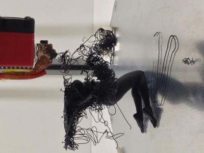

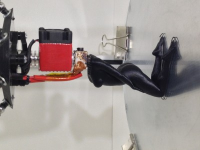

I'm sorry I was far to busy staring at your avatar to hear a word you said.
Haha of course you can't hear me. I tried printing this lady on the 6th
			-  Getting excited...
			-  What a tease she was.... : ( I think I need a glue stick this time.

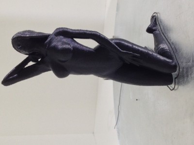

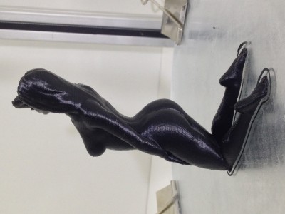

				Got it. : )
			-  Front
			-  Back
Does anyone know how to get rid of all the little bumps when it starts the layers. I use kiss and not 100% sure with how the settings affect my prints.
