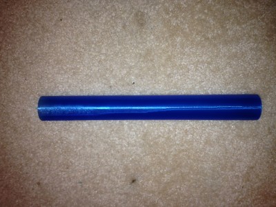

Printed darn near perfectly. One little layer misalignment - might not even be visible in the pics. I may have been printing a bit too quickly...
Now I have a 25cm track and field baton? A 250mm sleeve for loose quarters?

I'm in the process of printing the cylinder because I was curious how my machine is performing. I had already done the single-wall 20x20x10mm cubes and those came out fairly nicely: Wall thickness pretty close to 0.55 (0.56, 0.57) which is what I setup in Slic3r, dimensions reasonable (the height is actually 10.25 or so -- any thoughts on that?).
I don't have the hot-off-the-presses version of Slic3r, so it didn't have the "spiral vase" setting. But I figured I'd print the cylinder anyway. The interesting thing is that where the "seam" in the cylinder is, I would have expected a perfectly vertical line. But it's not :-( It started twisting a bit (clockwise) after about 110mm. Now, maybe this is part of the problem, but I did set the speed multiplier to 500% via the LCD :-) But that still should only be 150mm/s since I have 30mm/s set as the speeds in Slic3r. Has anyone tried something similar?
Also, on a separate issue, I just noticed that the "top" is starting to look poor (on the same side as the seem). Current height is about 210 mm and the last 15mm or so have gotten worse, with a hole appearing in one spot. I'll post some pictures once it's done.

I have a feeling that 150mm is pretty fast for this print. I printed mine at 90mm/s. I likely could have gone up to 100, maybe 120, but after that, I think I would have had layer cooling issues.
As for the "seam". Mine is straight, but it has 3 distinct segments. Not sure why it shifted slightly every 7-8cm, but I'm guessing it has to do with the slicer spiral vase code.
Did you choose, "randomize starting points"? What's your retraction set at?

cope413 wrote:I have a feeling that 150mm is pretty fast for this print. I printed mine at 90mm/s. I likely could have gone up to 100, maybe 120, but after that, I think I would have had layer cooling issues.
Yeah, I think 150mm was too fast. Right near the end (last 20 layers or so), I slowed it back down to 60mm/s and the problems went away. So I think, like you said, that the speed was too high as I got too far from the bed.
cope413 wrote:As for the "seam". Mine is straight, but it has 3 distinct segments. Not sure why it shifted slightly every 7-8cm, but I'm guessing it has to do with the slicer spiral vase code.
I don't know how well it's visible in this iPhone photo, but you can kind of see the seem going up and to the left. Now that it's off the print bed I realize that it started shifting sooner than I thought. In fact, I think the shifts started right after I had increased the print speed via the LCD. One other thing I think *may* contribute to the problem is that I have my cables from the print-head and fan zip-tied to the bowden tube. My printer is behind me and occasionally I heard a funny sound. But I turned around and didn't notice anything -- except once when I saw that one of the zip-ties was clicking against the mount where the extrude is. I'm wondering if the cables bumping against things are causing shifts of some sort.

cope413 wrote:Did you choose, "randomize starting points"? What's your retraction set at?
No randomization. Retraction was set at 5mm with 60mm/s speed. Z-lift is 0.2 and Retract on layer change was checked.

I don't use Slic3r anymore but I'd guess that blobbing is the print head oozing either at the start or finish of drawing. Try switching to KISSlicer. There is a forum here just for that slicer and in that forum is a thread where you can download the ideal settings. You will get better retract performance. Slic3r doesn't have as many "tricks" as KISSlicer to avoid blobs and strings.
My prints were failing previously because the TL arms were just a hair different in length from the originals. I went through a few test prints to see what would happen if I altered the printer radius, and once I figured out the right way to go my problems went away. If PRINTER_RADIUS is off you will get lensing effects, i.e. the carriage will not be able to move in the XY plane without deviating up or down as it moves away from the center. The effect is tiny and doesn't show up in small prints, but it is multiplicative and after enough layers your print will turn into spaghetti.
