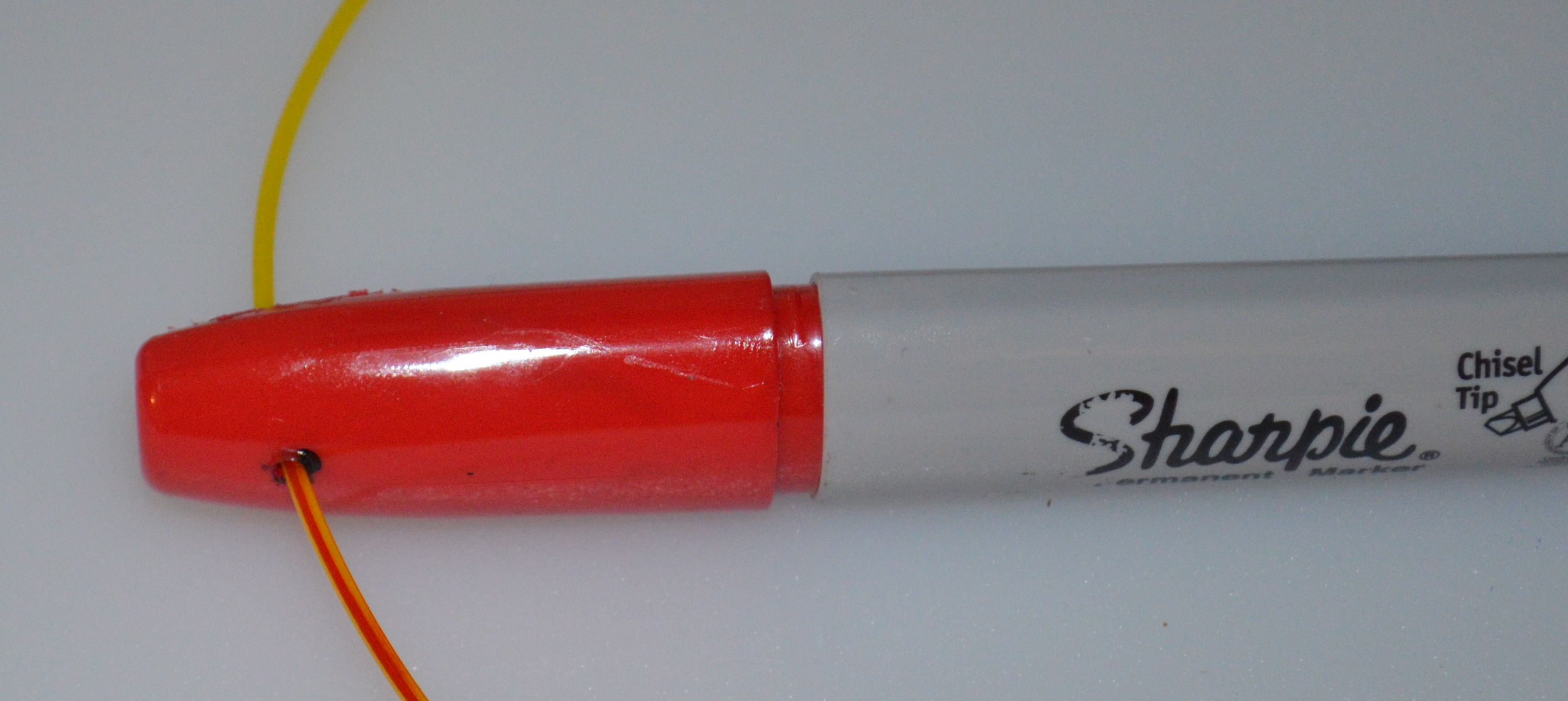

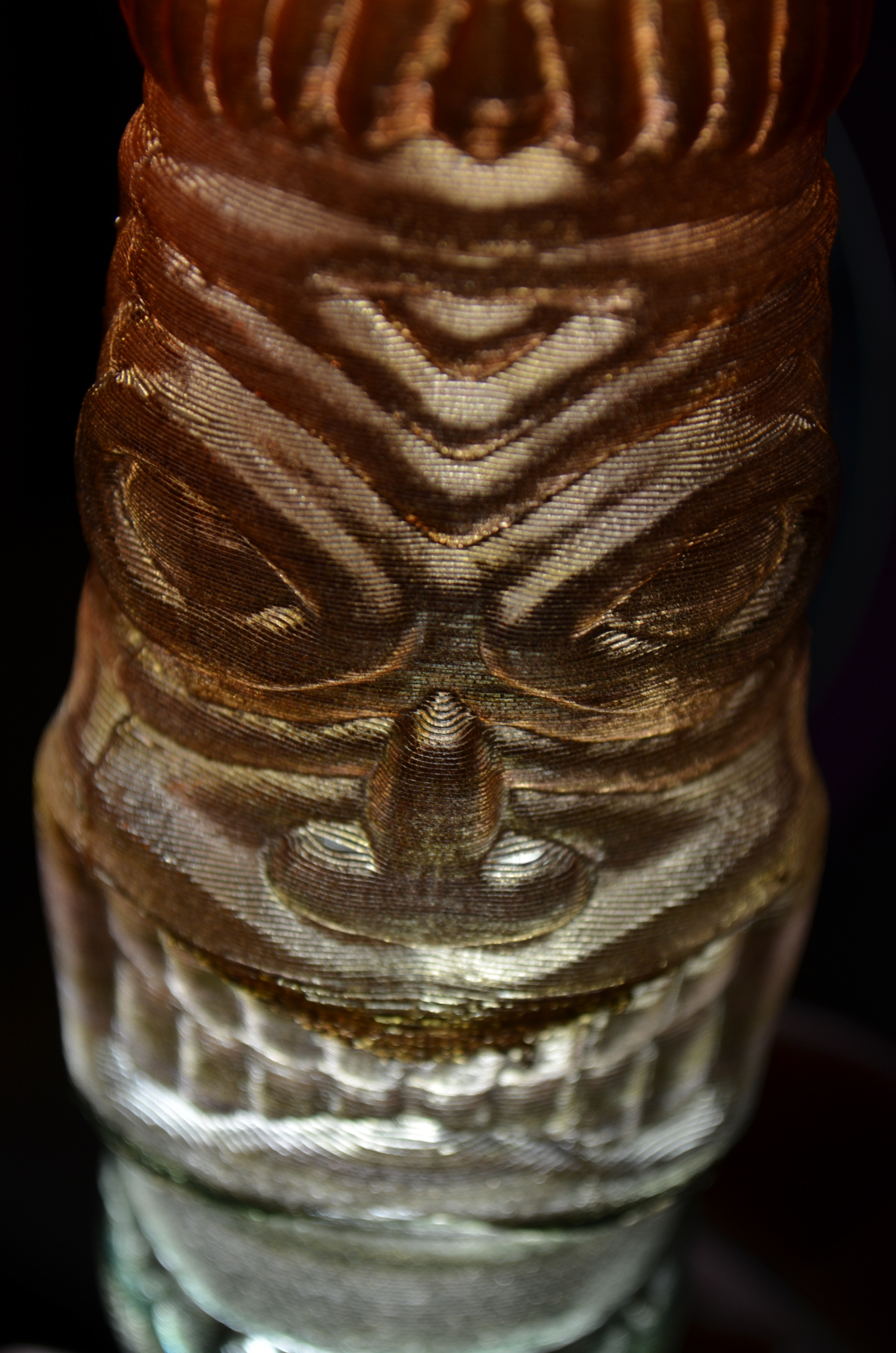

Ummm... I use a Sharpie
If you mark only 1 side of the filament it gives a really good optical effect as you tilt it up/down.
Diff effects depending on what side you mark. Colors may change when you print, red sharpie makes a good Gold
You can see the color through the clear part of each layer.
I can "see" through the tikiman... but can't make the picture show it.

OK... I just couldn't splain how good this colored t-glass looks
This is how I sharpie-colored the Tiki man t-glass.
In the photo I used PLA for its contrast. You can see it is a small thin stripe.
That lil thin red stripe made the gold color on the tiki man.
Now the results, a tilt-test
https://vimeo.com/74679404

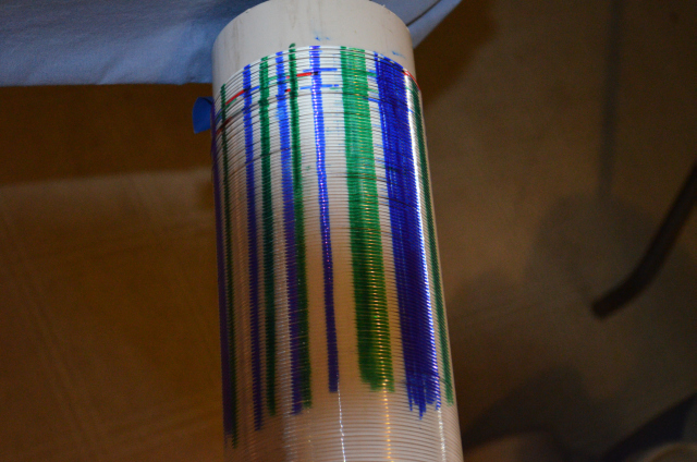

To color the wine bottle in the video,
I wrapped the clear t-glass around a 4inch pvc pipe and colored it.
The print .. well the green didn't show that well, but anyway
I don't think I would do it this way again.
