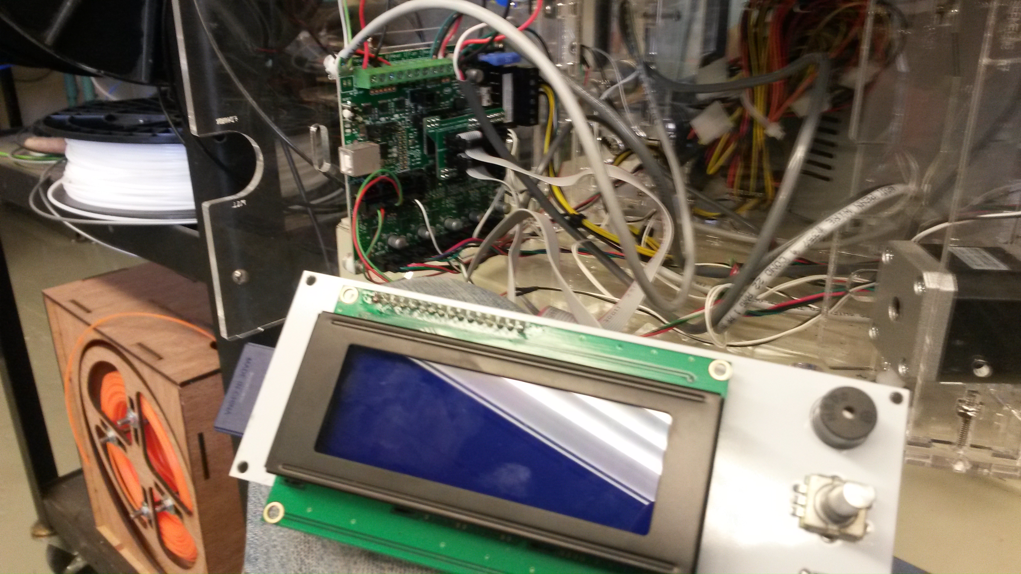

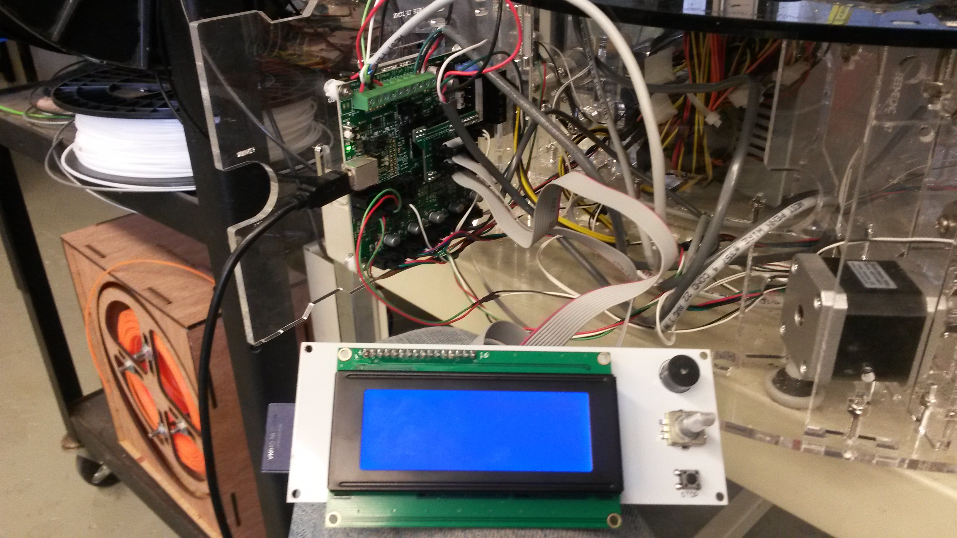

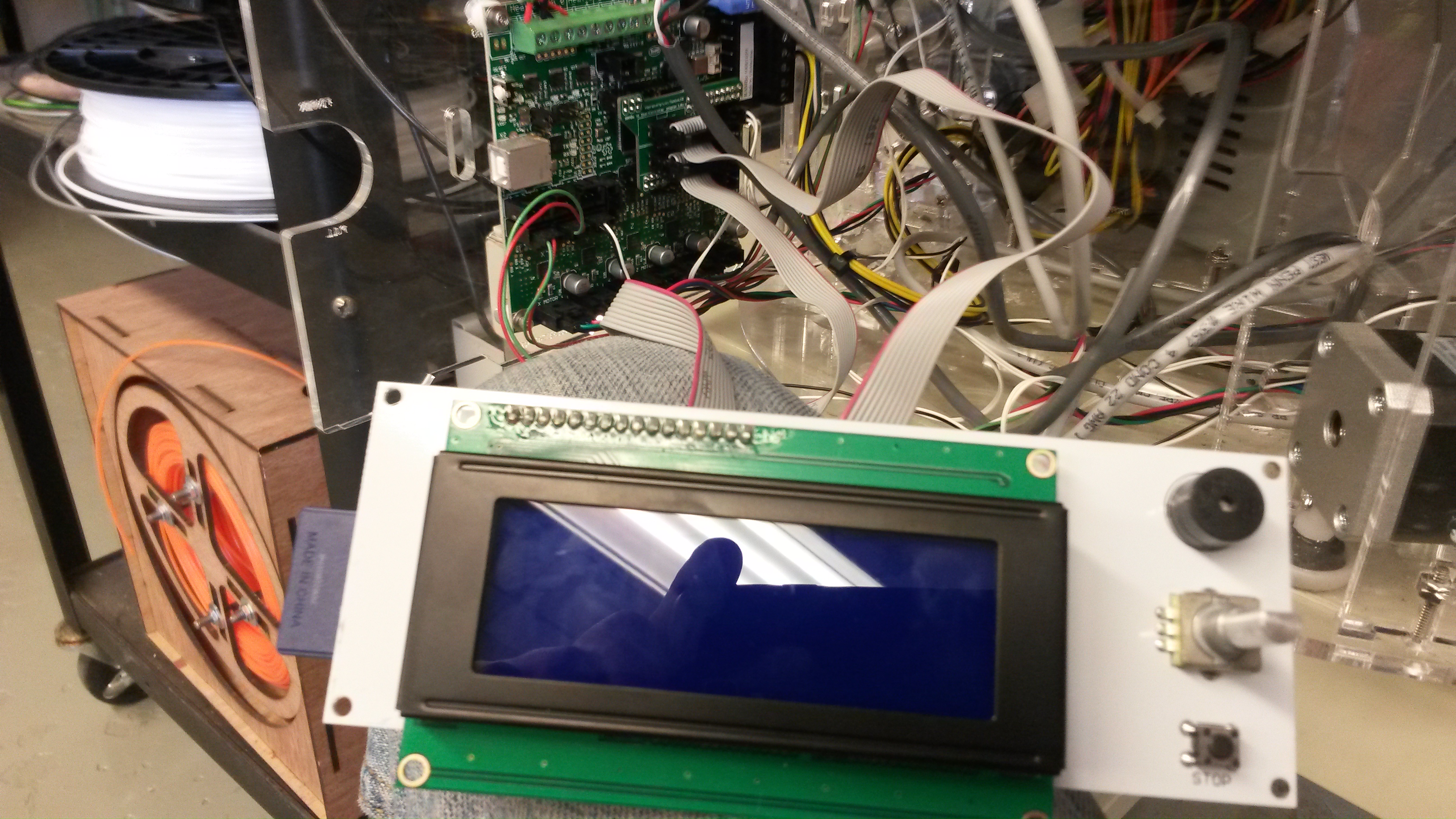

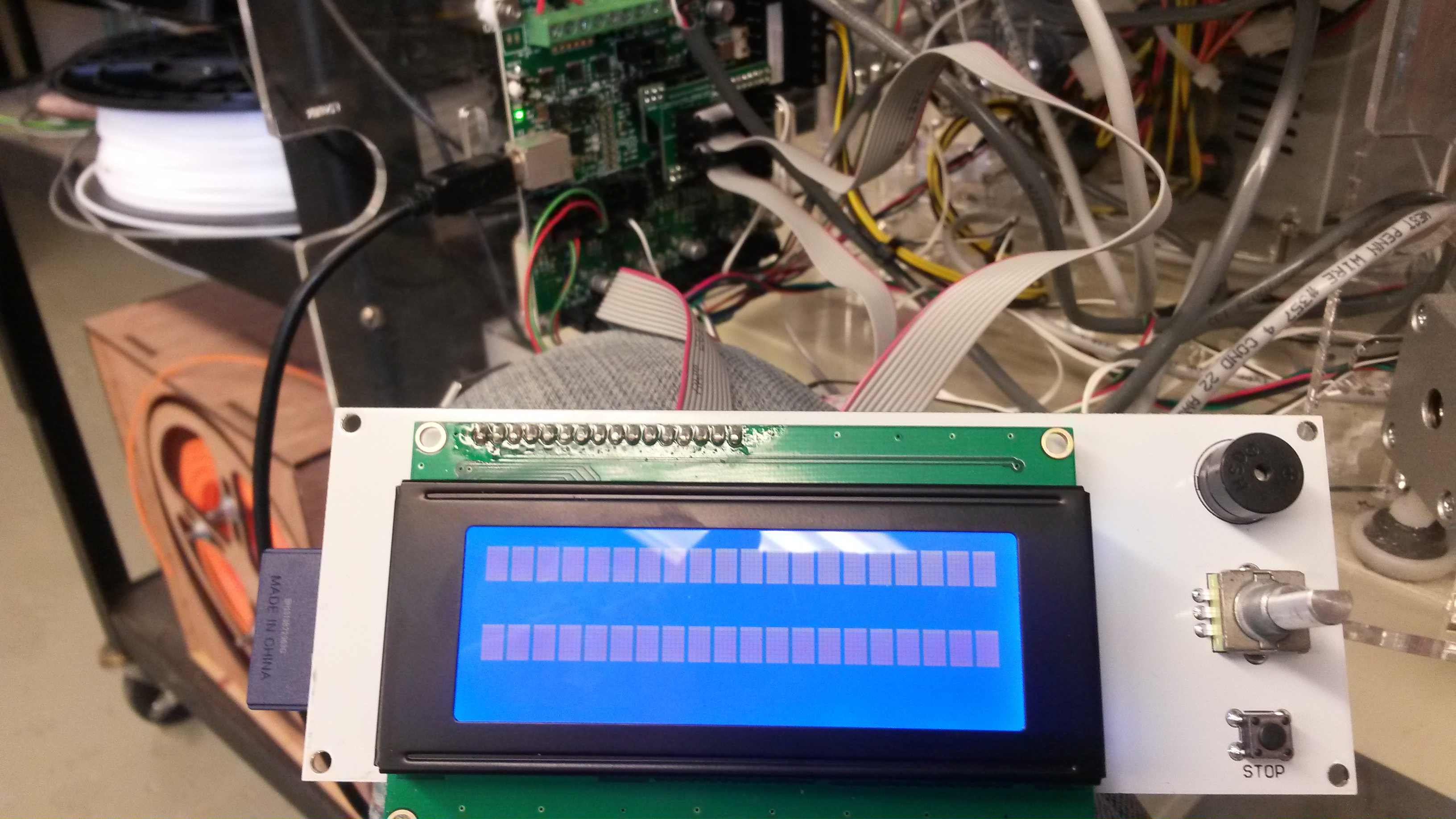

Alright well here's what I'm dealing with. I just flashed the Rambo with Marlin to see if it would make any difference and checked the pinout file to ensure they are correctly associated with the pins in the install guide, which they are. I have tried swapping the cables (TypeA/TypeB in the photos) however they make no difference in the display without USB connected as well and they go from the contrasted blocks to blank screen with the USB connected. Thoughts? I'm hoping to get this printing from the SD to hopefully avoid connection issues and host issues.
Connection TypeB w/ USB connected
Connection TypeA w/ USB connected
Connection TypeB
Connection TypeB
Connection TypeA
Connection TypeA

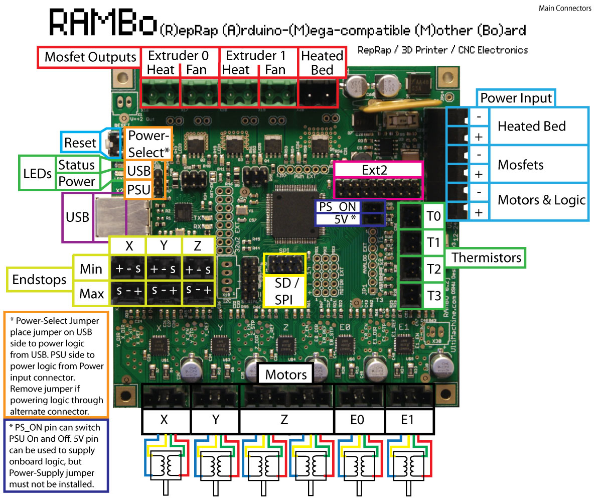

Not sure it has any bearing or will help, but I had the "Connection TypeA w/ USB connected" screen until I switched the LCD from powered by USB to-powered by PSU with the little jumper on the Rambo. Located above the USB connection on the board. My LCD works, but I don't print from it. Good luck :)
MSURunner
Posts: 200
Joined: Thu Jan 03, 2013 1:28 pm
Re: LCD Panel
Post by MSURunner »
That may be my problem because it somehow just started displaying characters after I reflashed it with Repetier FM and have the USB connected. So you jumpered from the 5v auxiliary above the reset, correct? and then to where did you go? and did you have a FM prompt to change?
Batteau62
Posts: 389
Location: Connecticut
Re: LCD Panel
Post by Batteau62 »
I just switched the power select jumper near the reset(see diagram) from USB to PSU, rebooted, and it worked. Nothing else. I do use Repetier FM. There were some posts on this very early on in the forum, if you can mine them out :roll:
MSURunner
Posts: 200
Re: LCD Panel
Post by MSURunner »
Ahhhhhhh, PERFECT! Thank you very much!
