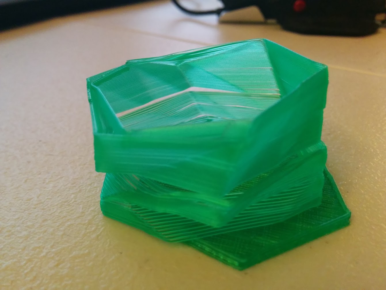

I see some of you have been having a bit of luck with the Taulman T-glase and had a few questions. I started playing with a roll of the 1.75mm t-glase about 2 days ago and have had minor success. My first trouble had to do with very inconsistent filament diameter, which taulman is making right by sending me a whole new spool (in some areas the filament couldn't even fit through my bowden tubing), however, I've found a few good stretches of filament in the spool and have been running through some prints, but I keep clogging/jamming my hotend and I can't figure out why. I'm running my hotend around 218-220 which seems to be extruding well. I set my retraction below my abs level of 4.5mm which worked great for abs, but I feared was too high with the lower melting temp of t-glase. I set my retract all the way down to 1-2mm range. I just can't seem to keep it from clogging. I'm running a .5mm nozzle by the way, and I've tried thicker layer height as recommended per Taulman. I am not running a PEEK fan, but was told by the guys at Taulman that they don't run one with their stock seeme hotend either and have no problems. Any chance you guys could share some of your settings with me and I could compare notes and see if I can figure out what I'm doing wrong? I also would be interested in seeing if you guys have any thoughts on what might be the problem as well based on what I've said. A couple of notes...I successfully made it through one whole print that was hollow with only one perimeter, everything else is throwing me troubles. I will note that the one successful print was beautiful...stronger than ABS, super smooth finish, no warping, and a really pretty look, especially in the light. Also, Taulman's support has been wicked awesome about getting back to me super quick, making anything wrong right again, and giving me some tips and pointers about the material. Let me know what you guys think.

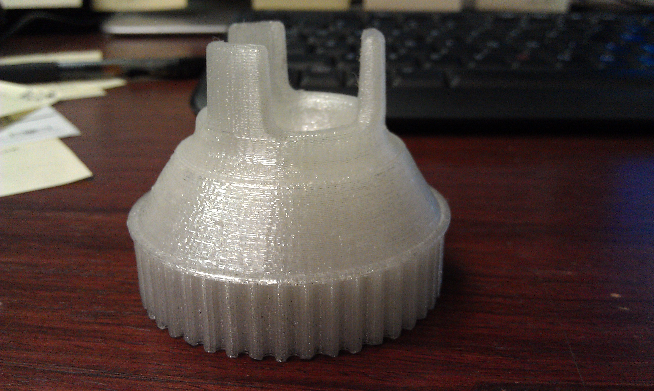

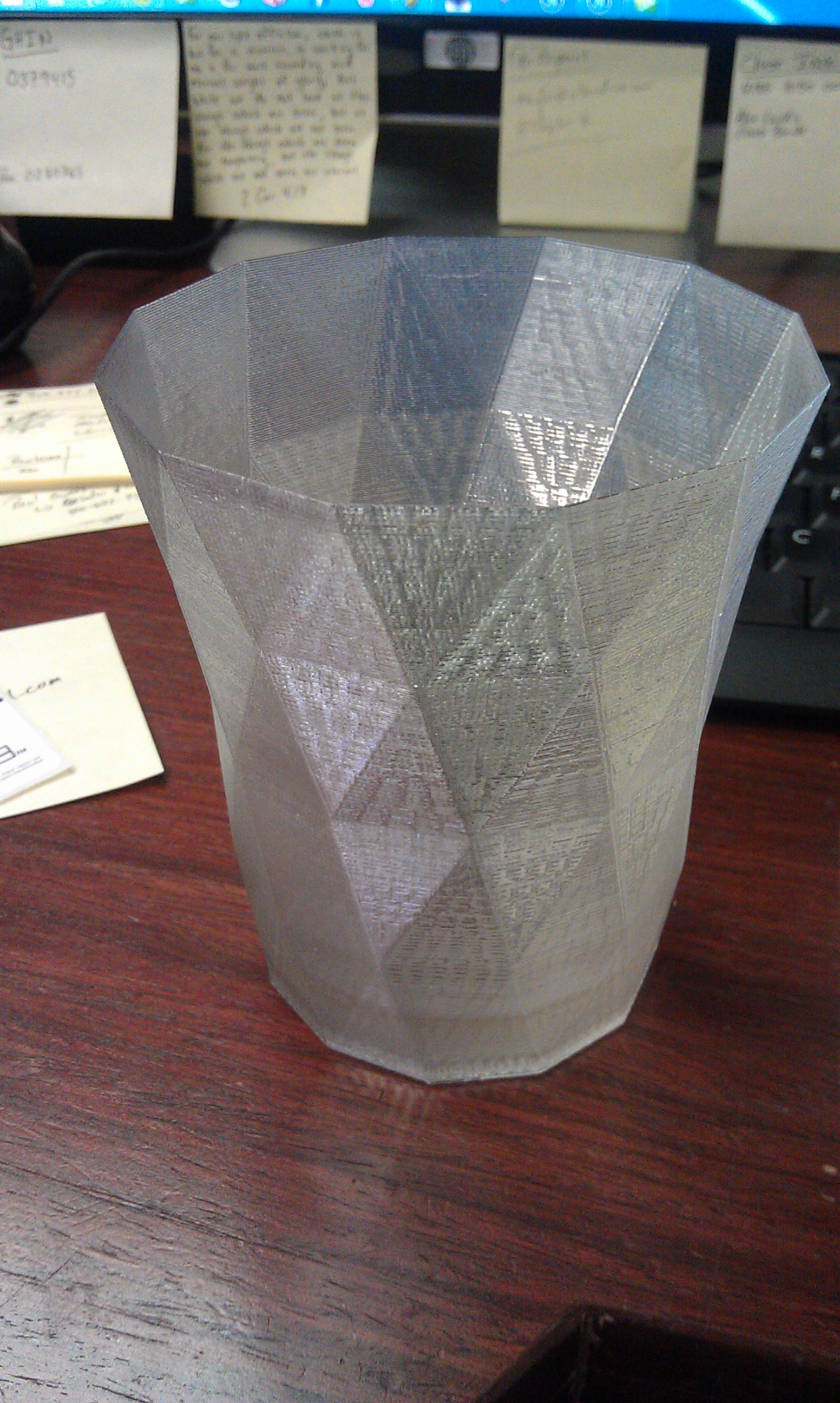

Hard to compare settings because I've got the E3D hotend.
I had virtually no issues with T-glase - other than the price :)
Does it seem to clog after retracts? After a certain amount of time printing? What speeds are you printing at? What speed are you retracting?
I don't know if PETT is subject to creep the way PLA is, but if you are able to print small items with no issue, but larger ones clog, then throw a PEEK fan on and see if that fixes the issue.
I printed at 212-214, speeds at 30-40mm/s max, .375 layer height, heated bed to 60C, retraction 10mm @ 60mm/s.
I got results like this...
which I use every day as my water cup in the office.
It's cool stuff. If it was cheaper, I'd use it more often.

Yeah, the results I got on the part I have successfully printed were pretty sweet.
[img]https://dl.dropboxusercontent.com/u/564 ... 7%20PM.jpg[/img]
I just can't seem to figure out how to get it more consistent. The problem seems to occur about 1/4 of the way through the print. As I said, Single-walled prints are my only success at this point. Anything with infill or more than one perimeter is what's throwing me troubles. That makes me feel like my problem is related to retraction causing some sort of buildup over the period of the print. I'm running 30mm/s speeds. My heated bed is at 75, hotend is at 215-220, .375 layer height (have tried .45), I'm retracting 2-4mm and am not home right now to check my retraction speeds. If I don't find success in the next day I think I'll setup my PEEK fan to see if that's the issue. I didn't think I'd need to based on what the guys at Taulman told me about the material and that they print long print long prints without problems with no fan on the stock seeme. Hope the extra info helps.

by cope413
Have you tried lowering the temp a bit?
I noticed that it printed much better at 212-214. When I increased it, it really started oozing and got sloppy.
I've printed a number of parts that weren't single walled - 55% infill - 3 perimeters
So I know it works...

Yeah, no, I'm sure it works. I just wish I could figure out what I'm doing wrong. I won't get back to the machine until tomorrow morning at this point, but when I do, I'll lower my temps, move my retraction settings a bit closer to yours and see what happens. If there's no success with that, I'm going ton install the peek fan and see what happens. Just out of curiosity, what % do people usually run peek fans at? I believe the speed is controlled with a % value anyhow. I have the fan sitting here anyway, I guess I should install it finally. Haha. I'm having a hard time getting my inside perimeters to slow down as well..I know that's a slic3r thing but can't seem to find it. Any thoughts on that?

Alright, I think I figured out what's wrong and it doesn't appear to be anything I'm doing. I paid much closer attention to a couple of print jobs in a row and found the same thing happening. It looks like I'll be waiting for the new spool of t-glase to arrive before I can do any t-glase printing. Even though I found consistent lengths of filament, part way through the print, it would feed through to a very wide section that would get stuck in the ezstruder tube. I confirmed this by detaching my bowden tube and just letting a long chunk manually extrude through the ezstruder..and every time at some length into extruding, the t-glase would get stuck in the ezstruder. I did go ahead and try manually pressing the filament through just to be sure I wasn't just eating the filament in the extruder and I couldn't even manually get it through. Looks like the spool is just a bit worse off than I expected. Not a big deal, errors inevitably happen in manufacturing. I'll wait for the new spool to arrive and let you guys know what my results are.
Re: T-Glase Troubles
Posted: Tue Oct 15, 2013 2:50 pm
by grabredemeyer
Alright guys, the new spool from Taulman fixed my troubles. I'm loving this T-glase now that I have a good spool of it. Thank you guys for all the help!
