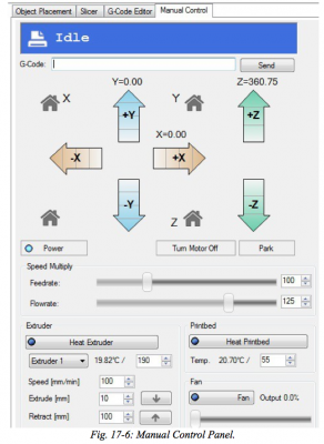

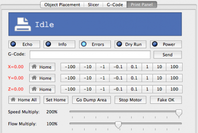

Ok, so I connected to repetier host last night and couldn't figure out how to move the extruder down in the software. Anyone who uses a Mac and Windows know if the Mac version is missing features? Or was I supposed to manually jig it down?

I use a Mac, but haven't used the Windows version. However, just based on the pictures in Gene's manual, I believe the GUI in the Mac version isn't as fancy for moving the print head around. The Windows version appears to have graphical arrows. The Mac version just has the number buttons next to the X/Y/Z axis that you click to get the same effect. Per my understanding the Windows GUI looks like this (Gene, I screen captured this from your manual. Hopefully that's not "Theft" or "Copyright Infringement" per the Creative Commons License :-D):
Windows movement GUI
The Mac GUI for the same operations looks like this:
Mac movement GUI
Mac movement GUI
Re: New to printing
