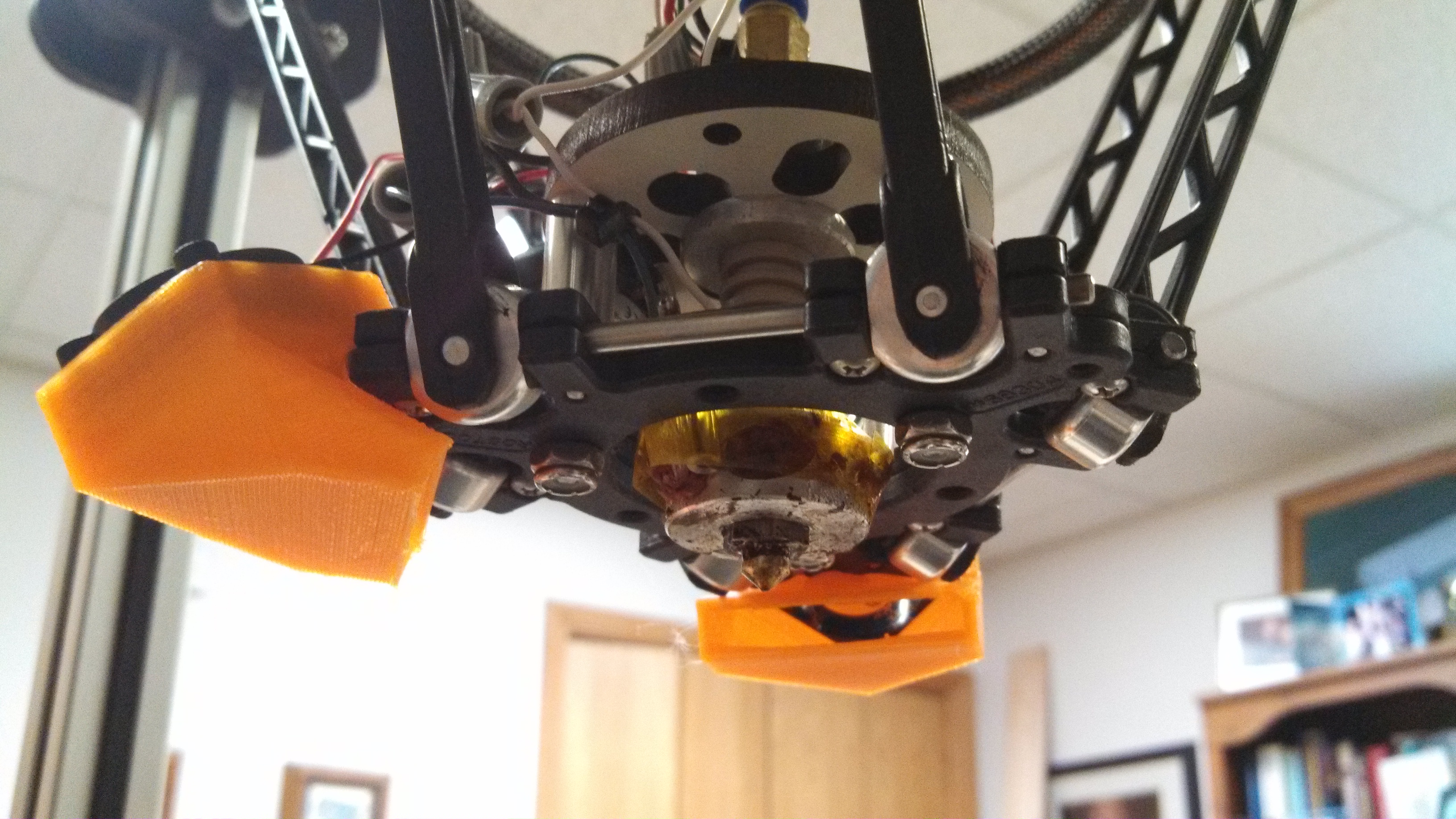

You need our new nozzle http://seemecnc.com/products/5mm-standard-nozzle
and
Cooling fan with shroud on hot end http://repables.com/r/140/
and
cooling fans (two of them) http://repables.com/r/142/ for 25mm fans
cooling fans on RMAX
