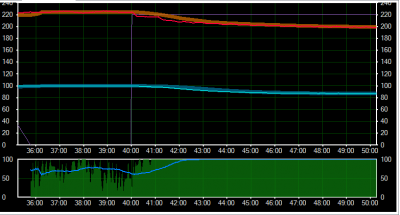

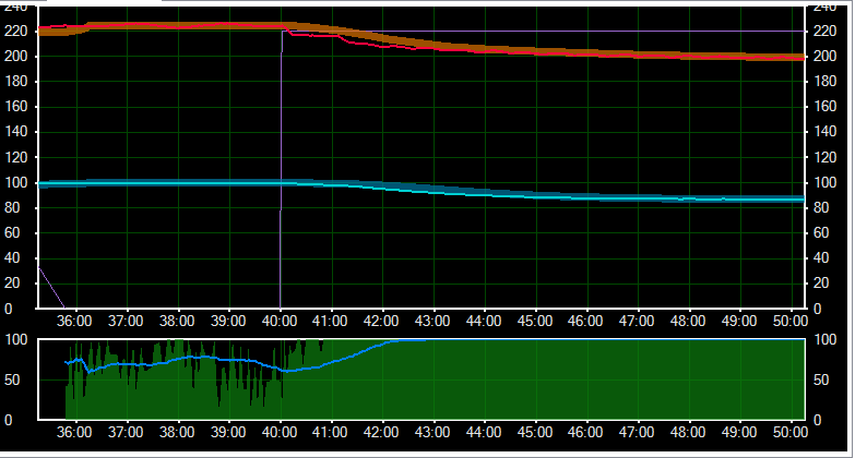

I have been printing for a while now with my Rostock Max, but have been having troubles with the hotend and heated bed not maintaining temperature very well. I am using a fan duct (http://www.thingiverse.com/thing:104483) and the hotend gets to temp eventually with it off, but when it is on it can't maintain anything above 195C.
Am I expecting too much from the heating capabilities of the printer? I would have thought that at least the hotend heating element, with two heating resistors would be powerful enough that it would be able to handle the cooling from the fan and still maintain temperature.
Attached is a picture of the temperature curve in Rep Host.

I suspect either the heating resistors are not making good contact with the hotend or the temperature probe is not making good contact. Most likely the resistors though, you really need the foil to be tight and make as much contact between the resistors and the hotend for optimal heat transfer.

So, even with the fan off it won't get above 195 :?: I would start at the Rambo-check output there. If that's good check wiring /connections to hotend/heatbed, if that's good. Check both resistors, maybe only one is functioning? Could be PSU issues too? Tough to find these problems? I built my hot end with K&S aluminum tube as inserts instead of foil. I can consistently get 235. Good luck :!:

With the fan off it can reach 225, just takes a while. I will try taking apart the hotend and using foil on the resistors. I just used the RTV silicon.

That may be your problem. It's like Lordbinky said "optimal heat transfer" the RTV is insulating the resistors. Good luck!

Took apart the hotend, and the resistors are both shot. Physical cracks in the sides, melted casing. Looks like they overheated pretty badly. Tested resistance, they are at 8ohm+. Anyone replaced these with heater cartridges? Is the RAMBo capable of driving twin heater cartridges (seen mostly 40W, 12V)?
