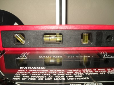

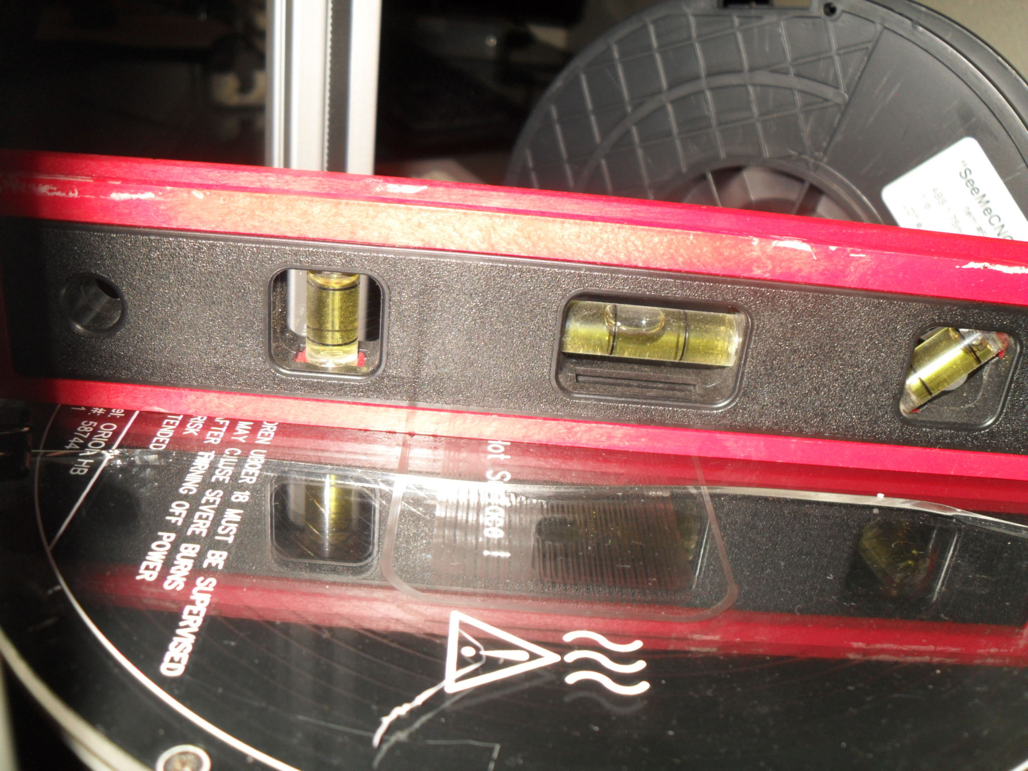

So i put a level on my bed, one way it shows it is level but when I place the level lengthwise down the center of the bed it shows it be way off, this could be a large part of the reason for my fails thusfar, only problem is that I have no idea how to solve this problem, any help is appreciated, thanks.

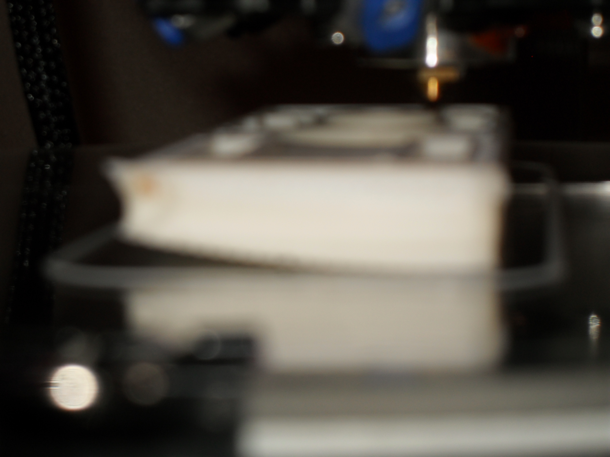

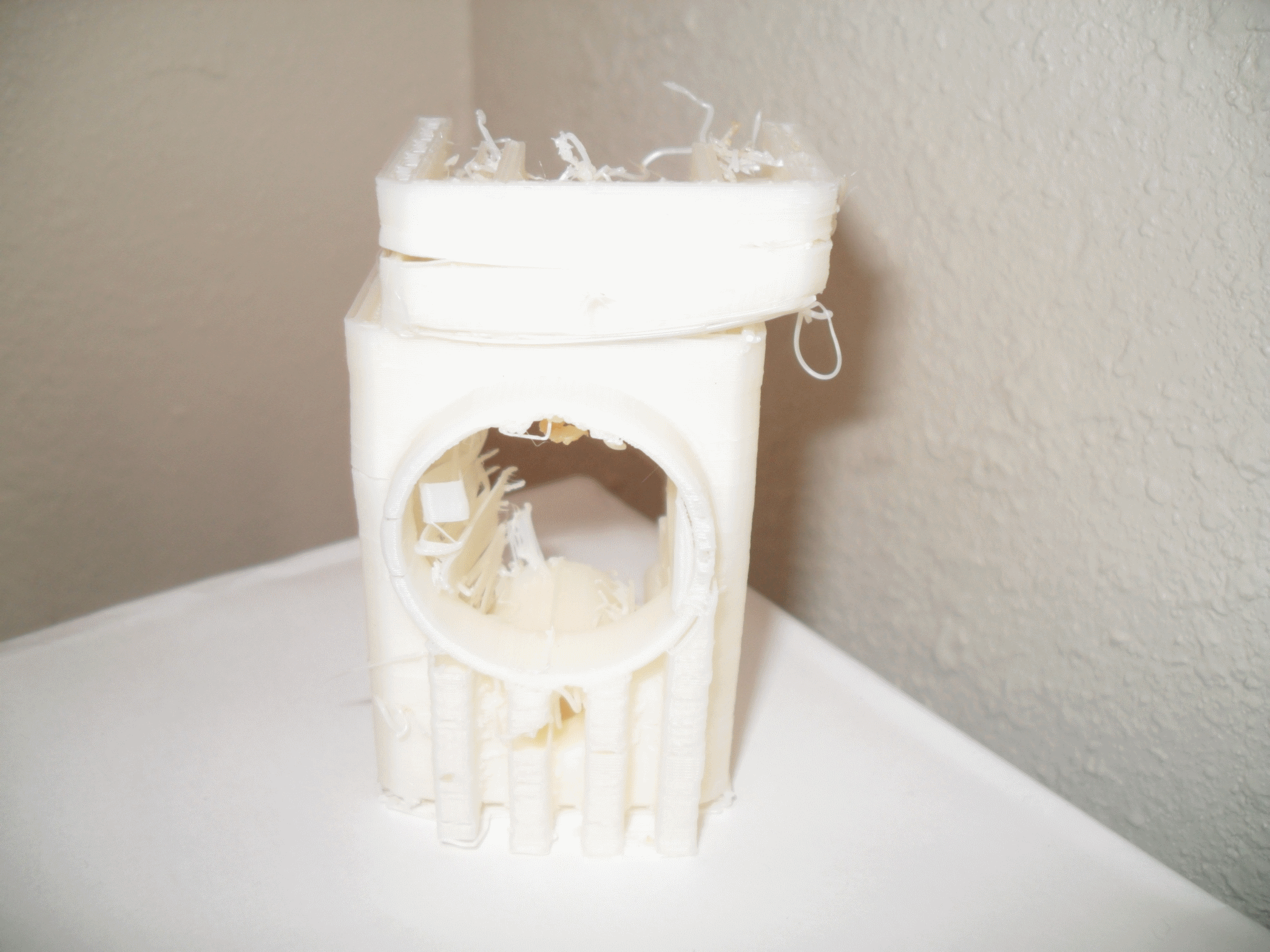

EDIT: Gonna go ahead and drop a pic of my piece curling up, it eventually fell off the bed platform altogether. That was at 90-100° C WITH AQUA NET, my question, do I need to simply calibrate the nozzle to make up for the bed being unlevel or physically do something to the bed in order to level it?

pics of the level on the bed,
LEVEL:
NOT LEVEL AT ALL:
Posts: 5358
Re: Calibration issues
My apologies - I didn't realize what forum you were posting this in - I thought you were referring to a Rostock MAX.
I'd check to make sure that there's nothing under the support plate for the heated bed as that kind of tilt really isn't possible any other way.

Think it could be something under that though, like actually inside the mdf housing? It took some nasy bumps from ups, the front blue translucent plastic around the lcd is cracked, one of the carriage screws was twisted beyond all recognition, the black nylon thumbscrews were sheared off and the boro glass plate came with a big chip that turned into a huge crack....
You measured the levelness of the glass which is directly related to the levelness of whatever you have the RMAX sitting on.
Is the desk, table or whatever the RMAX is setting on perfectly level?

Perhaps the hit it took from UPS pushed out some of the tnuts that the screws that support the heating bed.
I would open whatever doors you have and inspect with a flashlight and see if you see any nuts with a screw
attached that have pushed out of the bed. There should be no nuts hanging down. There are like 6 of these
screws that hold your Oynx to the bed. If enough pressure was applied to the Onyx to push the nuts out of the
bottom of the bed you would think that there would be a dent in the Onyx. If you measure the height of your Onyx
to the top of the bed, the measurements should be the same all around the Onyx.

Talked with john about it yesterday, no one seems to want to believe me when I say I think it's the bed height, gonna try to screw it down to level it out but I also saw this to avoid edge curl on another site:
"I spray a light coat of adhesive spray onto the build platform and put a sheet of 100% Cotton, 32 lb resume paper ( Southworth ) on the platform. The first layer tends to soak into the cotton which is held down by the adhesive spray ( the desired amount of adhesion can be adjusted by the amount of spray used ). The entire print is then easily removed from the build platform. The paper layer can usually be removed with sandpaper or it can be soaked in water to remove. The adhesive spray typically lasts for about a dozen or so changes of paper. I use small amounts of mineral spirits to remove the adhesive coating when it builds up. Some other things that appear to reduce curling: - Increasing the temperature ( 5 degree increments ) - Turning off the filament fan - A large clear plastic trash bag over the printer kills any drafts while still giving the print head freedom to move."
Do you think the collision from ups could have caused the machine to miscalibrate so much that this would occur as well:
I'm literally at my wits end here.....

The heated bed for ABS should be 90C to 100C. This helps prevent warping. If you have a PART cooling fan or blower (different from your hot end cooling fan on all machines), make sure cooling is turned OFF for ABS prints.
Your Sample Part:
I understand you've got some help from us. I heard that your first layer looks good and even on the build surface. So it sounds like your bed is level.
Next, your CAD file might have problems. Also, your extruder temp might be low. Look up http://forum.seemecnc.com/viewtopic.php ... it=owl+2.4 ; with the exception that it's PLA, make your filament temp 225. You might copy these Slic3r settings and try again. I've had bad STL files step shifted like your photo before. After a cloud.netfabb dotcom fix, the file sliced good. Also, don't copy your file to the SD card over the USB cable. Don't even plug your machine into the USB cable. Copy your .gcode file directly to the SD card, then plug back into the printer and print from the SD card.
Try slicing something else:
Does your STL model import into Repetier without errors? Slicing another part file might help.
