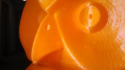

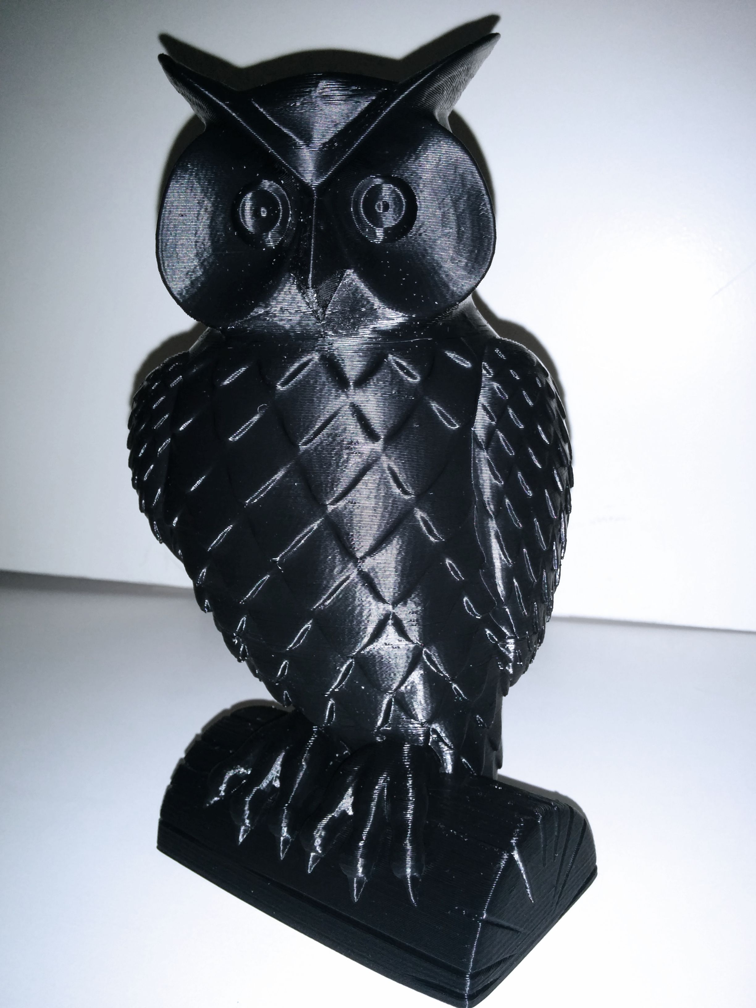

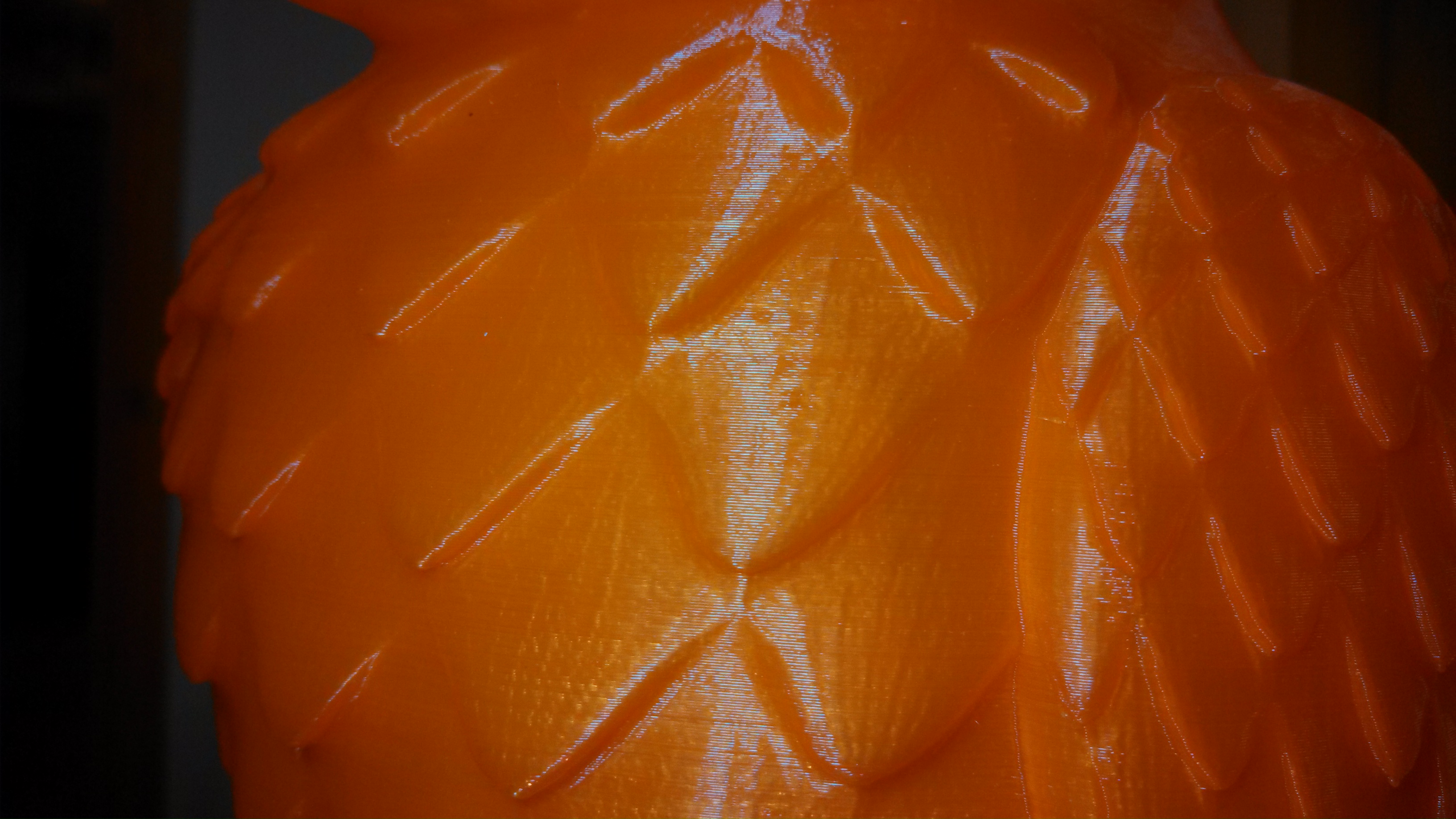

A 2.4x scaled print of the great owl on a stock Rostock MAX and our hot-end.
The file: http://www.thingiverse.com/thing:18271 owl by cushwa
The print by PartDaddy
Some Statistics:
SeeMeCNC's stock hot end that has been shipping since summer 2013
translucent orange PLA (from SeeMeCNC)
343mm tall
weight 1.6 pounds (0.73kg)
time 47.5 hours
Repetier 0.90C, Slic3r 0.9.10b
hot end temps set at 200C, but reported about 190C with fans on
bed temp set at 70C with only a little glue stick applied to 99% alcohol cleaned boro glass

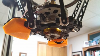

Re: Owl Facing Left 2.4x scale
Here's the cooling fan setup. There is one layer of kapton on the hot end, but I don't think it's necessary.
Other hot end notes: I don't use aluminum foil wrapped around my heating resistors. That was something I did early on (two year ago). I only use the high-temp RTV Ultra Copper silicone when gluing in my heat resistors and thermistor. Don't be concerned about the heat resistor not making contact with the aluminum heater head. MAKE SURE you fill around the heat resistors with RTV, cover them completely.
There's about 300~400 hours on this hot end.

Here's a link to the fan ducts
The 25mm Fan Duct for the PEEK cooling fan is
http://repables.com/r/140/
The 25mm part cooling fan ducts are
http://repables.com/r/142/
AND the NEW and IMPROVED 30mm blower fan for part cooling is
http://repables.com/r/171/
The last one uses a 30mm squirrel fan, we'll have them on the website shortly, but it is what's shipping with ALL Rostock MAX kits now, as well as Orion's come with it loaded and ready
