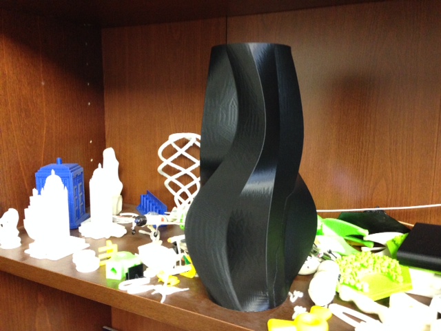

Hi!
I just completed assembly of a Rostock Max. It's my first delta printer. I've attached a picture of my first real print (after 1 test cube). I was surprised at how well it printed right off the bat, especially after the time consuming assembly process. Now that I've gotten that out of the way, I'm refining the calibration of the printer. This is where I need your help. I think I've gotten the "Printer Radius" value pretty close but I am running into a weird problem:
The nozzle is at the same height at the base of each tower and the center of the build area, but is raised up slightly in the areas between each tower. This is especially noticeable at the limits of the build area (IE: when making a large radius circle). I've been using the Rostock Onyx Bed leveling Aid from thingiverse to help visualize this effect. I could get out the dial indicator, but that's overkill at this point. Any thoughts? END_EFFECTOR_HORIZONTAL_OFFSET, CARRIAGE_HORIZONTAL_OFFSET, PRINTER_RADIUS all are summed (-) to give DELTA_RADIUS, so I suspect that altering those won't fix the problem (as I've played with the delta radius values a bit...maybe I need to do more?) .
