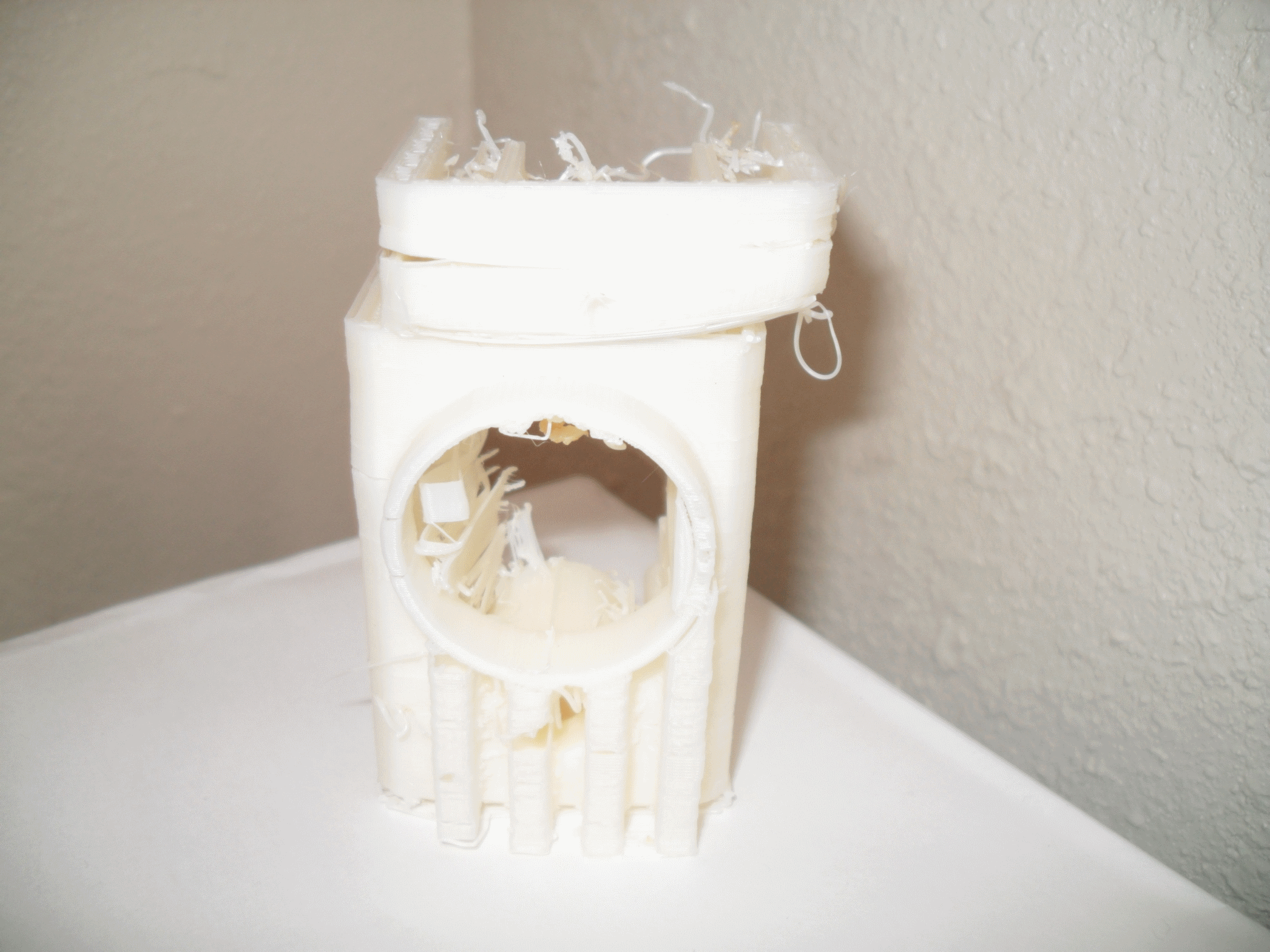

Extruder temp is the default that the orion quick start guide detailed (thx geneb), so I think like anywhere from 210-220 for the ABS, depending on layer. I actually printed up someparts last night, went to bed when they were 30% complete, lookin decent, wake up and it all went to hell. A mass of spaghetti on end of the bed plate and an offset part on the other, no idea how this even happened but here is a pic of the offset part:
also I had to use supports, no idea on what settings to input so I just guessed, perhaps that has something to do with it? Furthermore even with the heated glass bed AND the super hold aqua net my parts started to curl, I'm going to close the vent in my office tonight and see what that leads to. Also, because I did not want to give up on the prints that I had wanted for so long, once they started curling at the edge I furiously applied superglue gel to them, this held until the spaghetti plastic and offset parts started printing, at which point i shut it down. All help is appreciated as usual....

If you are printing ABS, I would not even try a part without a brim, a raft or "mickey mouse ears". Especially if said part is a lot of mass. My rule of thumb is to add one of the afore mentioned in at least the same area as the bottom of the part. I've also lately been running a small ceramic heater blowing at the level of the Onyx. It doesn't create a lot of draft and keeps the print area hot. My temps seem to stay more constant now. 230C and 80C respectively. I have a max, but I think it all applies.

255 is too hi. I've always printed ABS, and you will fight lifting and curling from time to time, but it's never plagued me.
I had the gen1 SeeMe hot-end and got a lot of pops and snaps from overheating the filament at 230. I did some test prints where I'd manually move the temp down 5 degrees at a time and found out that my layers will stick to each other until I get down around 185. Since then I've installed the hotends.com JHead and just kept my temperatures from before. I'll have to run the test again since the new hotend undoubtedly has a different melt chamber. SeeMe has updated this aspect of their own design too (plus the new nozzle is great).
Since I don't have a layer fan, I usually keep things moving slowly and have had good luck printing between 200 and 210. When I get things in gear and add a layer fan, I'll probably be able to crank up the speed and will raise the temp as a result.
I've always used aquanet, but I've heard good things about ABS juice (abs scraps + acetone) and I've also seen greta results from GlueStick. Blue tape and kapton tape works too. You might give some of the other "sticking agents" a try after you've tweaked your temps a little.
