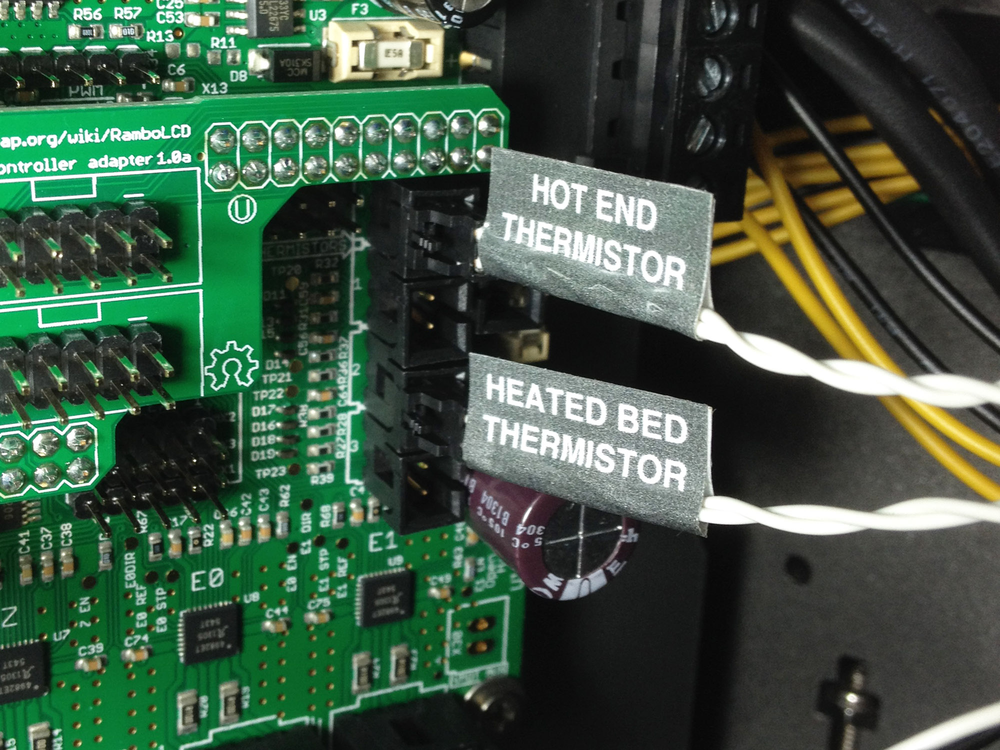

Hi guys, I'm finally wiring everything, but some problems came up.
Is this ok? Because the pictures from the guide are slightly different. I suppose It's because the Rambo I have is the 1.2

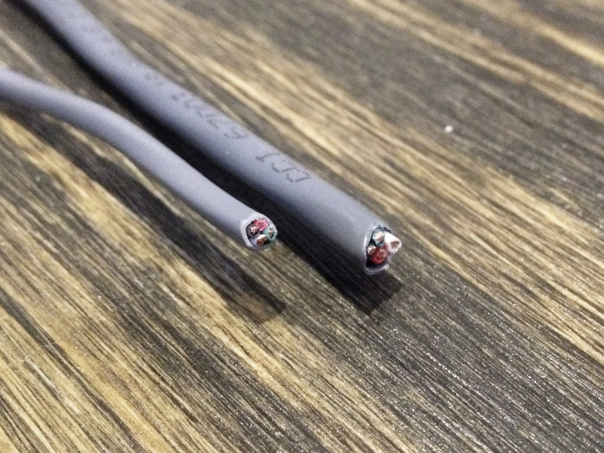

The box came with this 2 wires. The first one is smaller and the second is bigger and "shielded" (don't know the word in english).
Can someone tell me on what should I use them?
I'm guessing:
small = hot end resistors and thermistor
big = stepper motors
Any help is greatly appreciated.

Your thermistor wiring looks good. Mine is the same way and works great.
I also used the provided wire the same way you are proposing - thicker wire to extend the extruder stepper motor and the thinner wire for my PEEK fan and light ring. I ran a separate pair for my hot end.
If you're not using a light ring, you could consider using the thicker wire for hot end and PEEK fan, and the thinner for the stepper extension. That probably doesn't draw a lot of power.
Good luck finishing the build!

Tincho85
Posts: 659
Re: Wiring doubts
Post by Tincho85 »
Awesome, thanks Dave.
I don't have a light ring but will do in a future, so it would be good to leave all ready.

cope413
Posts: 446
Location: Orange County, CA
Re: Wiring doubts
Post by cope413 »
Save yourself the trouble and wire your PEEK fan now. It doesn't hurt with ABS, but you will end up printing with PLA at some point, and then it's necessary.
