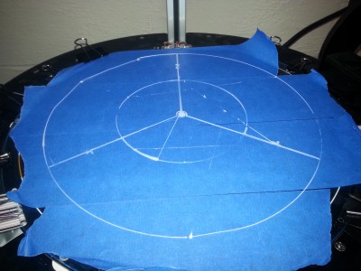

See attached image for example of what happens. Here's a 150mm round calibration print.
If you look between the X and Y rails near the front of the print, you can see how the extruded plastic is perfectly round, not smudged into the bed. While the right side of the picture you can clearly see the print head is dragging so close to the bed that no plastic can come out. There's no doubt if I let this print continue for a full 10mm that I would experience warping of the first layer.
Looking for any possible causes. Initially, I suspected my aluminum heat disspator plate from Mhackney was the culprit, so I have removed that. The Borosilicite glass from SeeMeCNC appears to be perfectly level. Something else is going on here....

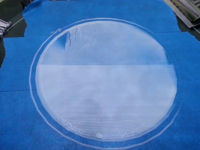

Second row halfway finished before I killed the print.
Hard to see, but middle of the print is absolutely horrible, the rows are not smushing together

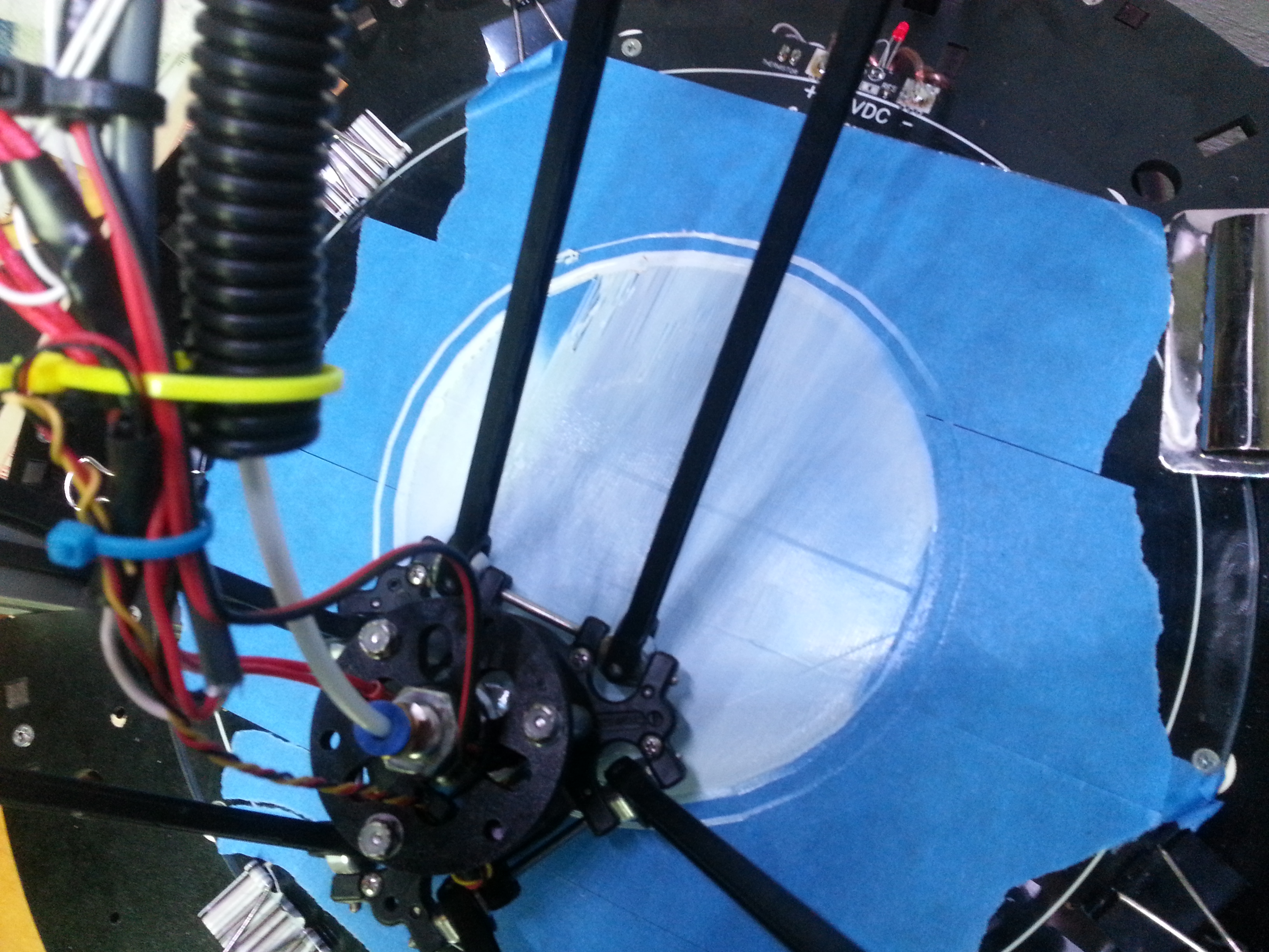

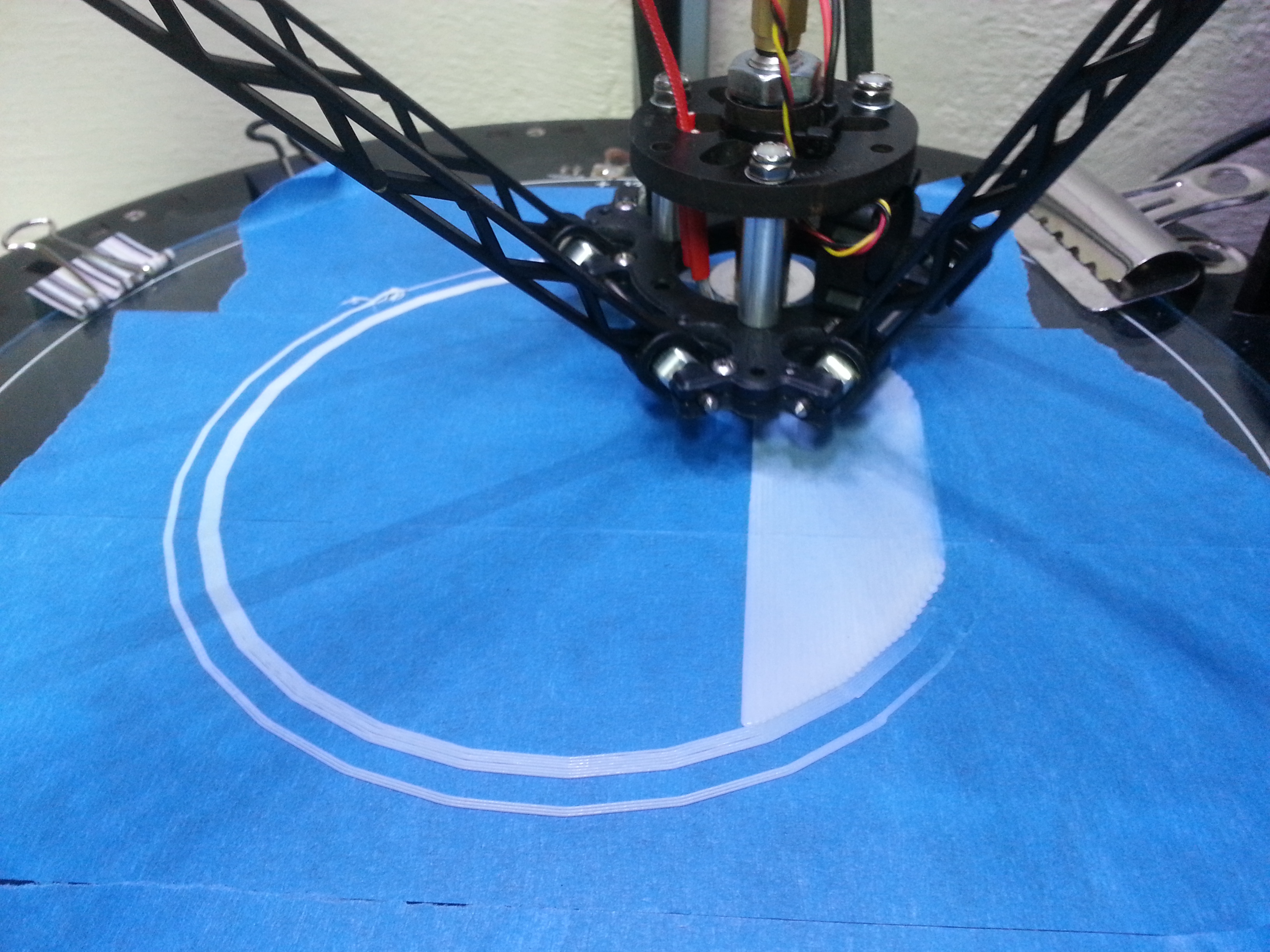

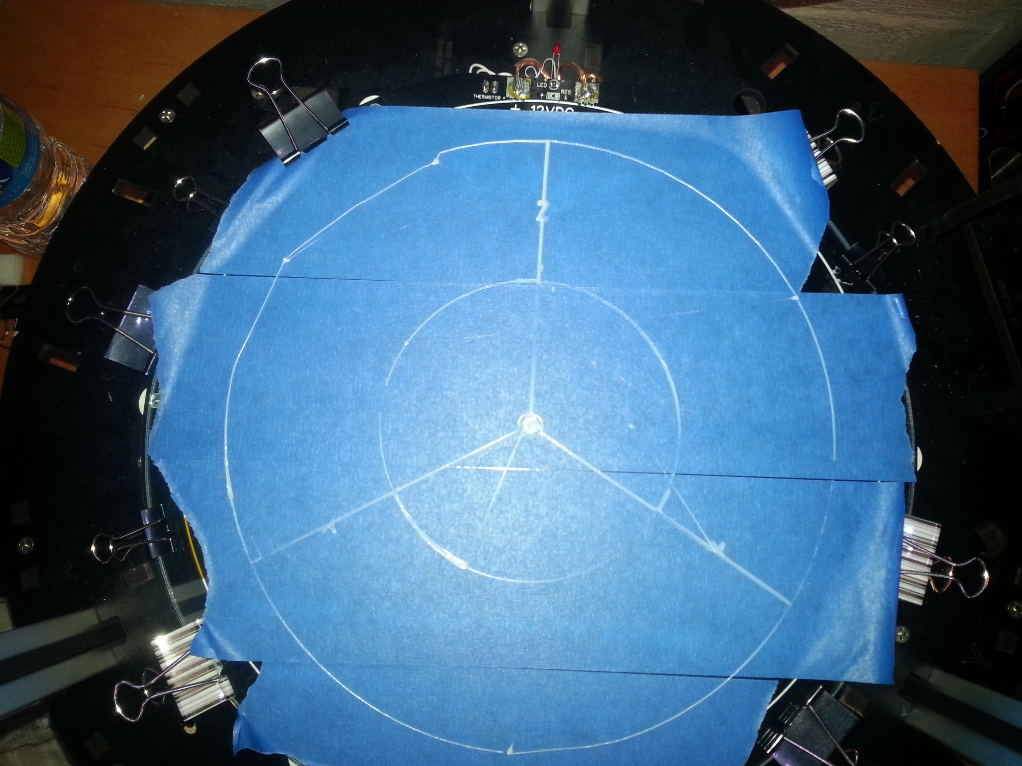

Attached is the pictures of my problem
On the left side between the Z and X rails, the platform rises considerably away from the bed, while close to the Y rail, there's a high spot. Most visible is the left side outer circle, you can see how the head was so far away, the filament doesn't even touch the bed!
Suggestions before I go Office-Space on this printer? :?: :?: :?:
