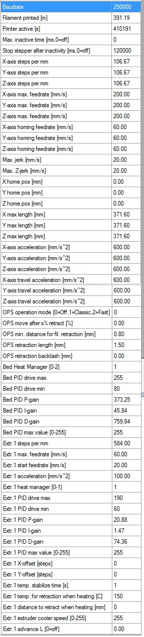

I am very impressed with my rostock and what it can do. I haven't had enough time to really put it through it's paces as much as I would like but I have nearly 113 hours of printing on it now. Printer is mostly stock with the exception of the Trick Laser arms and printed new axle and spool adapters for filement roll to turn easier/smoother. Still running the original hotend and extruder. Using 1.75 ABS from Seemecnc. No fan yet but I have plans to add one before the day is over. Printing the Belt tension levelers for it right now because belts are rubbing on the extrusions.
I recently started using it again to print some things for a project and ran into a problem with infill. I can't tell whether this is a section that is too hot or if the filament is starving once the print has ran for a few minutes. First layers look great and are filled in perfectly. This was with a .5 infill at 60mm/s infill rate. Printing first layer at 220c/80c first layer , then running 220c/60c for other layers.
What does this look like to you?
[img]http://i5.photobucket.com/albums/y176/cjdavis618/rostock/6B8F6A59-ED9F-4996-8E39-8A9E3368FF95_zpsdeekzn8v.jpg[/img]
I have also attached my complete eeprom settings to make sure there is nothing there I am missing.
Thanks in advance for any help you can offer.

Please excuse me for just scanning this thread but did I see above that this is an "early" Rostock MAX? I recently upgraded my firmware from .80(?) to .83 and I had to go into Arduino and tweak the Configuration.h file to match my early Rostock's characteristics. For example, I had to set the pulley teeth count back to 15; the "new" pulleys have 20 teeth. There are a number of other settings that need adjustment for "older" machines.
Another issue (I think) is the way the delta movement is now managed. You might find it useful to download the latest version of the Assembly Manual and go through the Delta Radius calibration steps. It is easier than the original (IMHO) and is well-documented in geneb's narrative.
In the software section of the manual you will find another interesting tidbit - the steps per mm for the extruder. If you are using one of Steve's original extruders the steps need to be set to 584. The new direct-drive extruders use a different and much lower value.
Hope this helps! And good luck.
Bill
Re: Too hot, or filament starving?
https://github.com/seemecnc/RepetierMAX-Devcjdavis618 wrote: Maybe I got lucky and downloaded a screwed up firmware from the fork on Git, but it did make the SD card work. I can't use SD now on it with .81.
This is the fork I'm currently using
