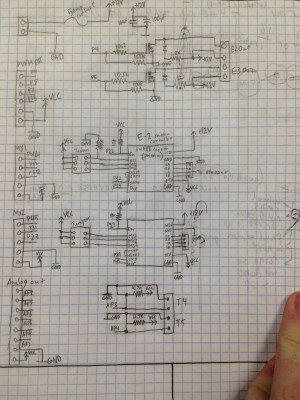

I have a roughly sketched version of the schematic in my notebook, Ill attach it. Its mainly based on RAMPS electronics, mainly because RAMPS seemed the most accessible to hackers, and a bit easier to understand for me (mainly because of the blurry low quality schematic on the RepRap wiki of RAMBo)
I don't really have the money or resources to test this out, nor do I have a MAX or RAMBo based printer to use it with, but if someone could actually make one to verify things work, modify the firmware to make it work, that would be awesome to see, or if anyone has any critiques on it, I can modify it, or best yet, if someone could make a more official looking schematic or even a trace pattern for people to make their own boards for this (rather than hacking together something on a breadboard) that would be AWESOME. Hopefully this will be of help to you guys. All of the ports on the side are the outputs from the RAMBo that you will need to use (except the 12V power, which would need to be a terminal on the board) and connect to the board. The number assigned to them are the pin numbers in Arduino, anything with a P## is a digital pin, and anything with an AP## is an analog pin.

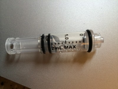

Insulin cartridge
Insulin cartridge
The length of the "2ml" of the cartridge is 20mm. So every mm would deliver .1 ml of liquid.
Then, the cartridge is connected with a Luer lock to a tubing with a plug at the end. It looks like this:
Insulin cartridge with tubing
The outside diameter of that needle at the end is about 0.5mm. My plan is to use an M3 screw with 0.5mm pitch threads and a 1.8 degree stepper motor (that's what the RMax currently uses). Without any micro-stepping, that would deliver 0.00025 ml of liquid per step (unless I've done my calculations incorrectly :-D). I'm hoping that by hooking up several of these, I can make something that can put small drops of liquid along the perimeter of a layer, blending for different colors.
