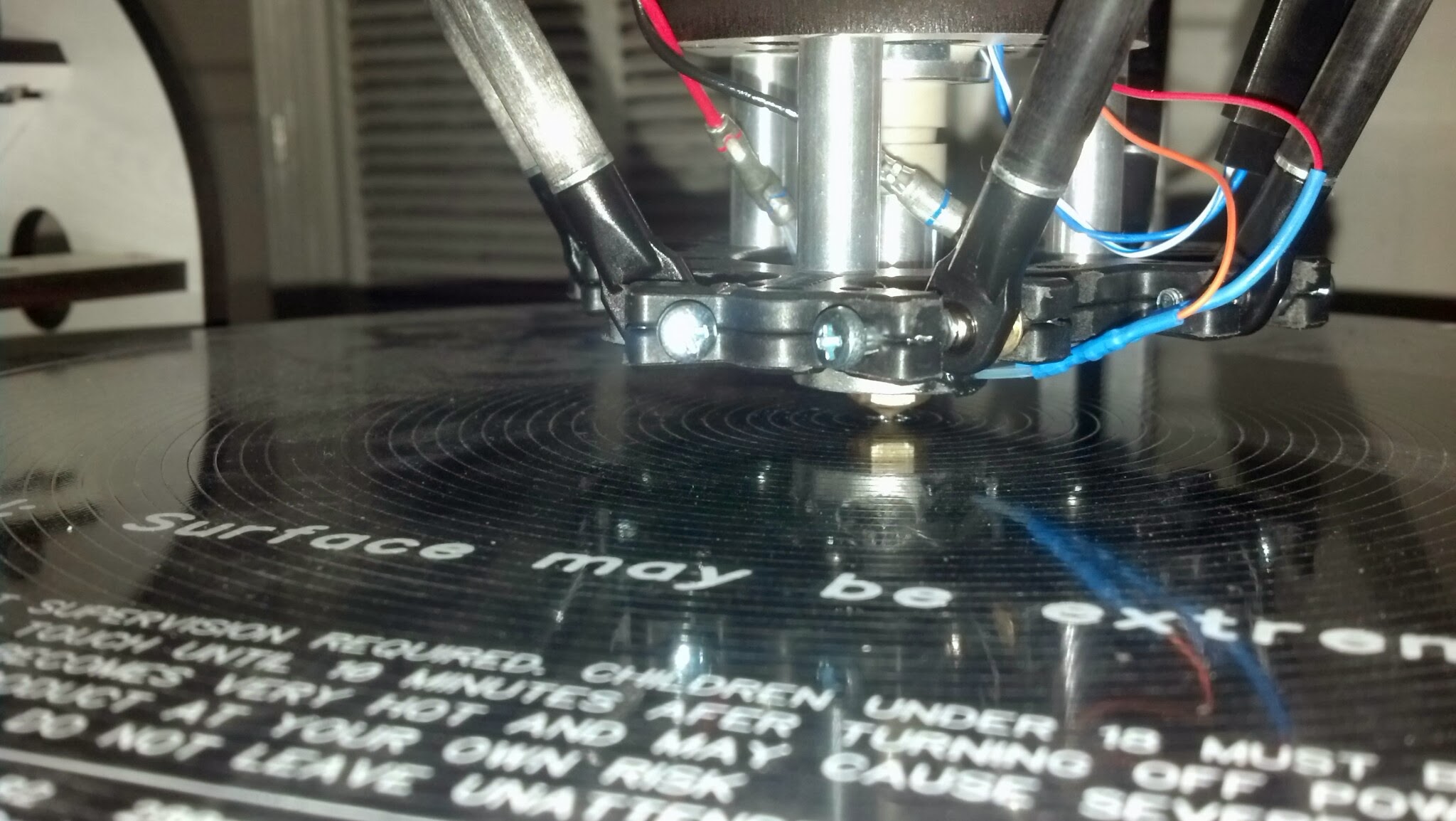

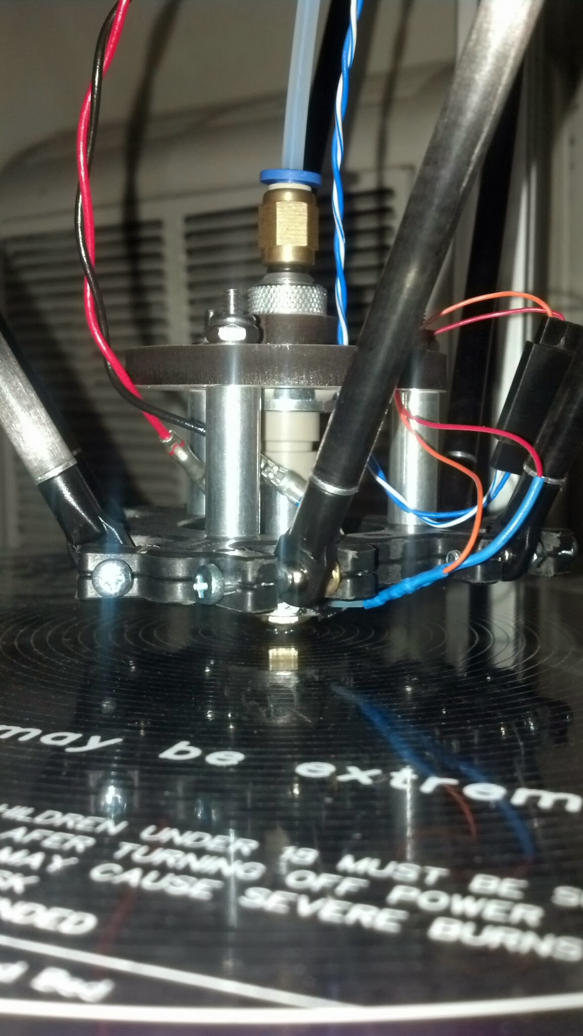

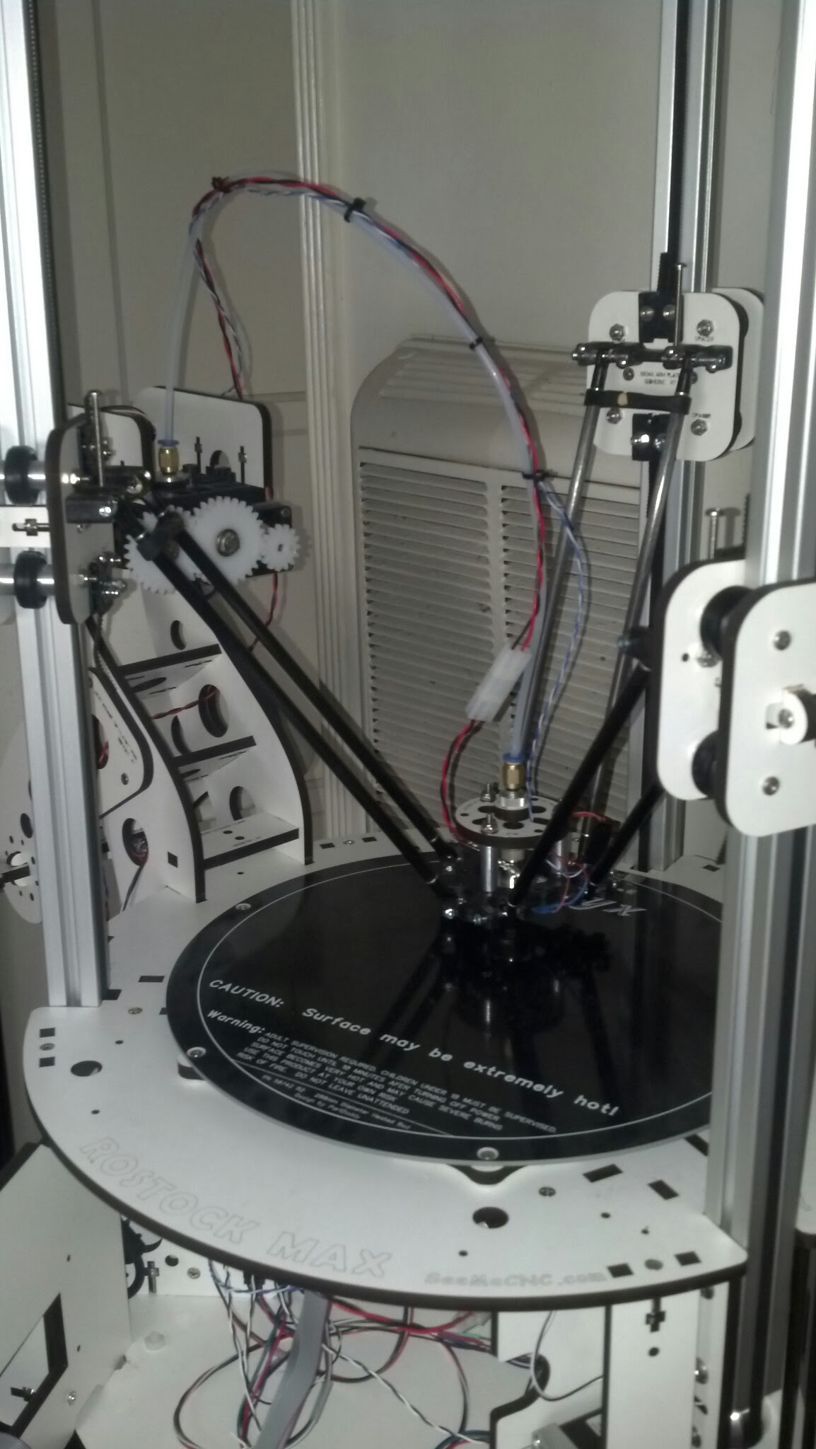

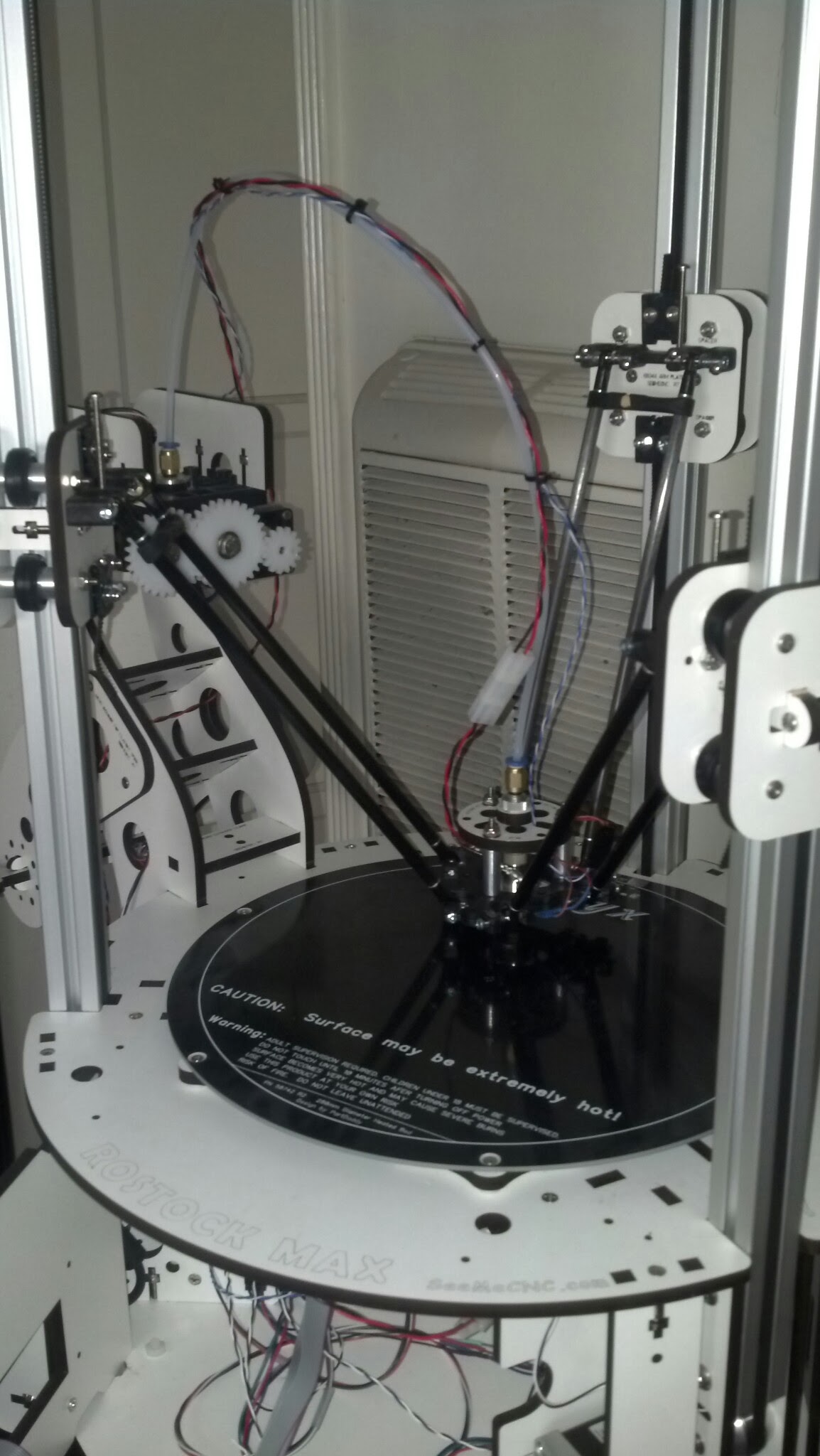

First off, this doesn't look like the manual. I am putting the amount I am away from the bed at Z0 into the homing offset fields and it is now Z0 nicely. The PID settings and the home settings are not staying. Everytime I disconnect they reset, is this normal?
EEPROM
EEPROM
I am also having an issue with my home switch set screw calibration.
See below and the codes that were issued to get me there.
G28
G28
GOOD
GO Z0
GO Z0
GOOD
G0 Z10(5 hits the Onyx) X0 Y90 F3500
As noted the +5 hits the print bed, adjusting the screw makes it better, but then my Z0 gets screwed up...
G0 Z10 X77.94 Y-45 F3500
G0 Z10 X-77.94 Y-45 F3500
GO Z100 X0 Y0
GO Z100 X0 Y0
Corrected by Manual to Z0 X24 Y25 (centered)
As I understand it the Commands are going to put me near a tower each time. It seems that the calibration puts me only near my x tower.
The issue mainly is that something is wacky and I am at a loss of where to start. Also it seems I am somehow offset from "0,0" at somepoint. I have to G28 to get it back.
Also, going straight down (Z commands only) sends me down vertically, adding X0 and Y0 seems to make it NOT centered. What am I missing?
Any help is appreciated.

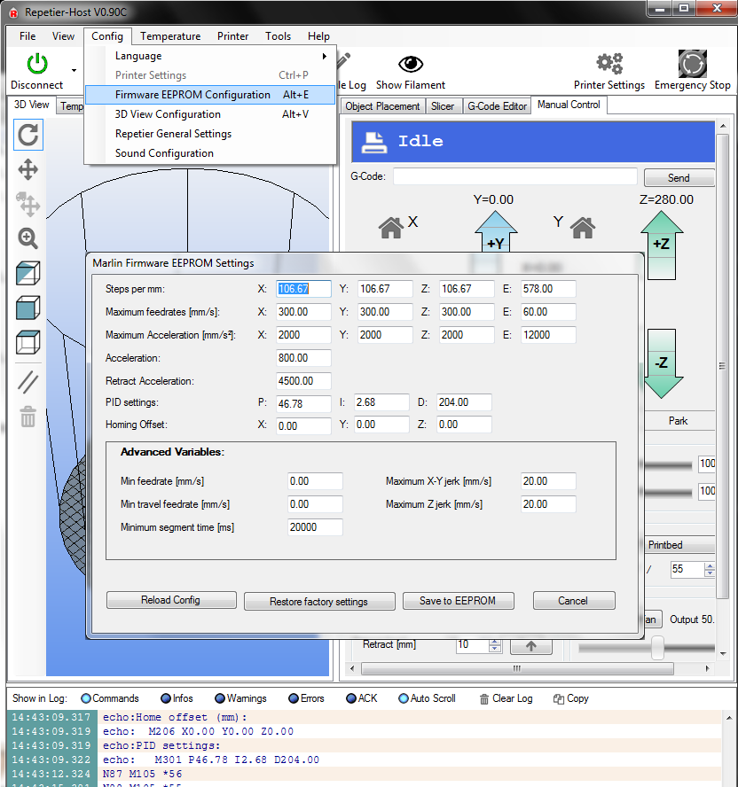

**************EDIT: You can read the rest of this thread if you like but I have compiled the answers here as well.*************
So far the issues have been injecting the CORRECT firmware (I had injected Marlin apparently, the one that comes with Audrino). https://github.com/seemecnc/RepetierMAX-Dev NOT http://github.com/seemecnc/RepetierMAX as in the manual.
I found these Videos very useful in this endeavor however it should be noted his settings are not what you should use per say. It REALLY depends on your hardware as you will see.
[youtube]http://www.youtube.com/watch?v=A4yMV18oMbw[/youtube]
[youtube]http://www.youtube.com/watch?v=8BlvPaii9nw[/youtube]
This one I did not need and is worst case scenario but useful.
[youtube]http://www.youtube.com/watch?v=mC4Pv15Ibco[/youtube]

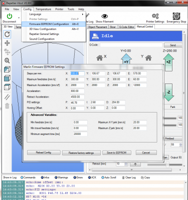

The steps per mm were off because of a weird combination of Rambo 1.1 and old gears (15teeth)
kbob wrote:Current Rostock MAX kits ship with 20 tooth pulleys and RAMBo v1.1, which has 16x microsteps. It sounds like you have an older kit with 15 tooth pulleys. You might also have RAMBo v1.0, which has 8x microsteps.
  • 20 tooth, 16x => 80 steps/mm
  • 20 tooth, 8x => 40 steps/mm
  • 15 tooth, 16x => 106.67 steps/mm
  • 15 tooth, 8x =>53.33 steps/mm
(Hope my math is right...)
And me not knowing about the EEPROM and how to over ride it.
Eaglezsoar wrote:
Dust2Dust02 wrote:Where is that?
Eaglezsoar wrote:Per the link, the Eprom will get you every time. Turn the eprom off when you update the steps per mm by setting it to 0 when you copy the new configuration over
then set the eprom to 1 and upload again. Or you could try the M500 which sometimes does not work per what I have read.
In configuration.h #define EEPROM_MODE 1 (setting this to 0 turns off the EEPROM)
I am still fiddling with the height but all 5 points of an x-50,0,50 y-50,0,50 are now just barely pinching paper.

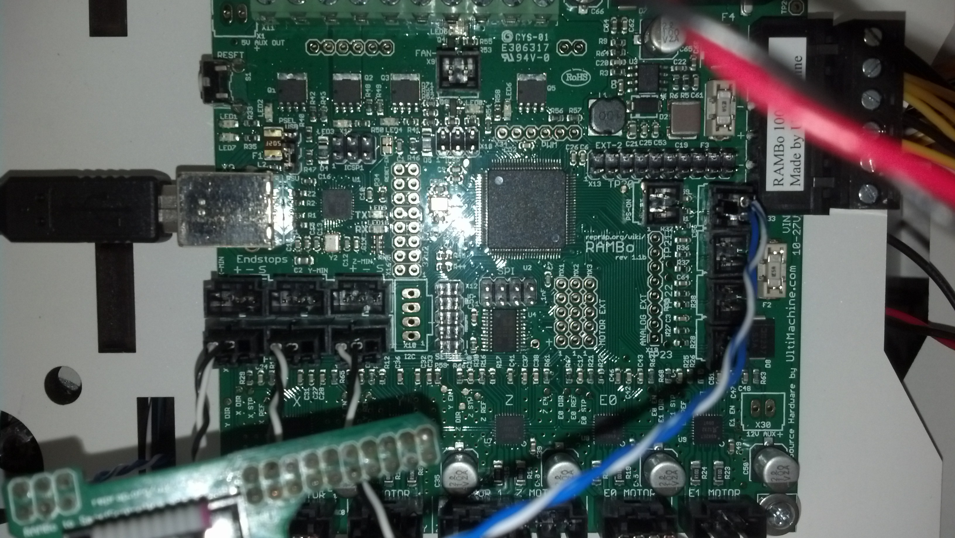

So, I thought I had flashed the firmware on my Rambo, guess I didn't. I went through the steps again and flashed the firmware. Lcd works and GO Z100 X0 Y0 gives normal results. Will see if other issues resolved later.
Re: Calibration issues
By the first screenshot I saw, you have Marlin installed - all the information in the manual only covers Repetier-firmware, not Marlin.

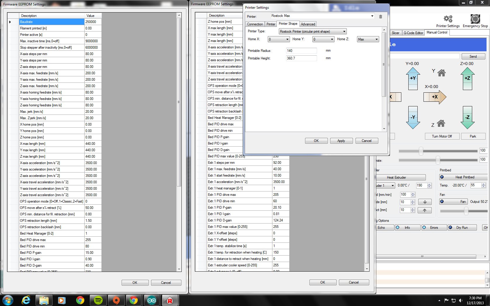

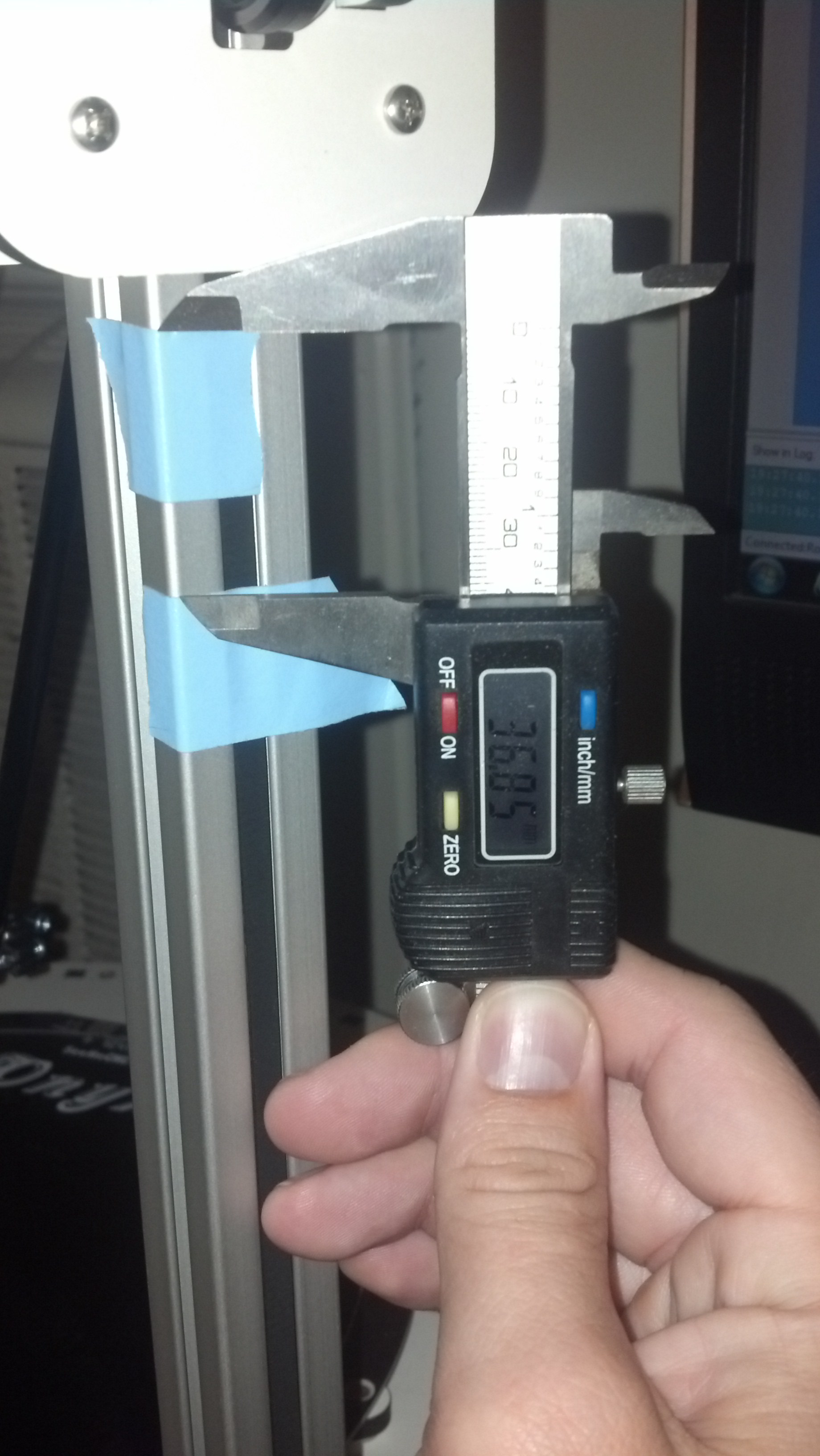

Here is my newest issues... Everything got better with the firmware.

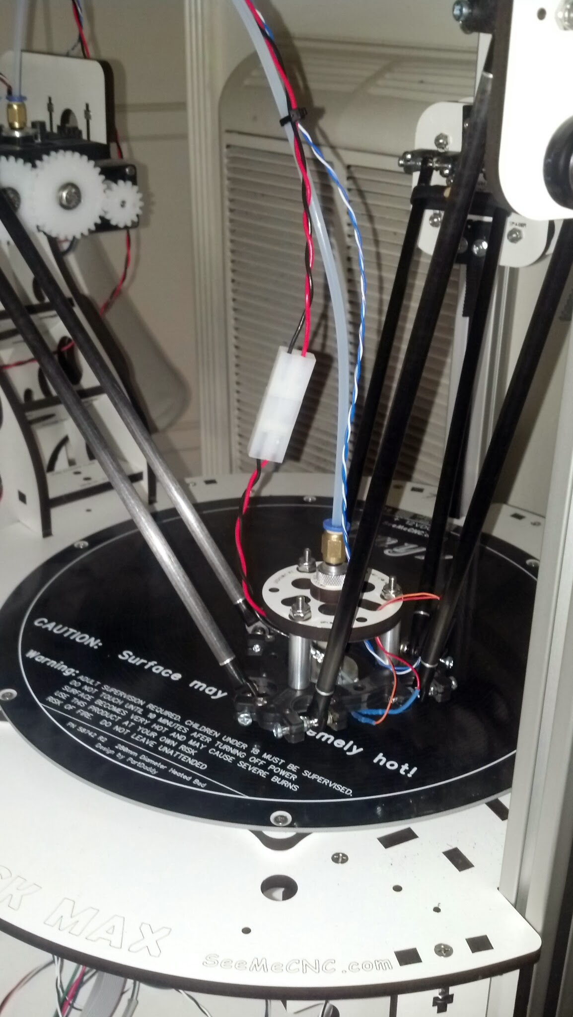

Except now it wont go lower than this anymore (about 50mm). Before the Firmware fix I could tell Repetier Go z-(whatever) and it would oblige. It ignores me now.
This on the Repetier says it is 50mm (calipers say 36.85mm)
And when I change the heights in the configuration in Repetier it seems to have no affect. Even after I use M500
Everything else seems to be working fine now. The test position commands go to one axis only now, but not very near it. G28 homes all axis at once.
Here is my Conf as it sits.
Conf-h.txt
(48.74 KiB) Downloaded 474 times
I have the all aluminum gears at 15 teeth, board set to 301, steps set to 16 since I have the Rambo 1.1 , I think?
Thanks guys!
Just to clarify, my questions are how do I fix the issue of it not moving the right distance, and how do I get it to go to real Z0 now?

Are you sure your gears are 15 teeth?
That doesn't sound right with a Rambo of 1.1b
They are normally 20 teeth, did you count them?
Dust2Dust02
Posts: 44
Joined: Thu Aug 29, 2013 8:28 pm
Post by Dust2Dust02 »

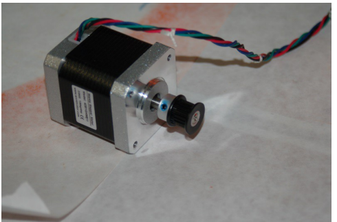

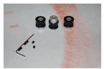

These are not my kind. Mine do not have the shoulders on them, they are the all aluminum with the big a$$ screw, not the grub.
There have been many iterations of the Rostock Max and I have seen the type of gear you are talking about with the big ass screw
but I do not remember how many teeth it had. I looked it up and your type does appear to have 15 teeth. The picture shows the
15 tooth and the 20 tooth gears. The tooth count is not your problem. We need someone else to jump in and help with this problem
any users reading this and think they can help, please jump in. The original questions are how do I fix the issue of it not moving the right distance, and how do I get it to go to real Z0 now?

Yep, it's the one on the left. It seems to me that the issue I am seeing is slightly because of the fact the Rambo thinks I am going further than I am and it cuts me off, 360mm only being 310 or whatever. That is why I think the "teeth" are screwed up or something, but I changed them? Is there another setting I should look at? Are there anyone else with a working 1.1 with the old gears that can upload their CONF that I can use :mrgreen: . Is there a place where people upload working Confs? (There should be :D )
The other issue of it not "taking" the height change or letting me go to a negative Z is not related but strange all the same.
Whatever the issue I am at a loss for the moment.
The steps per mm are off somewhere, that's what is causing it not to move the right distance. See this link for the correct steps per mm.
http://forum.seemecnc.com/viewtopic.php?t=2474&p=18143
If you are using the same configuration.h that you posted you have your steps per mm set to 80 which is incorrect.
They should be 106.x per the link I gave you.

I could be wrong, but these eeprom values look to high to me? Mine are more like 386.5 and I have Trick Laser "add an inch" carriages on my Max.
Yeah, good catch. They should be around 363 or so. We are changing the steps per mm to what they should be then we can work on the axis lengths.

Oh jeeze. Look, the drive gears make a HUGE difference. They're not only different in tooth count, but in diameter as well. The current firmware is configured for the newer, larger gears. I don't even recall what the steps per mm are for the smaller gears. You want to replace those anyway as they'll eventually eat the belts.
