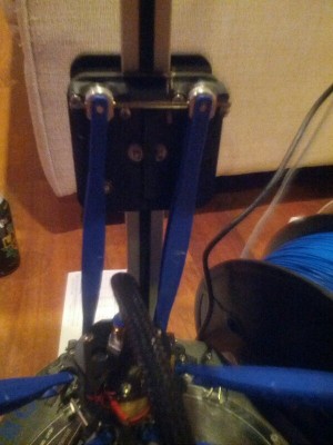

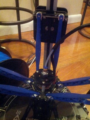

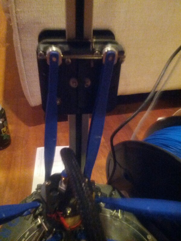

Just managed to recalibrate this guy to work properly and the model sizes seem ok, but all the recent stuff I've printed could have been off to begin with. Anyway, I'm at a loss as to what's happening here (Pictures Attached). At Y60 the leg lines up perfectly, at X60 it doesn't line up and at X-60 Y-60 it also doesn't line up to the post. What causes this, how do I fix it and does this affect prints? Thanks!

Look at your printer straight on from the LCD display side. Only the rear post (Y) is "straight" on the Y axis. The front two posts are not directly on an axis, but are 120 degrees offset. Therefore, if you send the printer to "Yxx X0", it will line up with the rear upright. But if you send it to "Y0 Xnn" it will not be inline with any other upright.
So, try these:
- Rear post (Z5...)
G0 Z5 X0 Y90 F3500
- Right post
G0 Z5 X-77.94 Y-45 F3500
- Left post

I think I've been inhaling too many plastic fumes. Thanks, worked like a charm.
EDIT: I think sometimes you get so involved in looking at a problem a certain way that basic logic goes out the door... :D
