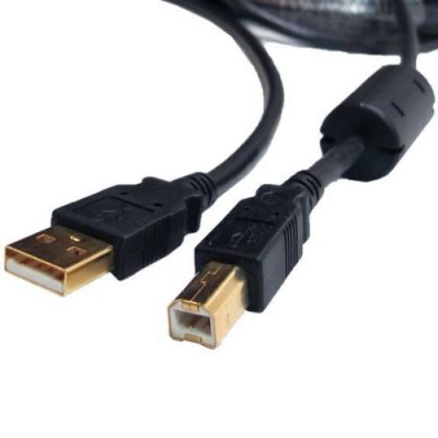

Another idea would be to get a USB cable with a ferrite bead, which is visible as a round plastic casing near the square end of the cable: Your USB cable probably has one of these already, but make sure. There is a lot of EM activity from a functioning Rostock, especially the heated bed when it's maintaining temperature by rapidly switching on and off. If you put a neodymium magnet on the Onyx when it's up to temperature, it will dance around!

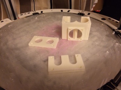

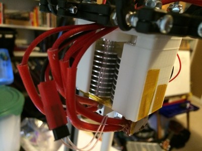

I got a second E3D for Christmas and have just got it set up to print.  I've printed the bottom few layers of a calibration cube using ABS for perimeters and HIPS for infill.  I only printed a few layers because I was extruding too much on tool changes.
I designed my own mount for it which seems to be working well so far. Here are a couple pictures:
I'll post the FreeCAD file and .stl files when I get to my computer if anyone's interested.

Could you post a picture of the front of your dual mount? I am really interested in it but would like to see the front while it is mounted.dpmacri wrote:I got a second E3D for Christmas and have just got it set up to print. I've printed the bottom few layers of a calibration cube using ABS for perimeters and HIPS for infill. I only printed a few layers because I was extruding too much on tool changes.

I added it to the Thingiverse page. Here it is as well:Eaglezsoar wrote:Could you post a picture of the front of your dual mount? I am really interested in it but would like to see the front while it is mounted.dpmacri wrote:I got a second E3D for Christmas and have just got it set up to print. I've printed the bottom few layers of a calibration cube using ABS for perimeters and HIPS for infill. I only printed a few layers because I was extruding too much on tool changes.

dpmacri, you haven't experienced any cooling problems with replacing the E3D coolers with that one fan in the rear?
						Re: Problems with printer after "upgrading"
No, I haven't -- but I haven't used the printer much since the modification. I took some thermocouple measurements with both hot-ends heated to about 240C and the temperature on the lower fin of the E3D was only like 70C I think. I'll take another measurement as soon as the print I'm doing finishes.Eaglezsoar wrote:dpmacri, you haven't experienced any cooling problems with replacing the E3D coolers with that one fan in the rear?
Thank you, that was my major concern with eliminating the separate cooling fans on the E3D. You indicate that lower fin was 70C and I am not sure what the temperature runs withdpmacri wrote:No, I haven't -- but I haven't used the printer much since the modification. I took some thermocouple measurements with both hot-ends heated to about 240C and the temperature on the lower fin of the E3D was only like 70C I think. I'll take another measurement as soon as the print I'm doing finishes.Eaglezsoar wrote:dpmacri, you haven't experienced any cooling problems with replacing the E3D coolers with that one fan in the rear?
the normal E3d fan is in place. (mine is not working at this time or I would measure it). Perhaps someone running an E3D with the supplied shroud and fan could take a temperature
of the lower fin while it is printing something in the 240C range.

Yeah, you're right. When I designed this, I was thinking it could sit on top of the platform which is why I squeezed the 30mm fan where I did. After I built it I realized that the print heads are so close to the cooling fins that there's no room from them to fit inside the platformbubbasnow wrote:this box does look big enough to be modified for a bigger fan also.. no reason to have all that wasted space fan side!
I think a modification to use two 30mm fans (or 40mm if they would fit) would be great and would definitely help with the cooling of the E3Ds. Do you have any plans on redesigning this?dpmacri wrote:Yeah, you're right. When I designed this, I was thinking it could sit on top of the platform which is why I squeezed the 30mm fan where I did. After I built it I realized that the print heads are so close to the cooling fins that there's no room from them to fit inside the platformbubbasnow wrote:this box does look big enough to be modified for a bigger fan also.. no reason to have all that wasted space fan side!. It could easily be modified to have a 40mm fan or just two 30mm.
I just did some measurements with both hot-ends set to 250c. The hottest I was able to get my thermocouple was 40c on the underside of one of the cooling fins. So I have no plans to redesign this. However, since you've given me so much support on these forums, if there's a specific modification you'd like, Eaglezsoar, I'll happily do it for you.Eaglezsoar wrote:I think a modification to use two 30mm fans (or 40mm if they would fit) would be great and would definitely help with the cooling of the E3Ds. Do you have any plans on redesigning this?dpmacri wrote:Yeah, you're right. When I designed this, I was thinking it could sit on top of the platform which is why I squeezed the 30mm fan where I did. After I built it I realized that the print heads are so close to the cooling fins that there's no room from them to fit inside the platformbubbasnow wrote:this box does look big enough to be modified for a bigger fan also.. no reason to have all that wasted space fan side!. It could easily be modified to have a 40mm fan or just two 30mm.
If that's all the temperature is on the lower fins then it doesn't need redesigned but I appreciate your willingness to do so and your kind words.  I'm going to print it out and keep it until I am ready to use it on one of my RMAXs.
