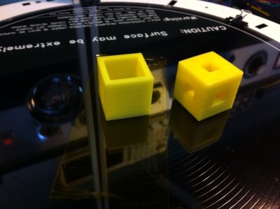

Well, I got my Rmax in december. And this cute little thing is printing and printing like there's no tomorrow. :-)

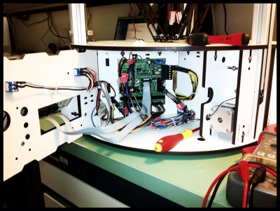

I made some changes in order to use it withdual extruders. One thing that I made can be found here: http://www.thingiverse.com/thing:214536. It is a dual extruder mount with integrated cooling. Some more changes have been made in the repetier FW (still 0.83). Dual extrusion works fine now. Setting it up was quite challenging - at least the mechanical part, the adaption of the FW was rather easy.
Reading this forum helped me a lot when assembling my Rmax. So, if you have questions about how I got rid of all the little flaws when getting dual extrusion up and running - feel free to ask. :-)

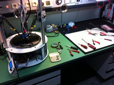

My Rmax is built for reproducing 3D Data that we get out of our micro x-ray CT (I'm running a lab for non-destructive material testing over here). Initially we thought about buying a rady-to-run 3D printer. Then again, we build lots of our testing equipment ourselves, and that's why I finally ordered one white Rmax kit.

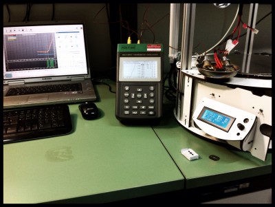

- A 600W glass-ceramic heated bed with plished surface (no more warping, no boro glass, and heating up to 120C in less than 3min.
- A new version of the extruder mount with integrated PLA cooling fan (maybe with integrated effector plate - we will see).
- Integration of our auto-leveling probe that we normally use with our mechanical test rigs (IR laser-based - no need of flipping out/in a micro-switch). *
- Mechanical end stops out, HAL sensors in (should be done this evenning).
*One secondary use of that probe is that we can detect failed prints (lots of ABS/PLA wool, loose objects, stalling of the effector, etc.). The NCs of our test rigs are based on ATMEL MCs. Therefore the proting of the software should be no problem.

In our Lab we always have to be efficient and precise. A clean working area and the adequate patience are important cornerstones in every project. My experience with 3D printers (or with mechanical engineering in general) in brief: Precision in = precision out. In other words: you will never get back all the lifetime you have spent with searching for lost scredrivers. :-)
