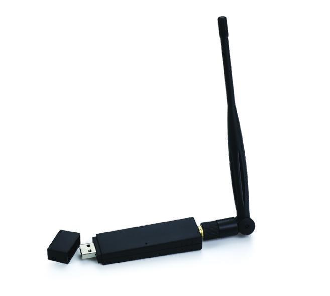

Hi guys, sorry for my ignorance, but would it be possible to use a USB WIFI Adapter to connect with the printer??
One like this maybe:
Martín S.
Re: USB Wi-Fi?
I don't think that would be possible. The RAMBo isn't like a USB host, it's like a device. So you can't plug an antenna like that into it (notice that the cable you used to connect the RAMBo to your computer has a USB Standard Type-A plug (like the one in the picture) for connecting to your computer but a Type-B plug for connecting to the RAMBo. Those plugs were specifically designed to enforce the topology os USB: there's a "host device" and a "target device". You can't reverse the cable. Similarly, you can't expect a target device to be able to play host to another USB target device (which is what the Wifi antenna would be).

Hello, yes... I had little faith, there was nothing similar in the forum =/
I don't want to print from another location, but I would like to put my printer on another room, like 10m away from my computer.
Is it posible to use a cable that long?

The cheapest way to get what you want is to run Octoprint on a Rasberry Pi that's equipped with a WiFi adapter.
