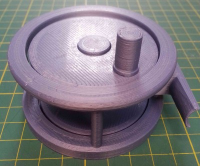

I've been working on this project for about a year. The goal: Print a working fly reel with no other hardware requirements. Originally, I was trying to not have to use glue either but now that I've made a number of prototypes, I think glue is necessary to get the strength needed and it isn't that big of a hassle. Here are some photos of the three part frame and foot assembly
[img]http://mhackney.zenfolio.com/img/s10/v1 ... 3207-3.jpg[/img]
[img]http://mhackney.zenfolio.com/img/s5/v13 ... 2722-3.jpg[/img]
I have a few tweaks to make to finish it off and then I'll post the STLs on Thingiverse.

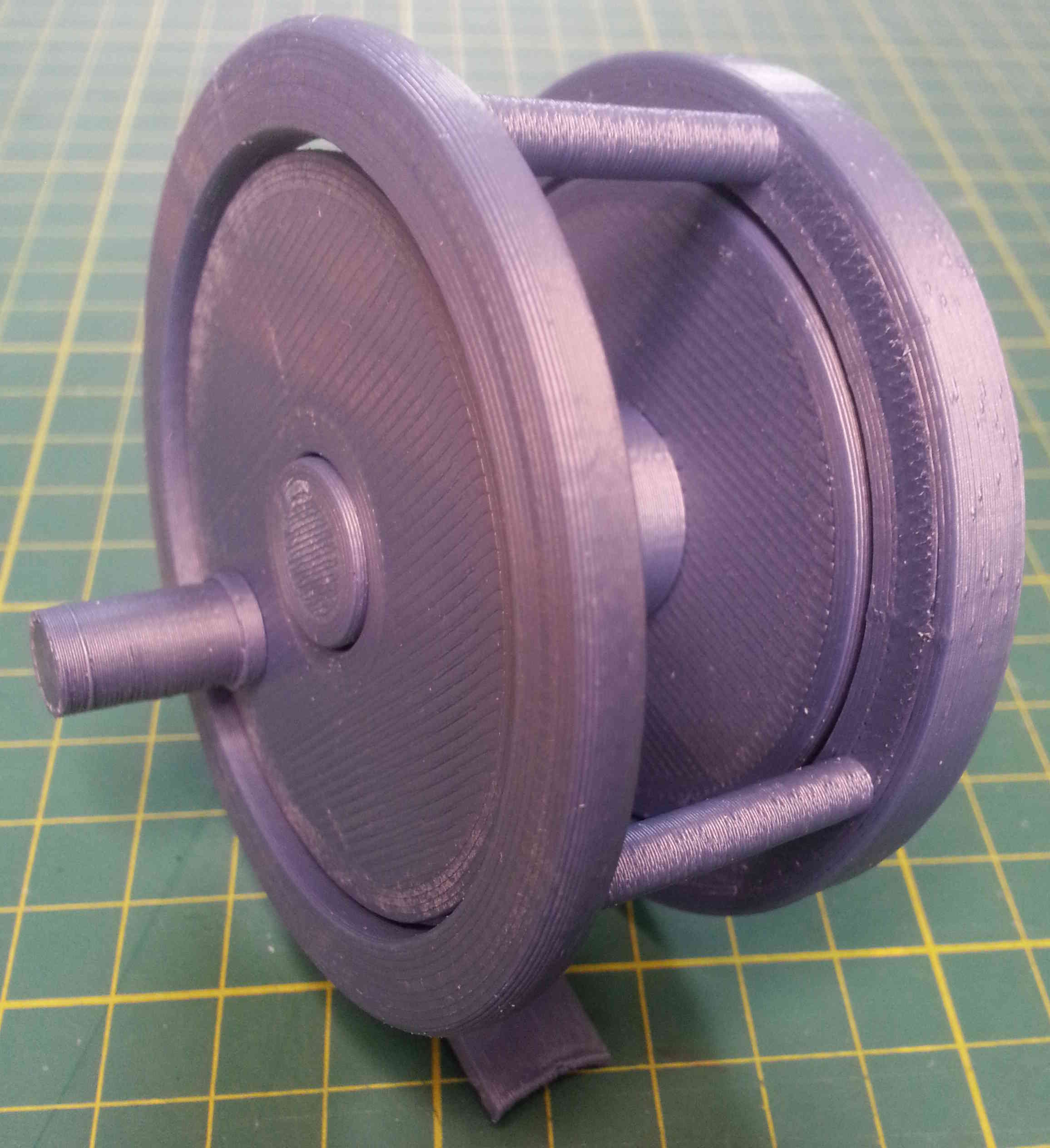

8 Parts, no other hardware:
[img]http://mhackney.zenfolio.com/img/s5/v11 ... 4524-3.jpg[/img]
(The handle has the spindle already inserted in it.)

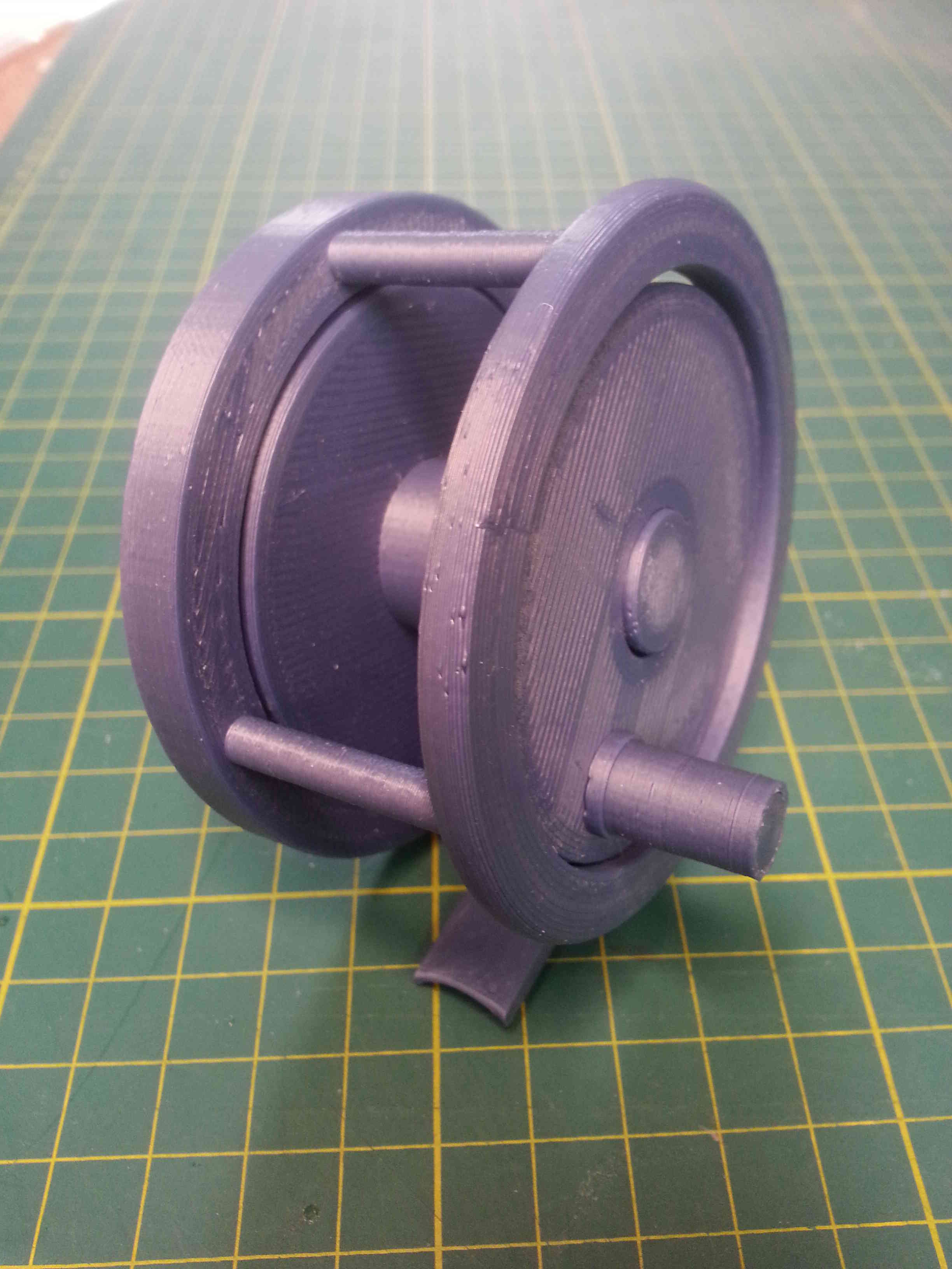

Assembled reel:
[img]http://mhackney.zenfolio.com/img/s5/v12 ... 6544-3.jpg[/img]
[img]http://mhackney.zenfolio.com/img/s5/v12 ... 9982-3.jpg[/img]
[img]http://mhackney.zenfolio.com/img/s9/v96 ... 5104-3.jpg[/img]
[img]http://mhackney.zenfolio.com/img/s3/v24 ... 3351-3.jpg[/img]
After printing, a little cleanup of the various holes with drills and some sanding on the central spindle and part edges is required. Then, the reel is glued together with ABS glue, Epoxy or CA glue.
