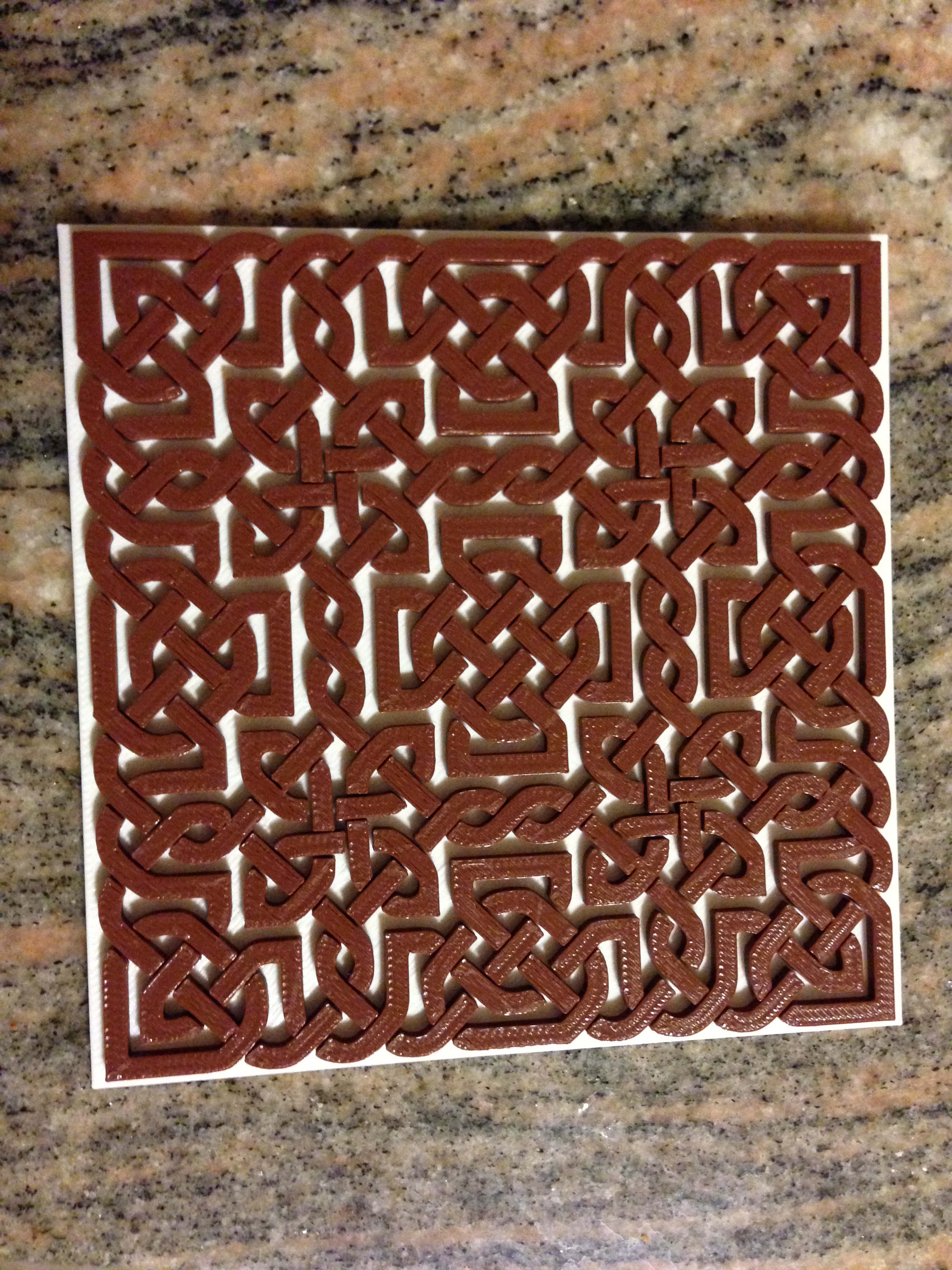

jmpreuss
Posts: 182
Re: printing text on parts
Post by jmpreuss »
Celtic Knot font
wildideas1
Posts: 99
Joined: Wed Jun 06, 2012 3:59 pm
Post by wildideas1 »
I forgot to ask how are you doing the set up to print. they look darn cool.
I agree with wildideas1 and would like to know how you do it.
Especially the raised text.

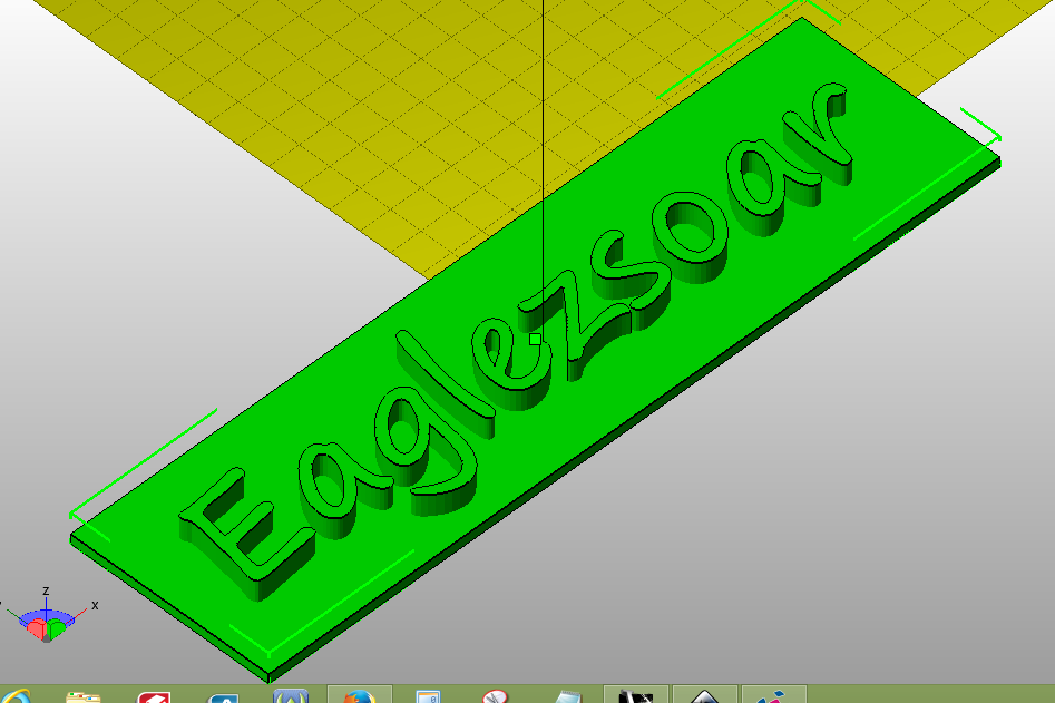

I've found that generating text in "Inkscape" and exporting it to SCAD with that path converter works really well. I made this name plate in about five minutes :D
I added the back plate in Inventor Fusion.
Eaglezsoar2.stl
(1003.13 KiB) Downloaded 375 times
No guarantees on how it will print ;)
