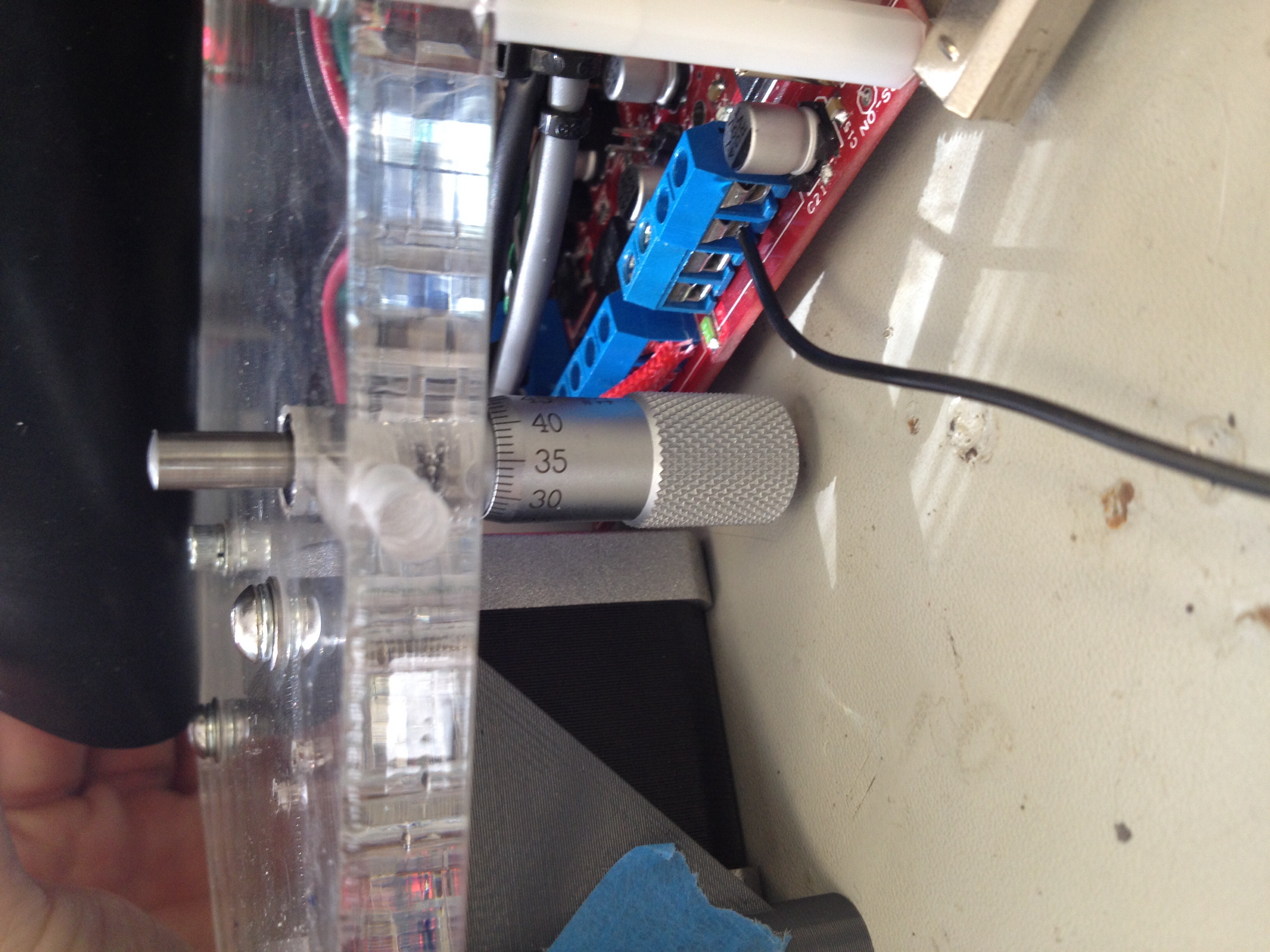

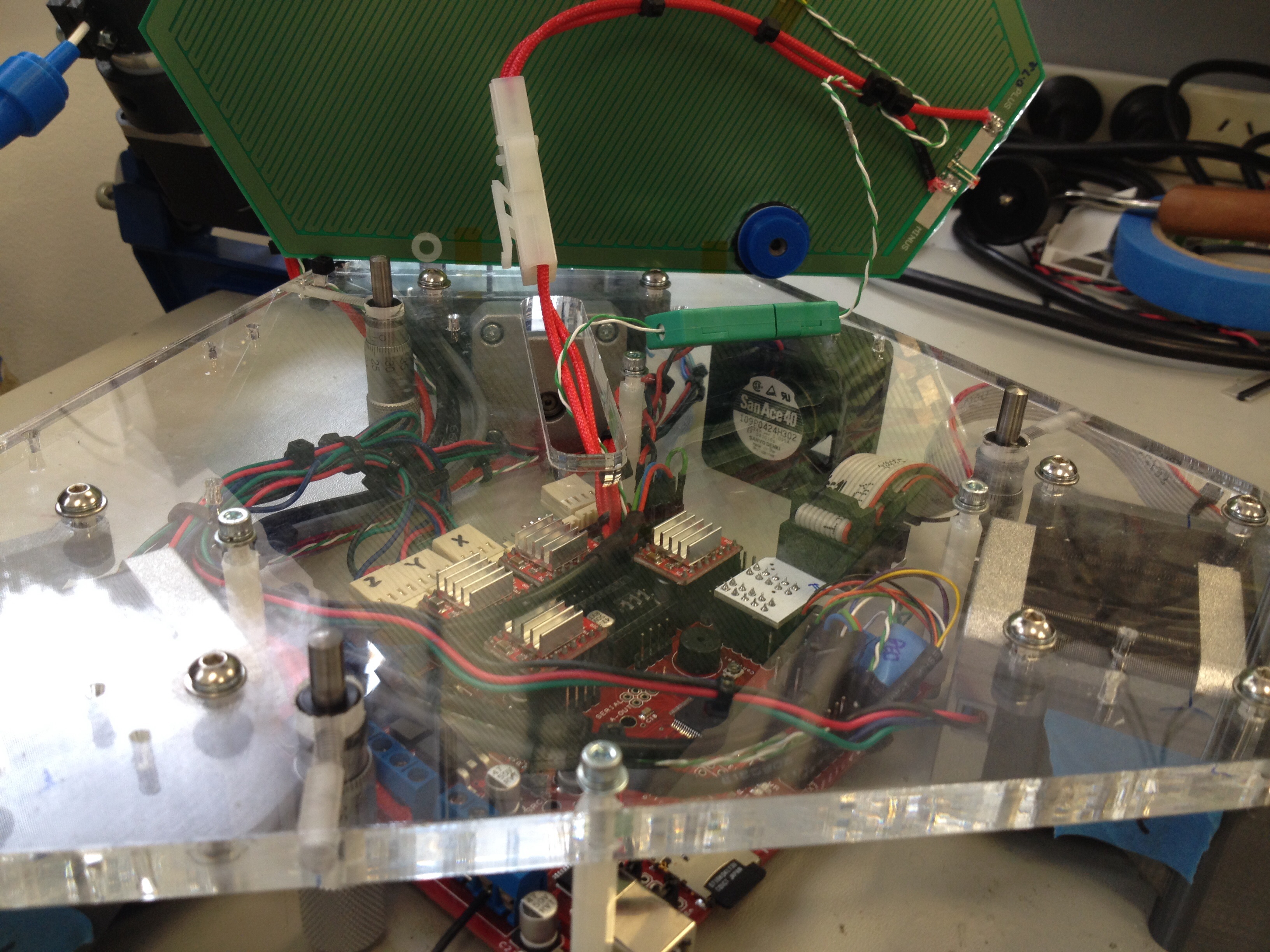

The micrometers are off some XYZ linear stages which we have a ton of after automating some jigs.
I drilled a (just) clearance hole in the base plate and a side locking screw (and clearance bore to get the M3 tap in) in the end of the plate, one on each of the three long sides of the Rostock Mini base platform. I had to offset them to fit my aluminium PCB heat bed and clear the steppers and their mounts. I've got a piece of PVC (I think) rubber sheet cut to fit that acts as a thermal break.
On the bottom of the PCB, you can see some blue ABS magnet holders, which are high-temp-tolerant glued to the PCB.
The magnets are neodymium and have a centre hole and this hole is countersunk. This and the minimal clearance on the blue ABS parts locate the micrometer shafts and prevent them from moving laterally.
I was expecting it to not work, but it works brilliantly!
Of course you only technically need 1 fixed and 2 moving points to level a plane but I am a sucker for symmetry.
If anyone would like a copy of the Altium (or any other format) source to make my PCB - send me a PM.
Jared

Re: Hello from New Zealand
Ok, now THAT's a leveling system! Well done!
haha thanks!
I can set pretty much exactly the same amount of bite of the nozzle tip onto a slip of paper at each of the tower positions.
Worked as well as I'd hoped.
