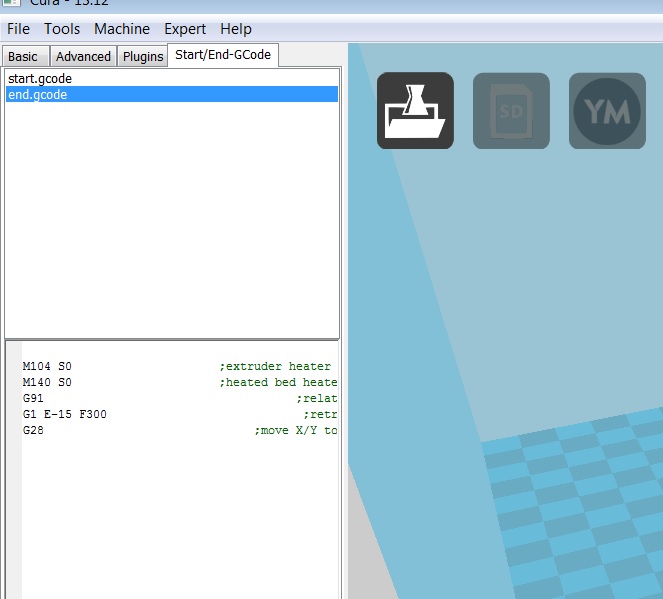

I had that same glitch with Cura generated files crashing into the finished print and ruining it. I just edited the "end" gcode to remove it. Mine looks like this now;

I did the same thing. The "park" command doesn't land the hot-end in a particularly good place.
It's because homing the machine goes to the MAX end-stops instead of the min, and because X0,Y0 is in the middle of the print instead of at the very bottom corner.

I had crash issue with Cura also. Edited my end code so G28 did not have any X or Y values.
Just G28
NOT G28 X0 Y0
Then Cura code works fine on my MAX.
