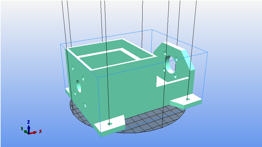

Here's a pic of what the object looks like on my screen, it was originally 5.43306 mm long but I scaled it up 25.4 in repetier so around 138mm after scale up if my math is correct, no brim or skirt applied yet lol

138 along one axis most likely means that the diagonal of your object is >150. E.g. let's say the *other* side is just 100mm long. Then the length of the diagonal = sqrt(138*138 + 100*100) = ~170. You'll probably find that if you move the object so that long end goes through the center of the circle that it will fit from one side to the other. But obviously the full object doesn't fit on the plate :-(

dpmacri wrote:But obviously the full object doesn't fit on the plate :-(
It fits on the physical glass boro plate just fine, there is a lot more room to be made use of, provided it doesn't mess anything up on my orion :/
It just doesn't fit on the 3d preview, which to my surprise was actually at the correct setting... so how do I do what mrbi11 did?

Well, you need to start with a circular object or one whose LONGEST dimension (e.g. the diagonal in the picture you showed) is 150mm or less. I haven't printed this (just whipped it up quickly in FreeCAD), but here's an .STL for a 140mm ring (outside diameter) with a 135mm inside diameter. It's 0.9mm high which should work nicely if you print with a 0.3mm first layer height and then 0.2mm layers after that (4 layers total).
