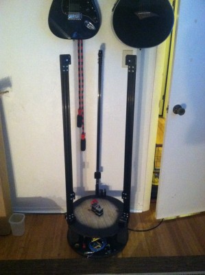

the linear height is 39.3inch(1000mm) while the round wooden base is 18in.
And i would love any suggestions if you guys have any.

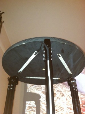

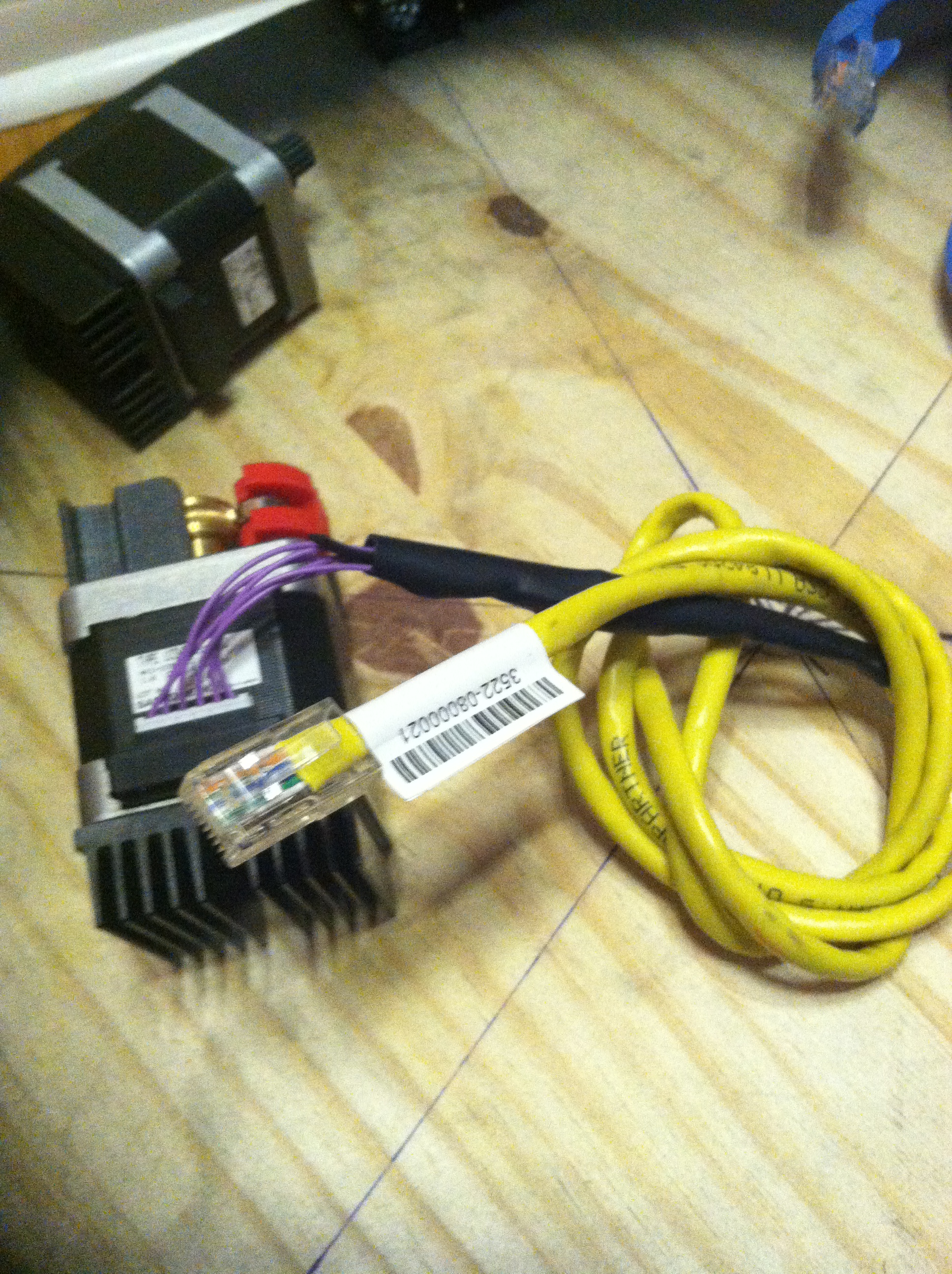

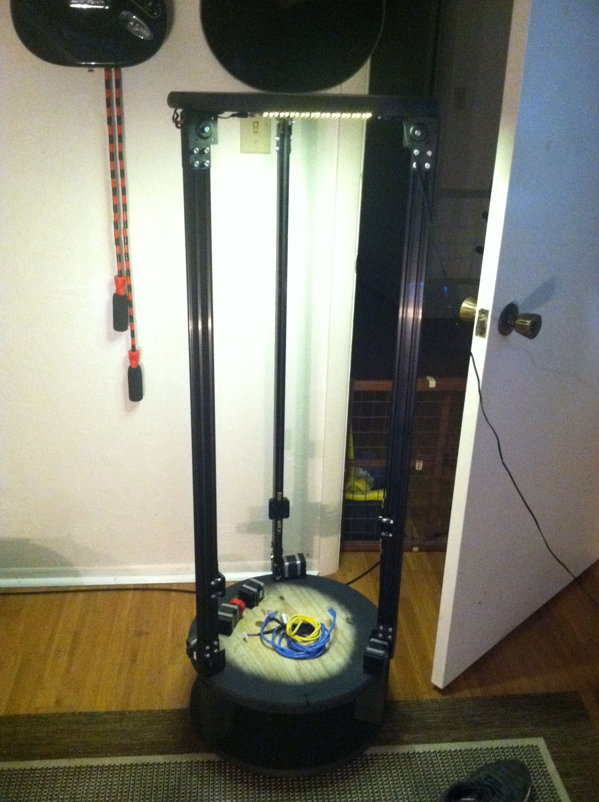

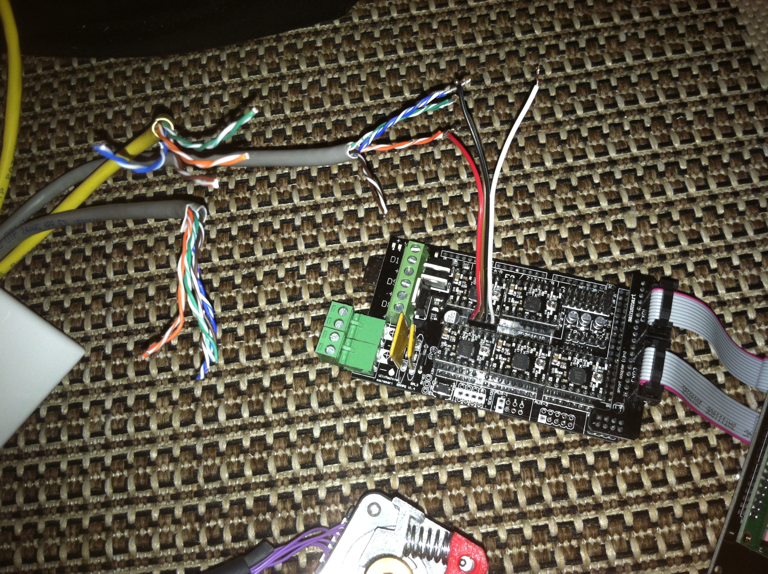

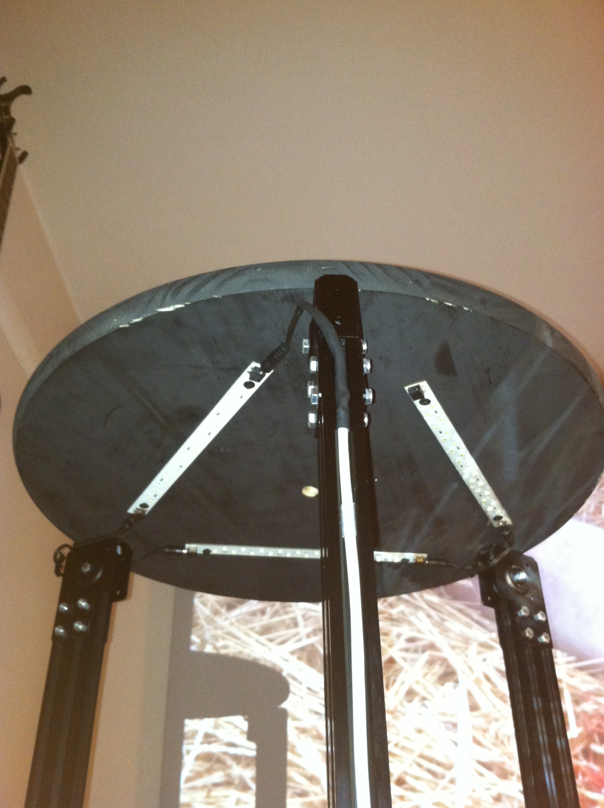

I got the top put on today, and some LED lighting.

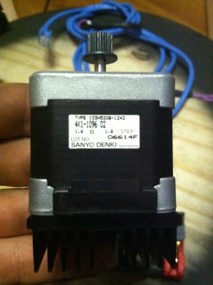

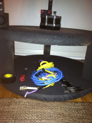

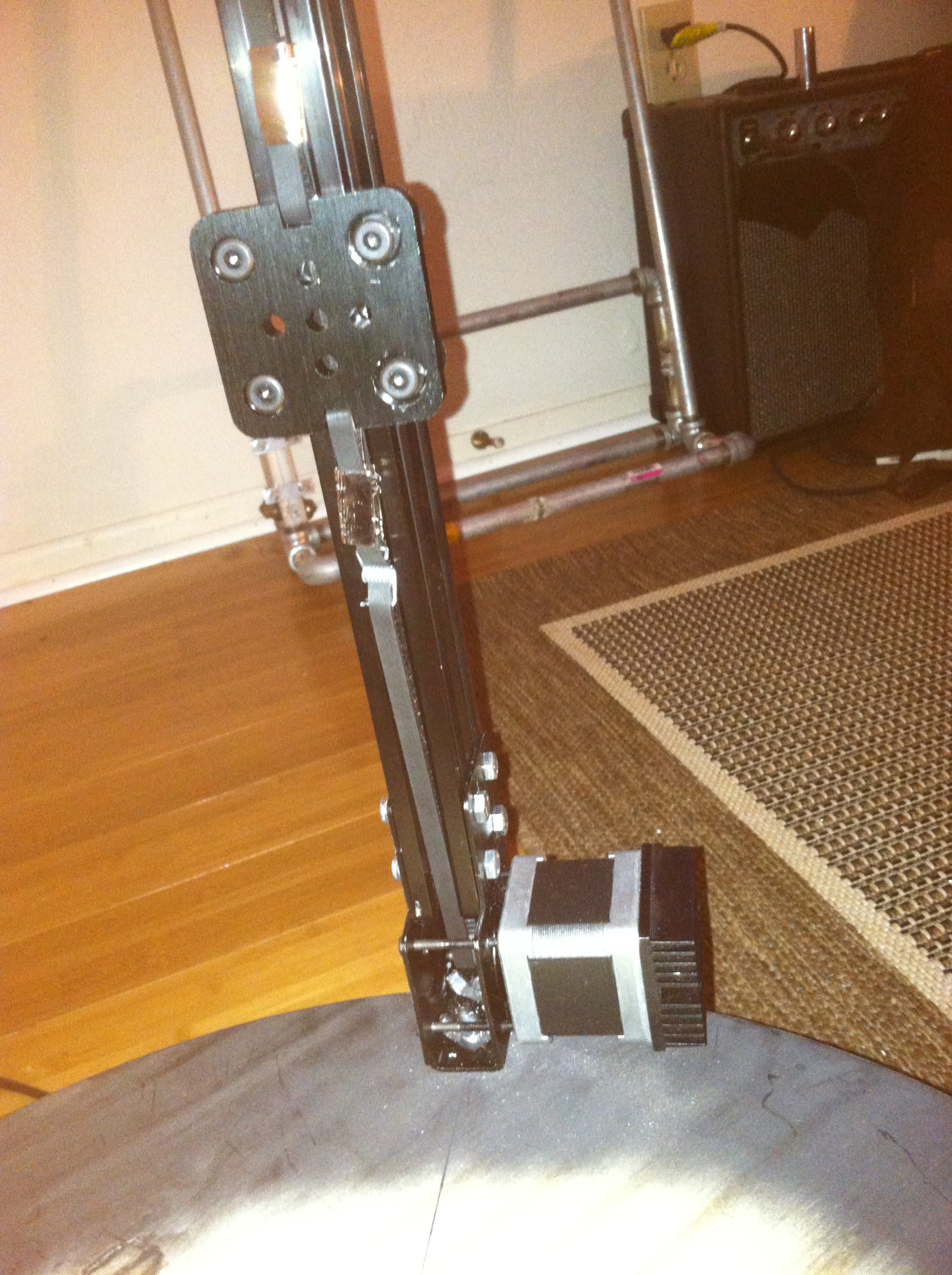

Here is the motor wired into a CAT5 cable. I plan on using the plugs as a quick disconnect.

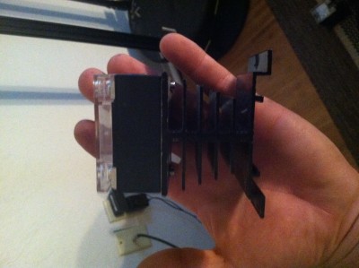

it has a 15 tooth pulley and a heatsink on the back.

Very cool idea with using the CAT5 as a disconnect cable!
Re: XL delta build

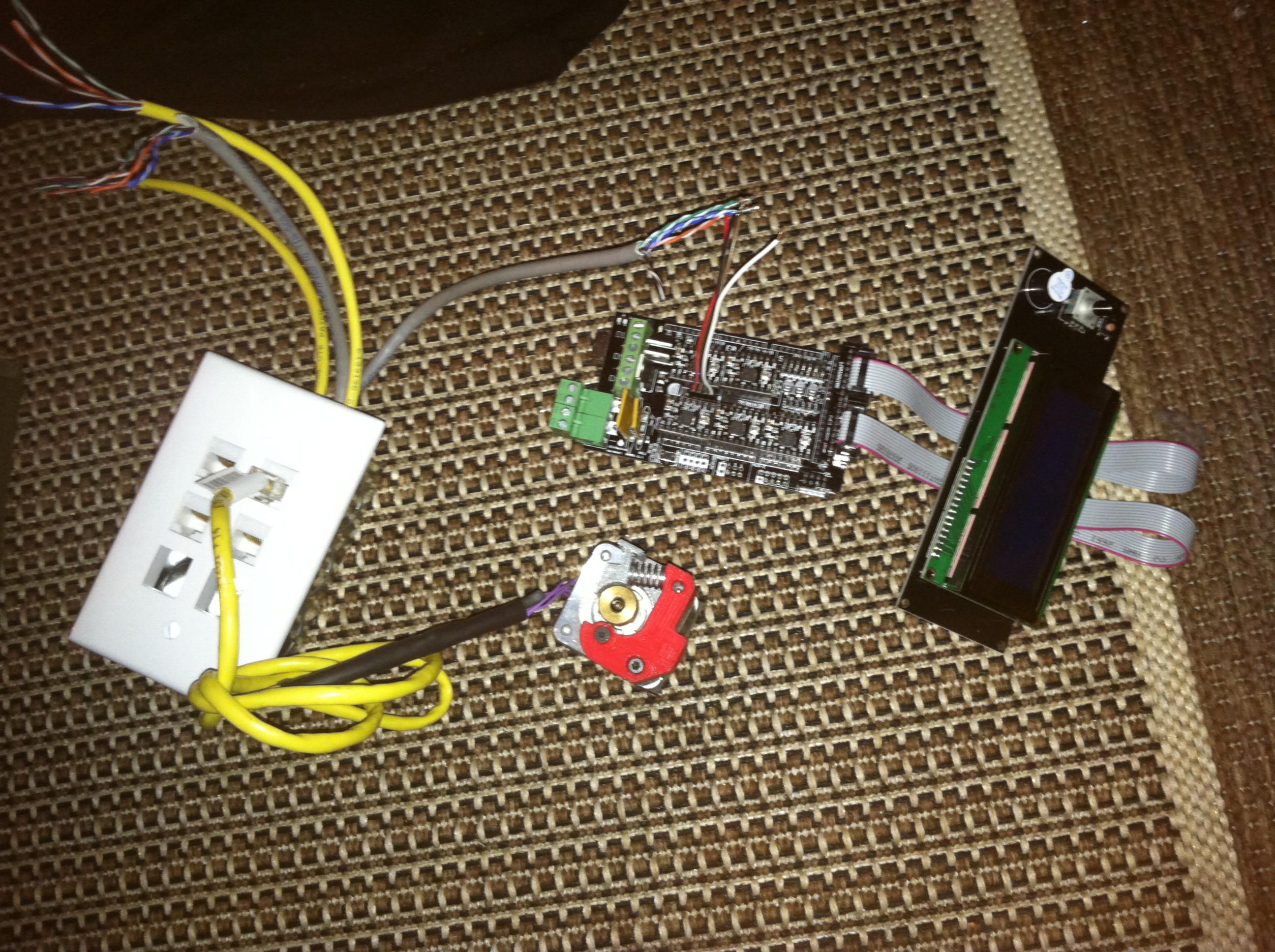

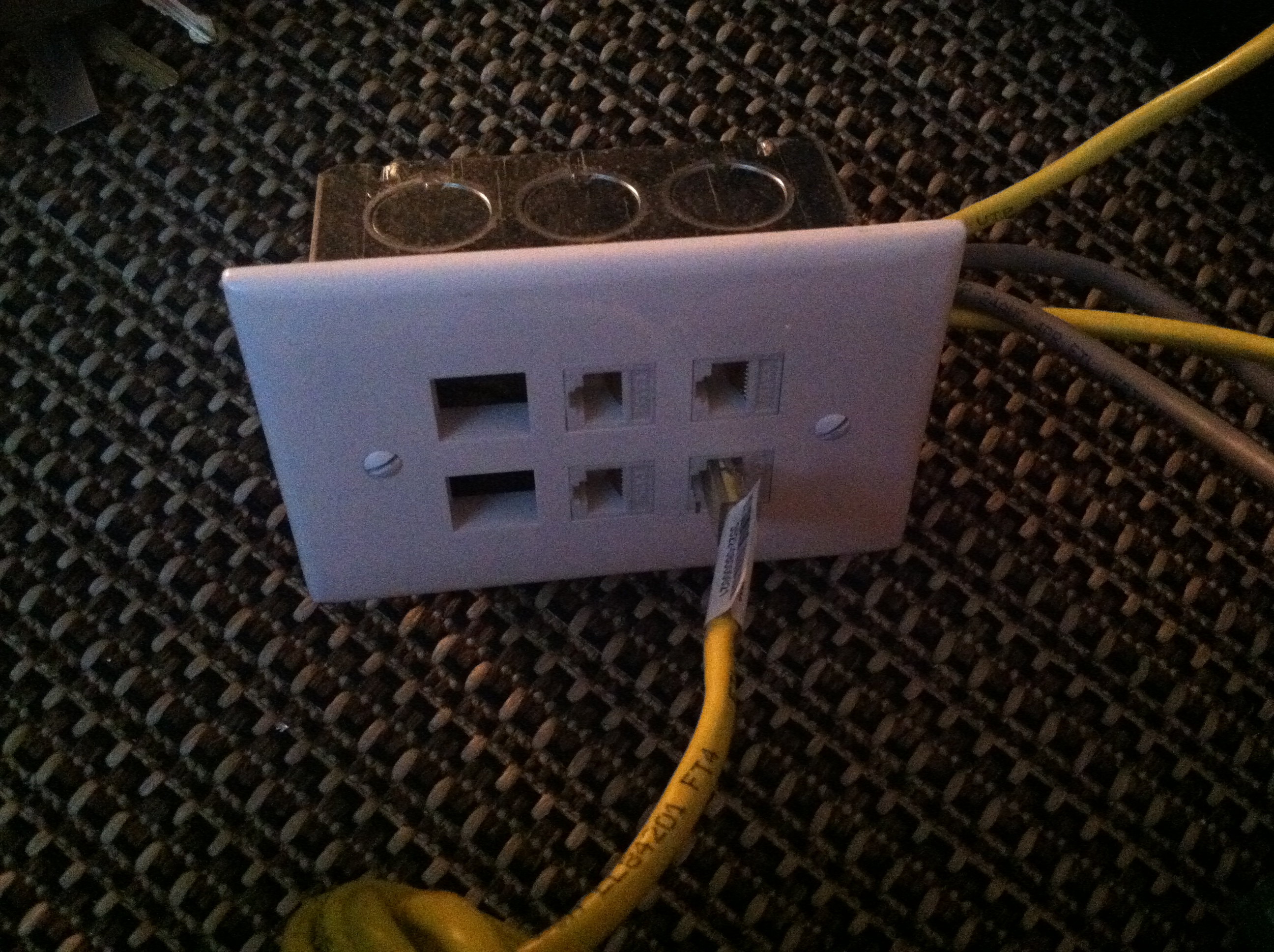

Are you running the Cat 5 cables into a small patch panel then into the controller card?
Re: XL delta build
That's how we do it on our home-brewed CNC mill and lathes. A couple of the breakout board and stepper driver vendors have started integrating the CAT5 connectors into their products. Damned convenient and a great idea to include on a 3D printer.
What is the base made of? It looks like black painted wood but hard to tell from the photos.
That's a monster of a machine! You could make some pretty amazing stuff on that. Looking forward to seeing it print.

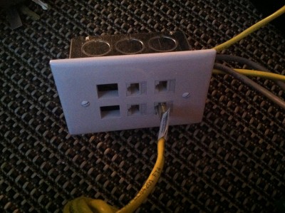

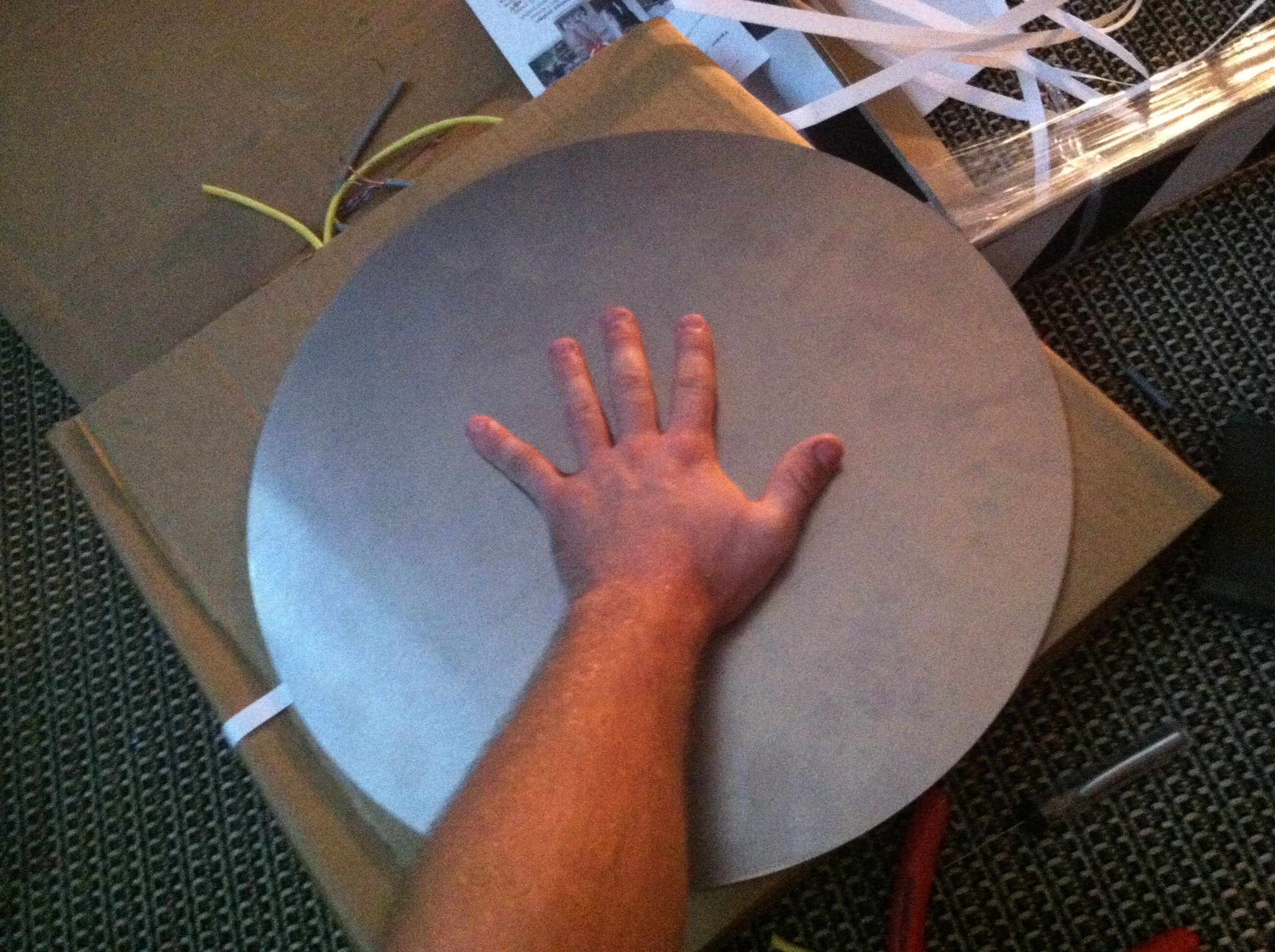

The top, heater plate and bottom are $5.00 table tops from Home Depot. 18 diameter.
I grabbed a outlet box and a 6slot cat cable plate. I cut the cable in half and soldered the pairs of like colors together. Eg) orange w/ orange and white. Then assigned each to either A+ A- B+ or B-.
I think it will be helpful as I'm building as I go.
It just spray painted too.

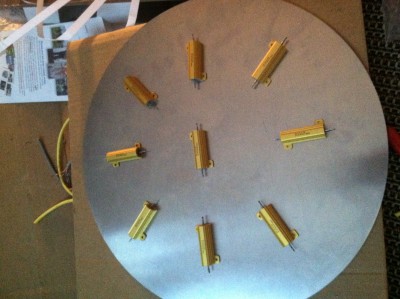

I'm going to be building a resistor based hot plate for it too.

Re: XL delta build
If you are using CAT5 as connections to your steppers, be careful as it is 24 gauge rated at .58A per conductor and the steppers draw a fair amount of current over that. I've seen folks double up the wires to the steppers since CAT5 has 8 conductors. That should work, perhaps you knew that already ;)
calibur2121
Posts: 12
Joined: Sun Feb 02, 2014 8:21 am
Re: XL delta build
Post by calibur2121 »
Yes, Mhacknet i doubled them up from the get go. though i was not sure if there was a need for it.

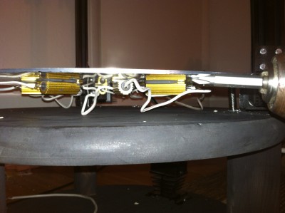

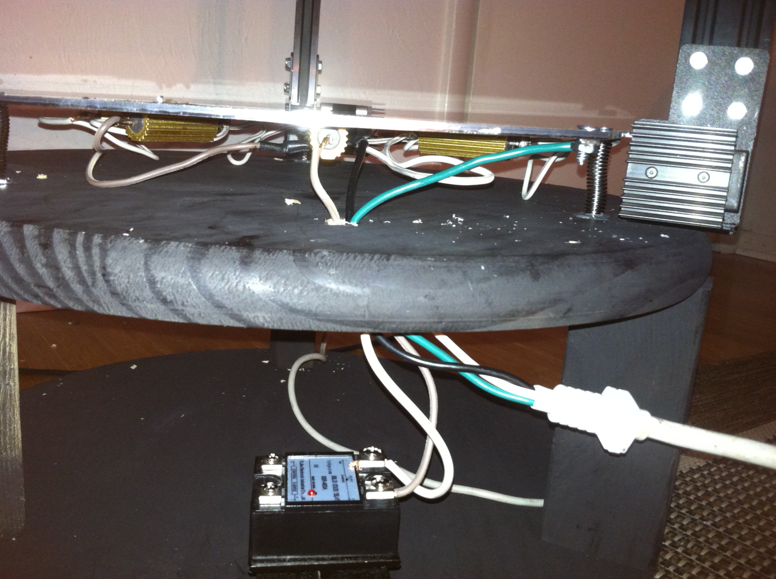

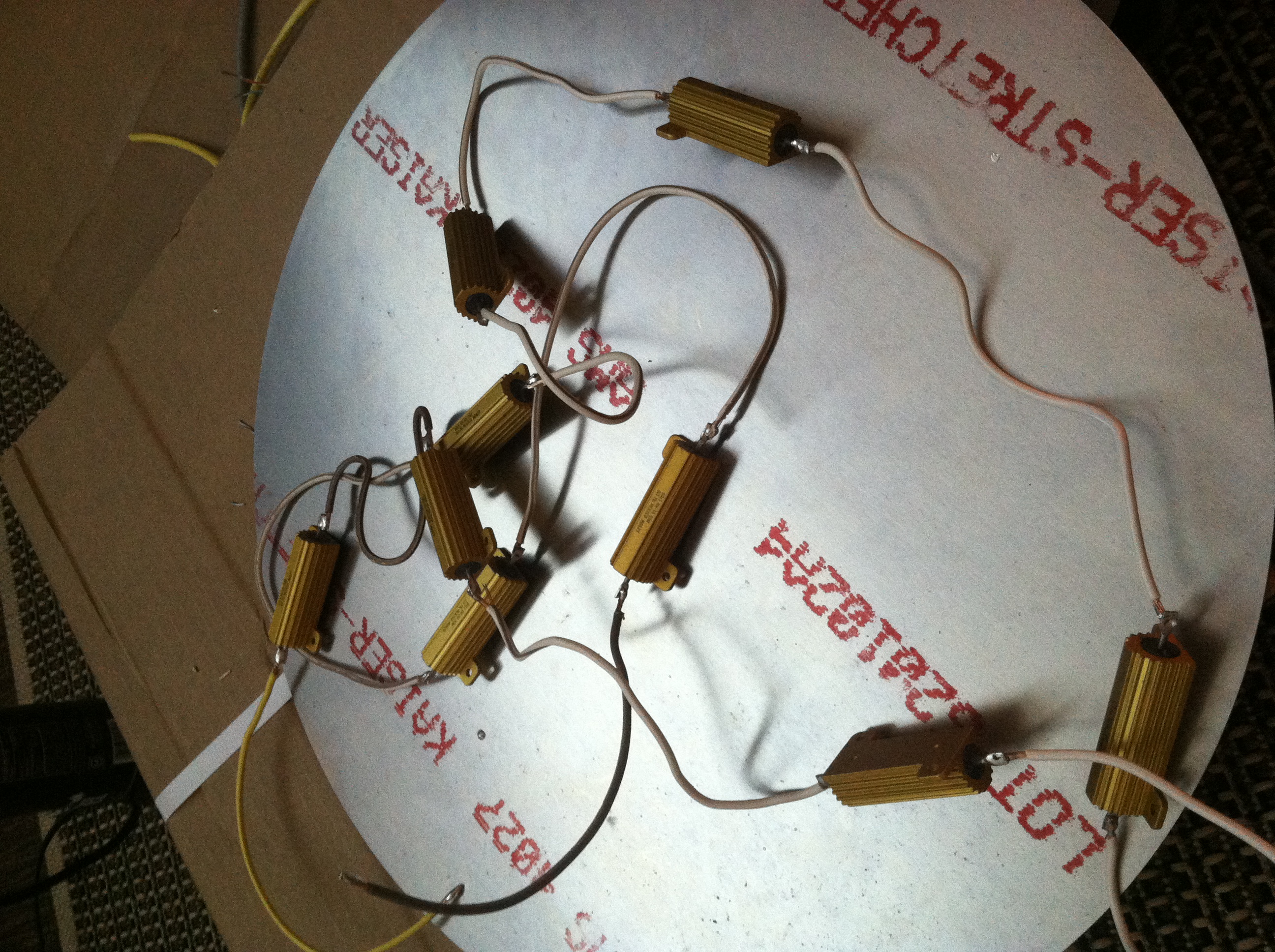

Home depot parts again
just a little perspective

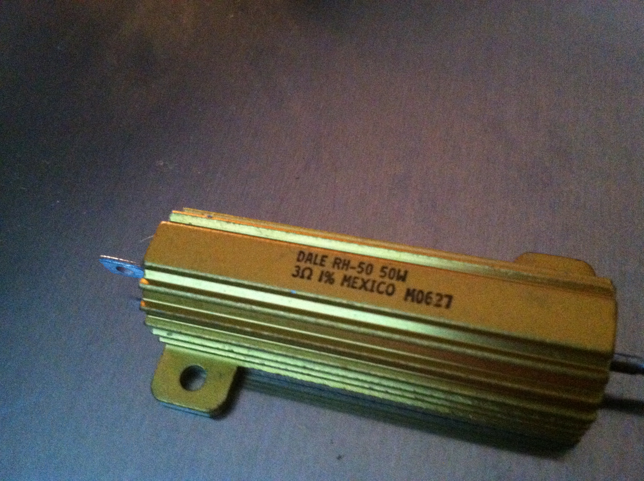

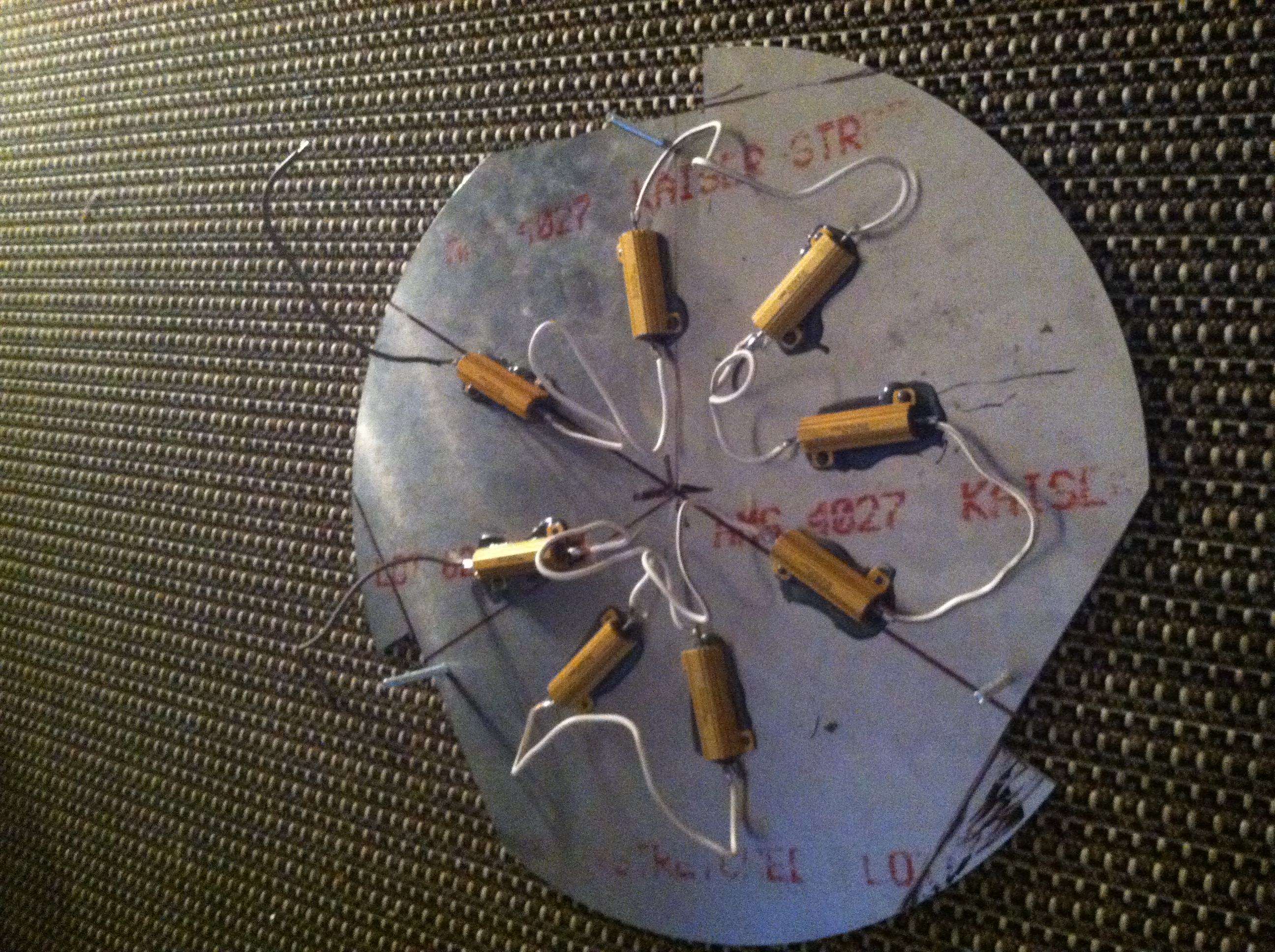

Basic layout of the resistors
resistor closeup
Wired up in series
I refer to this site for the resistor part of the build
http://eclecti.cc/hardware/ac-powered-h ... for-reprap
Re: XL delta build

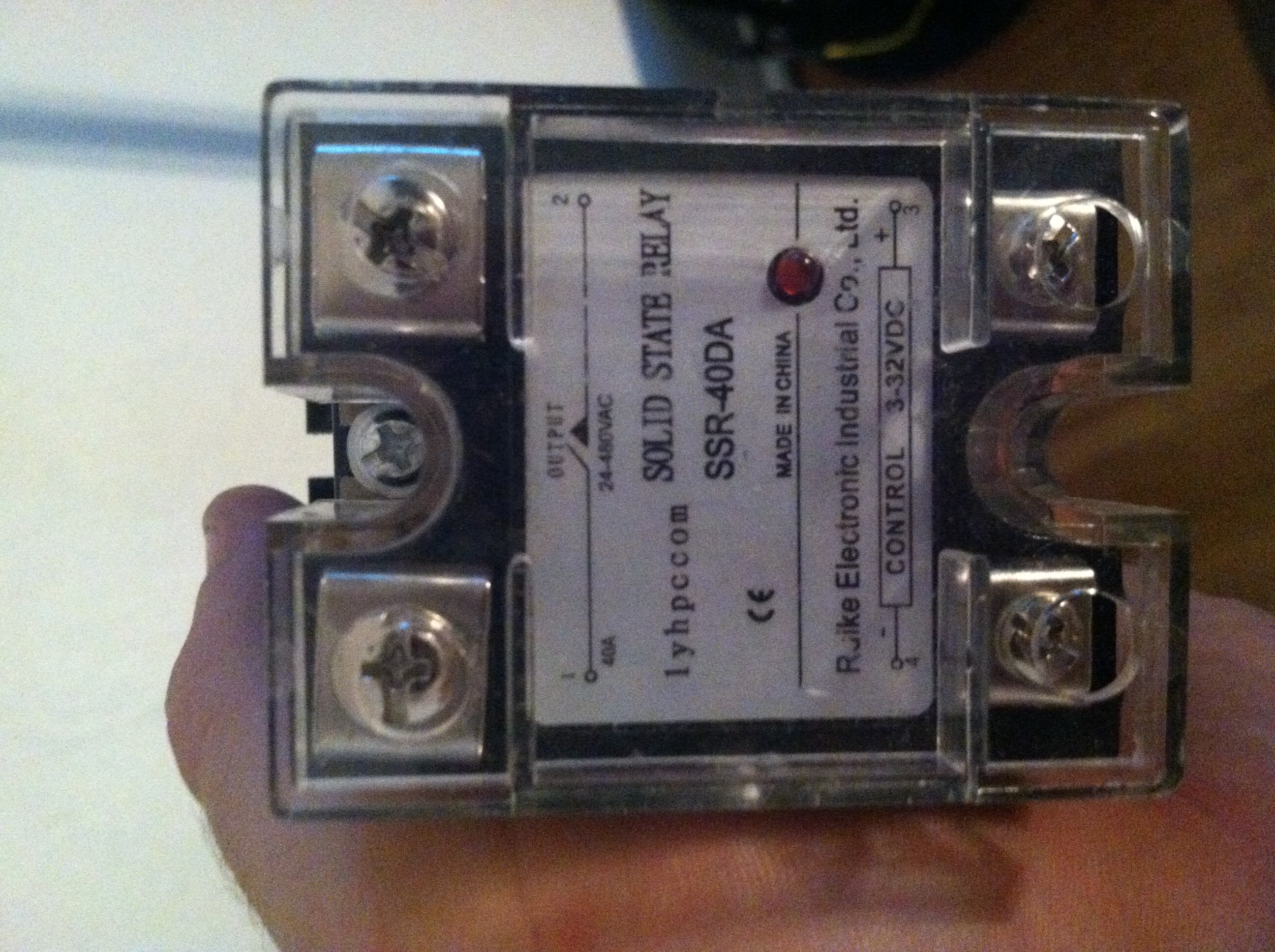

Please be careful, running that plate from the AC line can be deadly!
calibur2121
Posts: 12
Re: XL delta build
I'm going to put a gfi circuit on that line, and ground the plate to prevent shorts. I was wondering what you guys would use to insulate the bottom side of the hot plate? I was thinking truck bed liner?
Re: XL delta build
calibur2121 wrote:I'm going to put a gfi circuit on that line, and ground the plate to prevent shorts. I was wondering what you guys would use to insulate the bottom side of the hot plate? I was thinking truck bed liner?
Bed liner would probably melt, common fiberglass insulation has a melting point of 1300 degrees and that is what I would probably use.

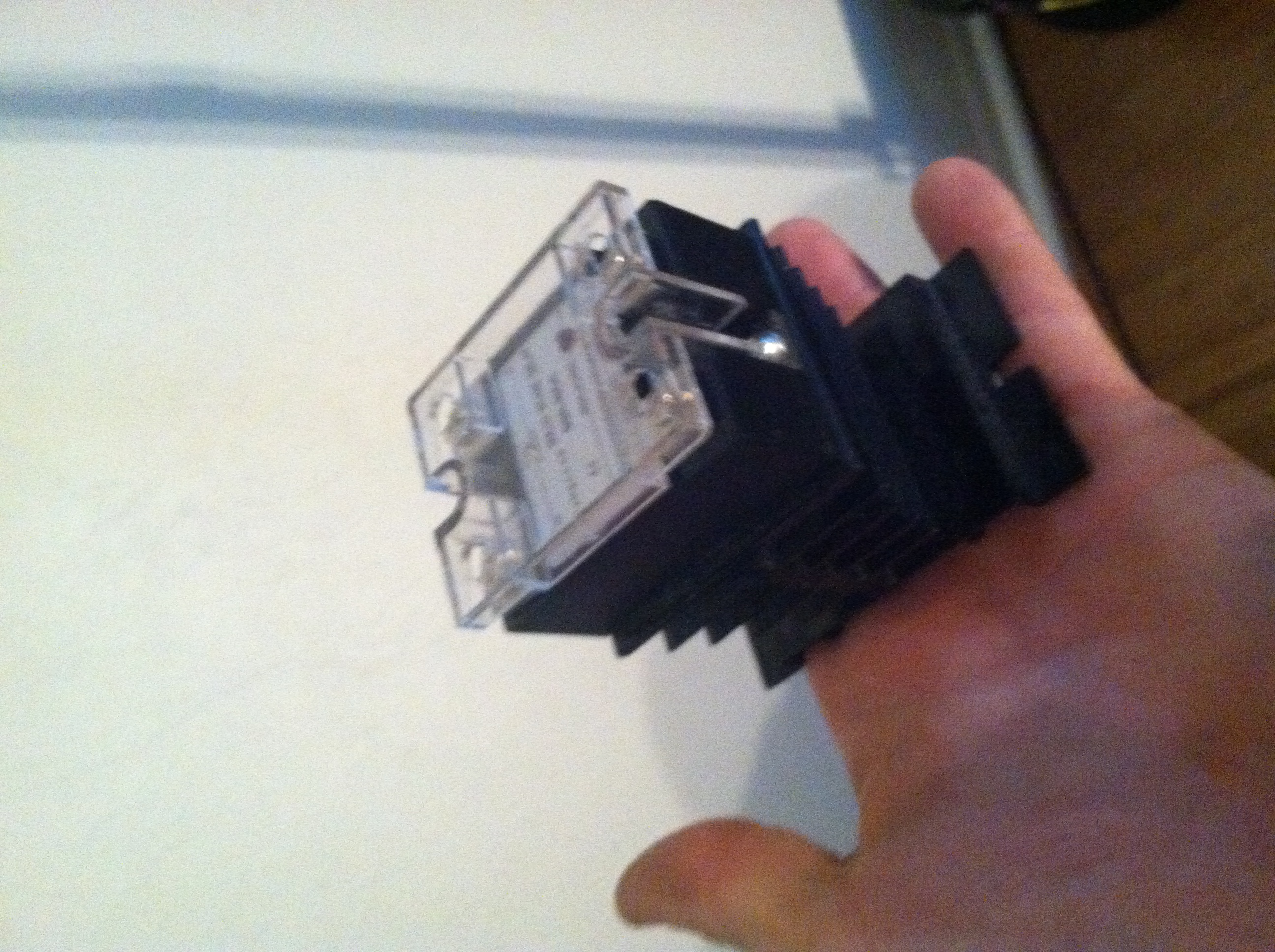

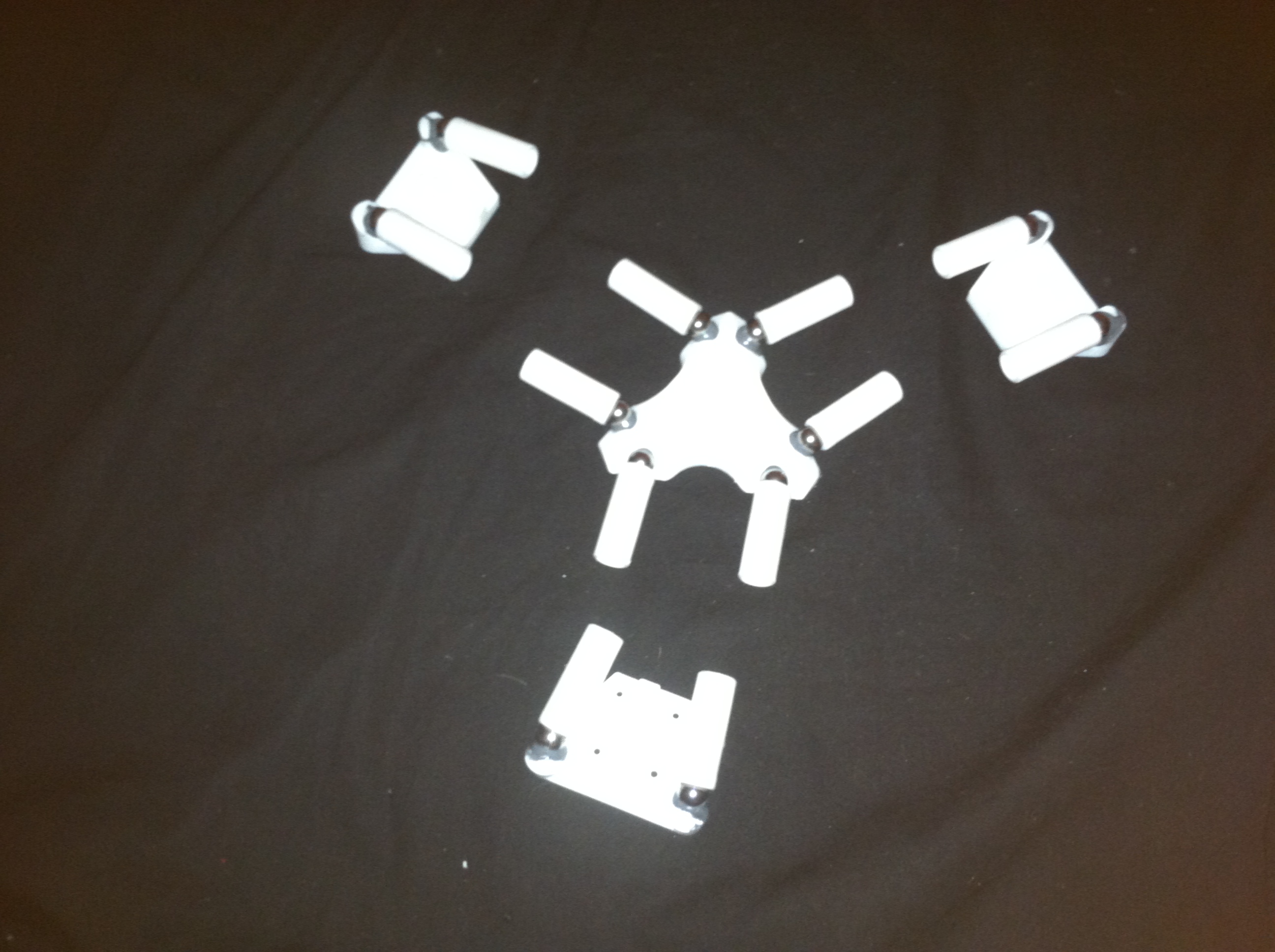

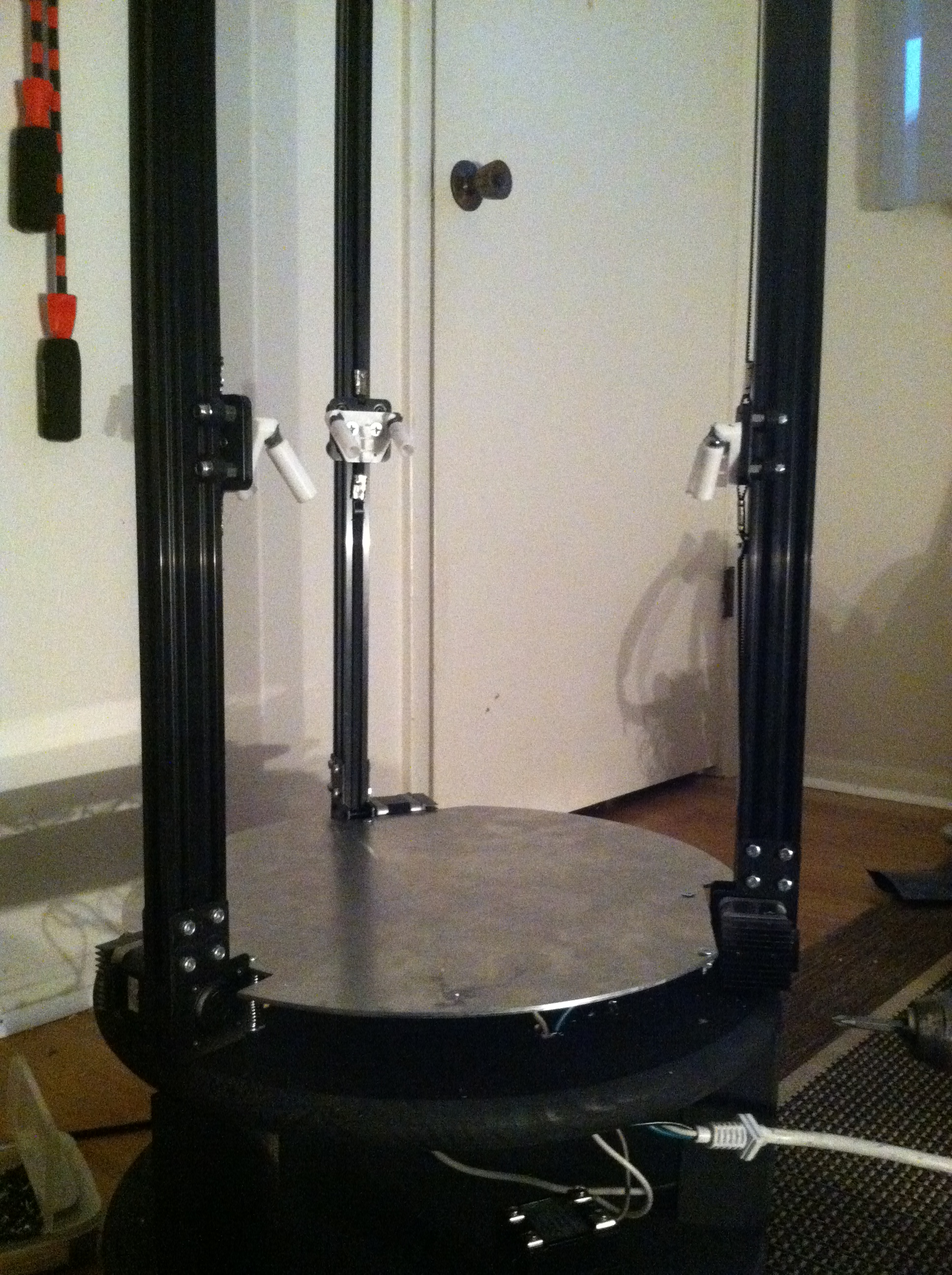

I received the eflector kit in the mail, a dab of JB weld

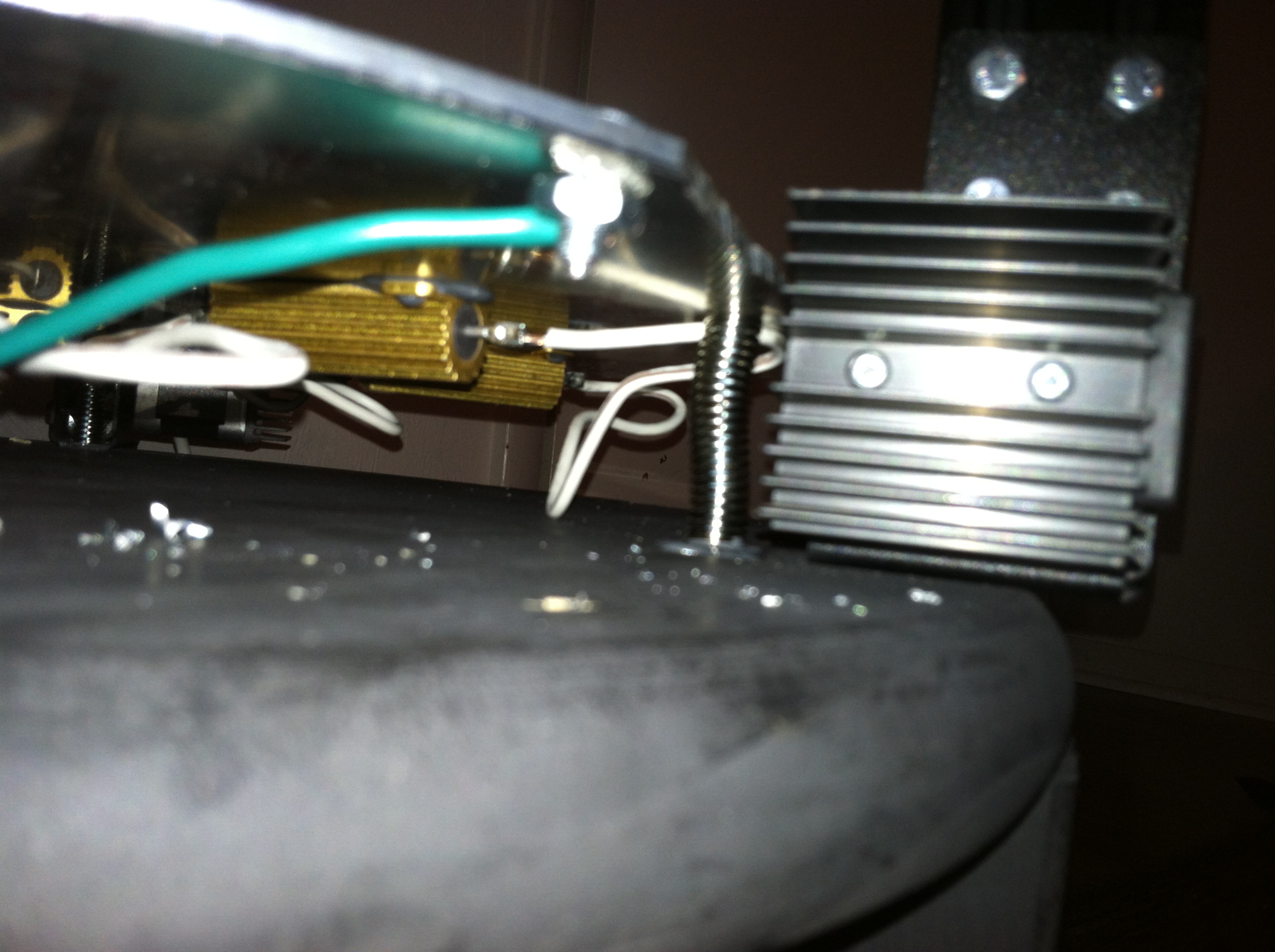

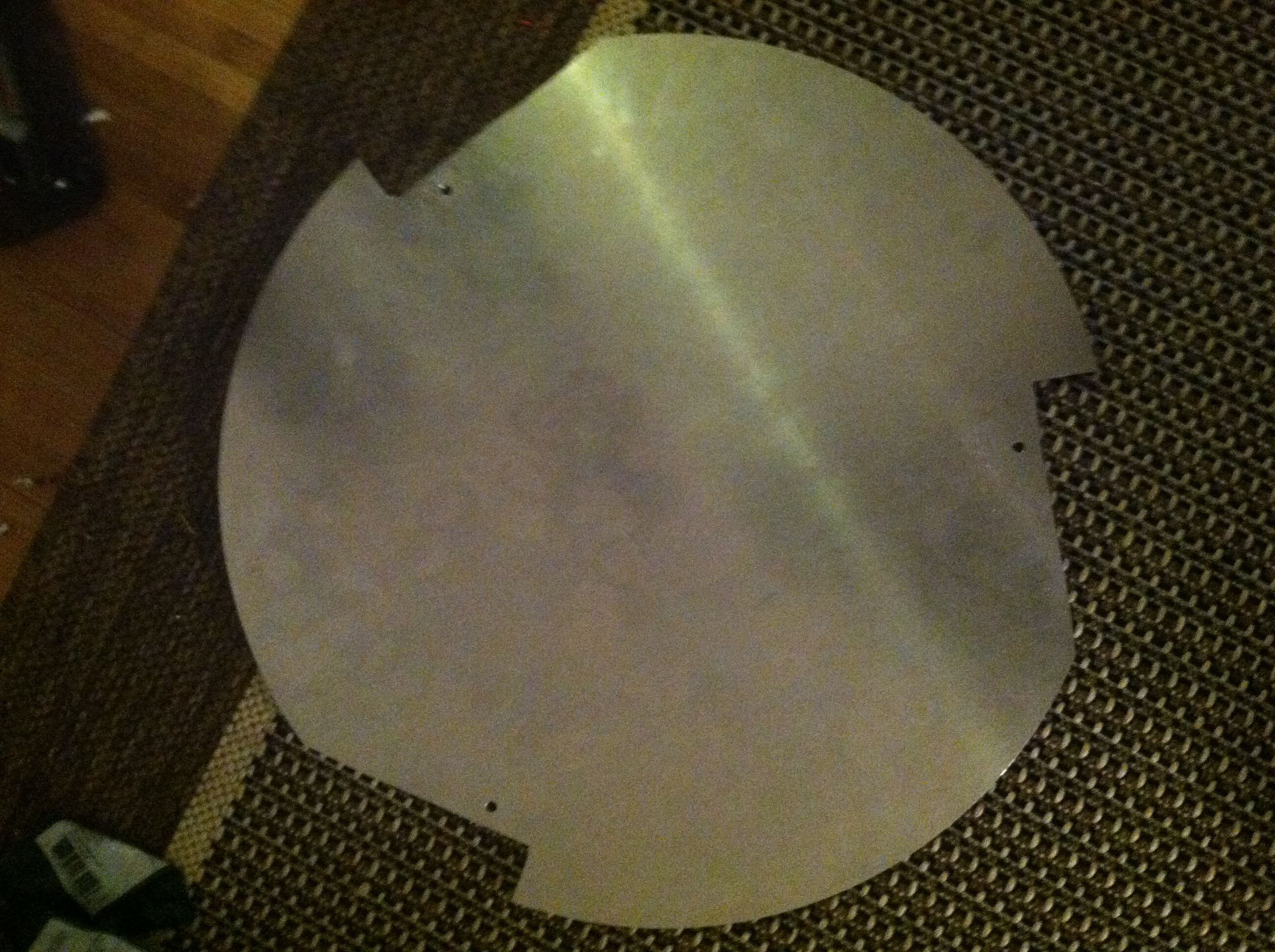

And i cut the base plate to fit in between the pillars
And then JB welded the resistors to the bottom of the plate.
a couple pics of the SSR

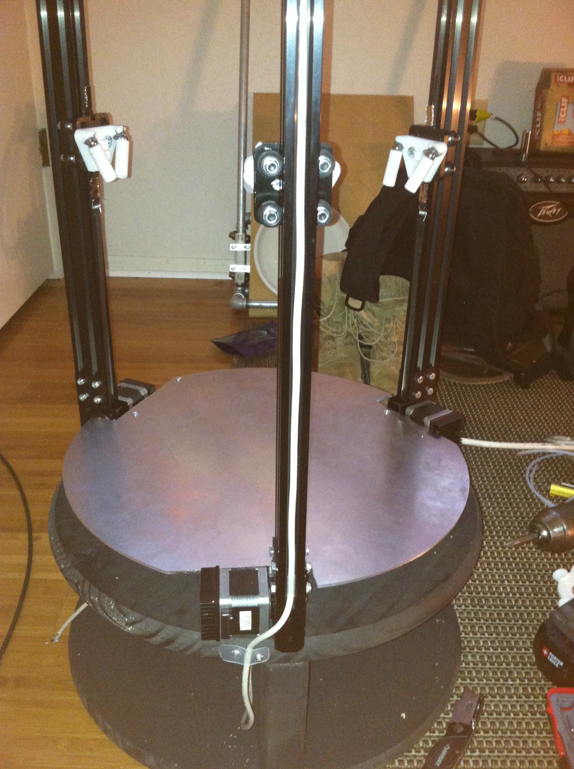

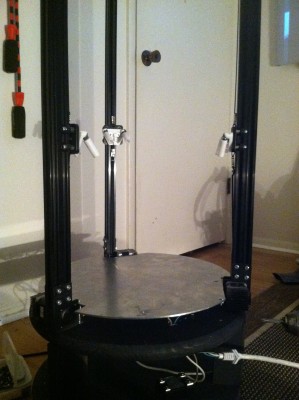

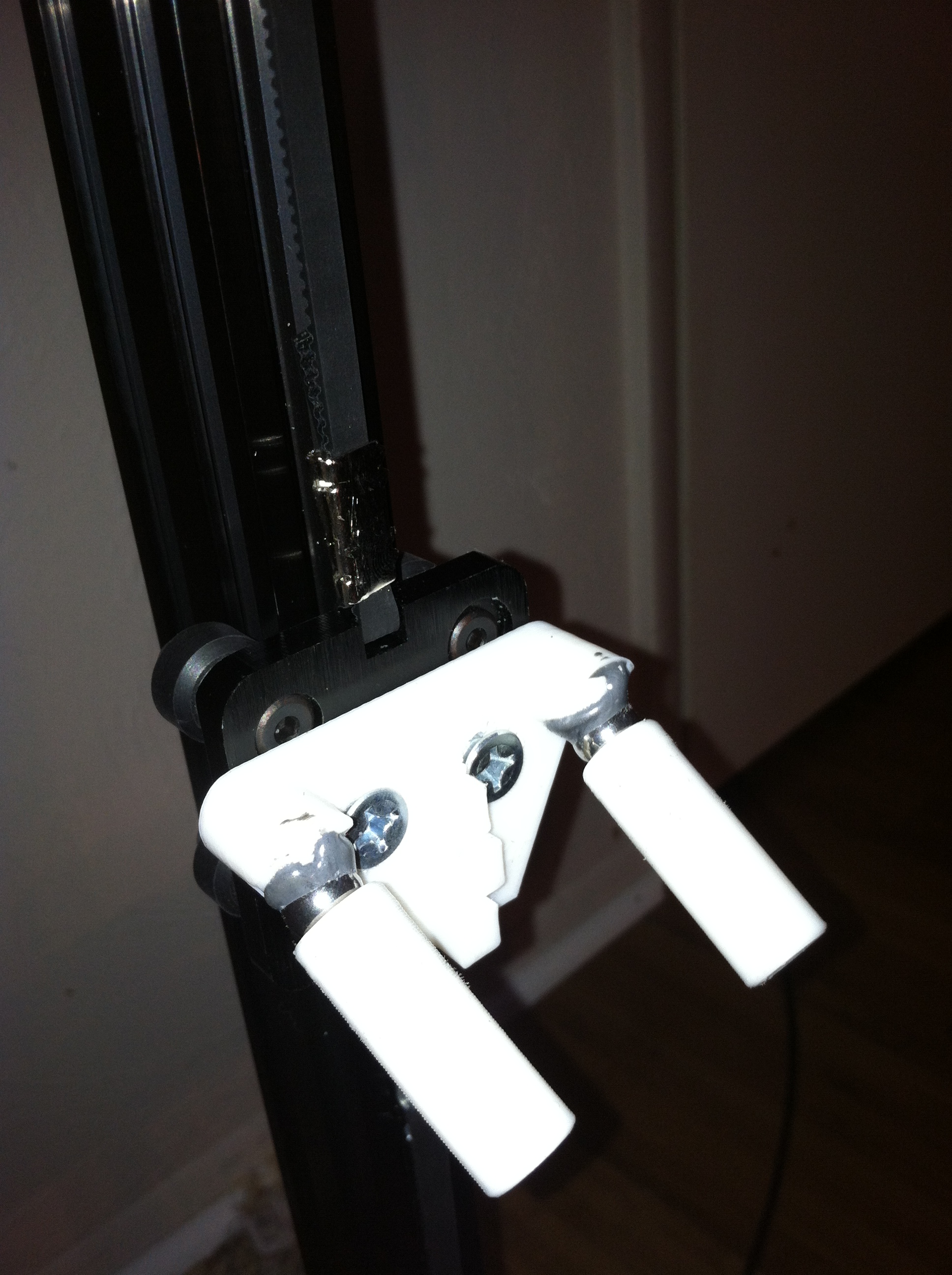

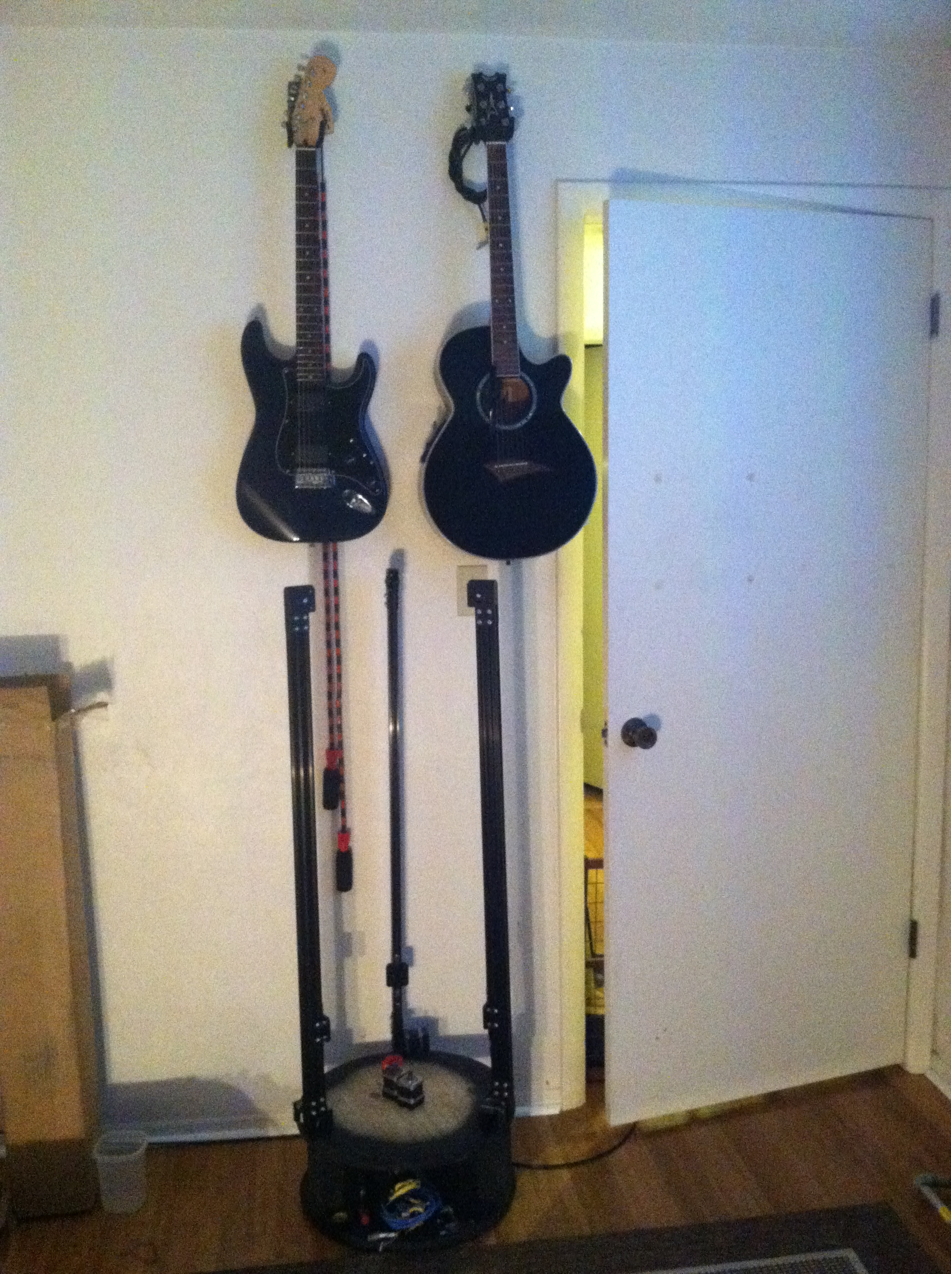

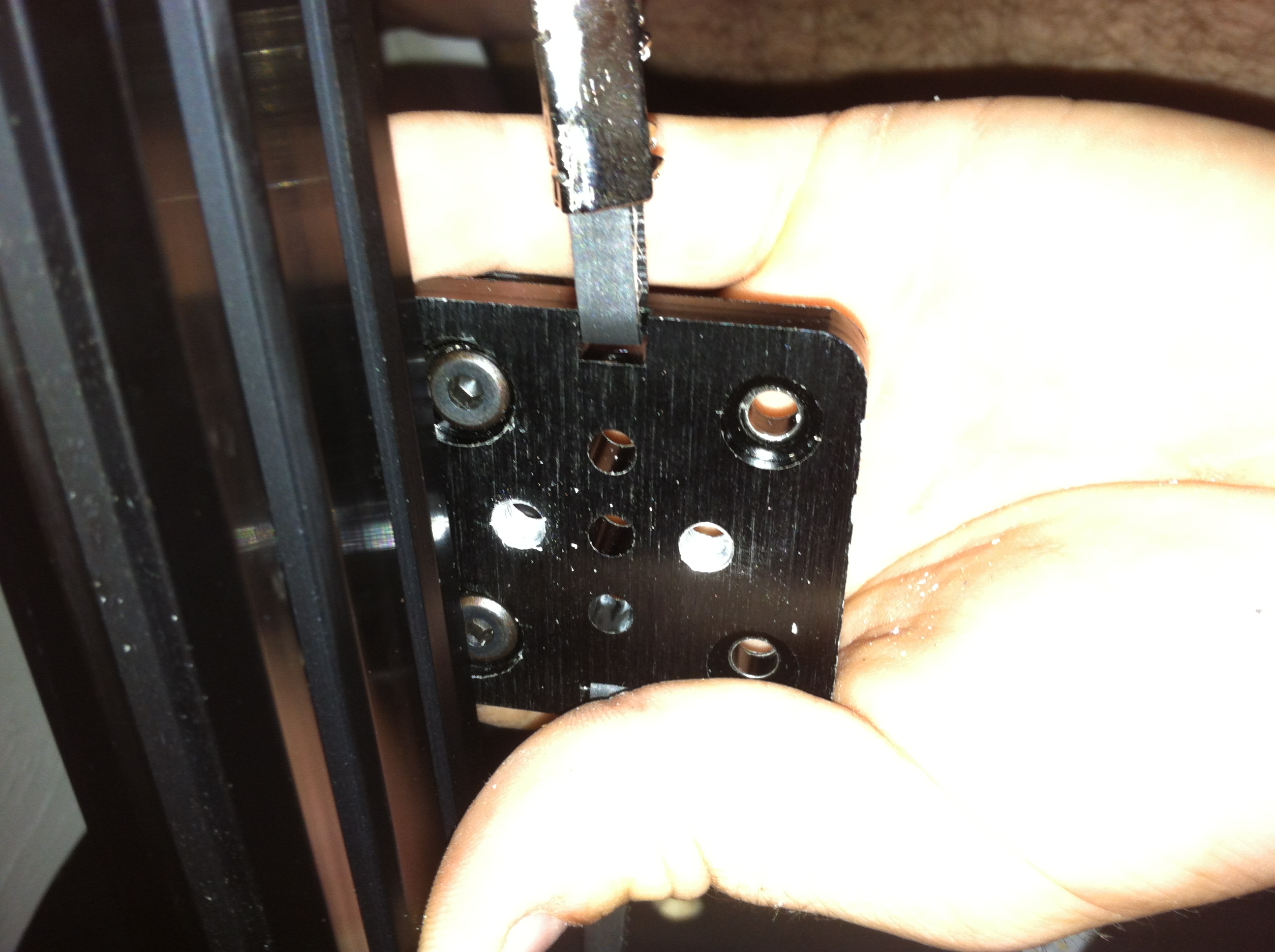

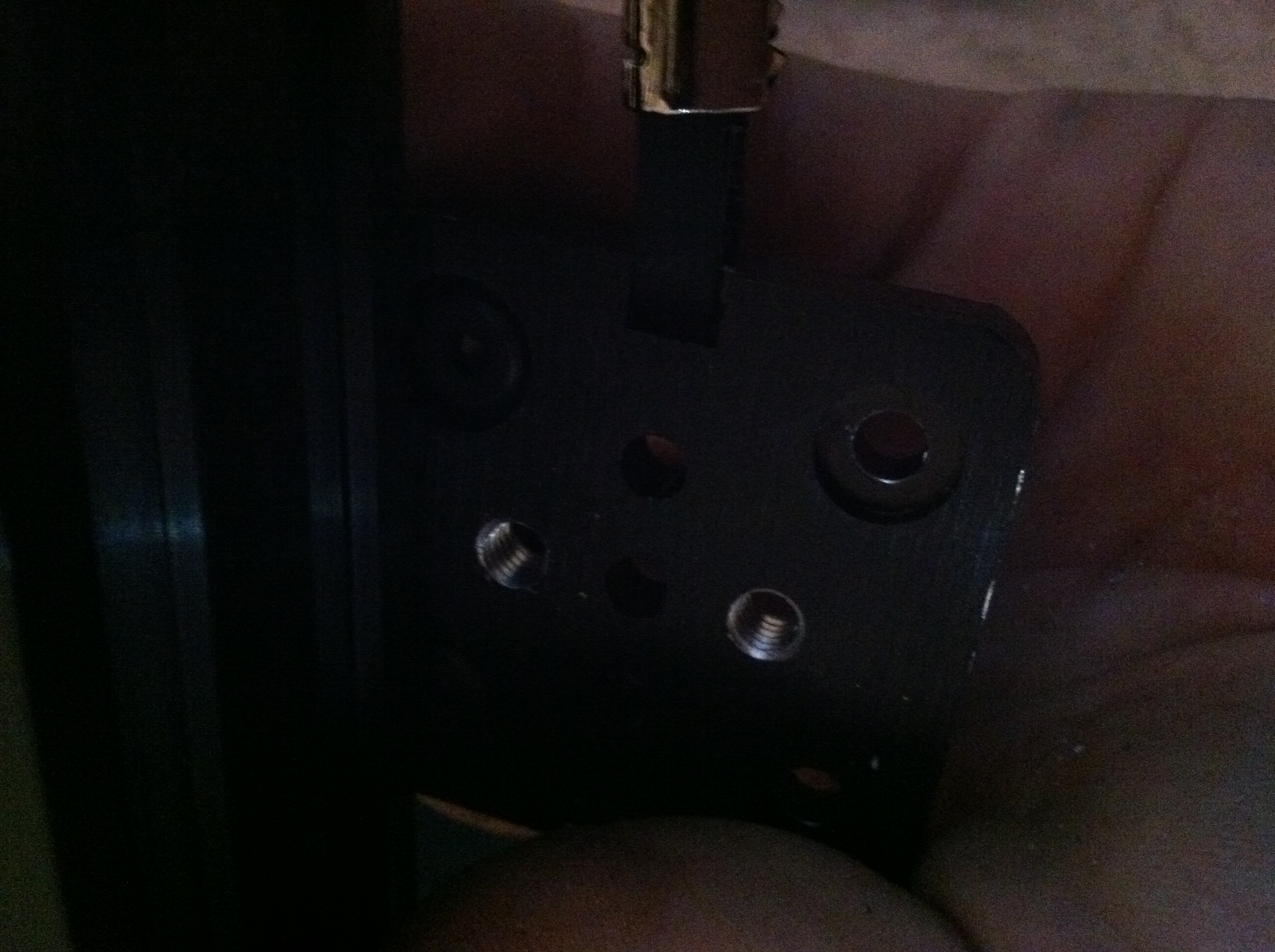

Tapped out the holes to 6MM X 1.0
Running a cable for the LED lighting.

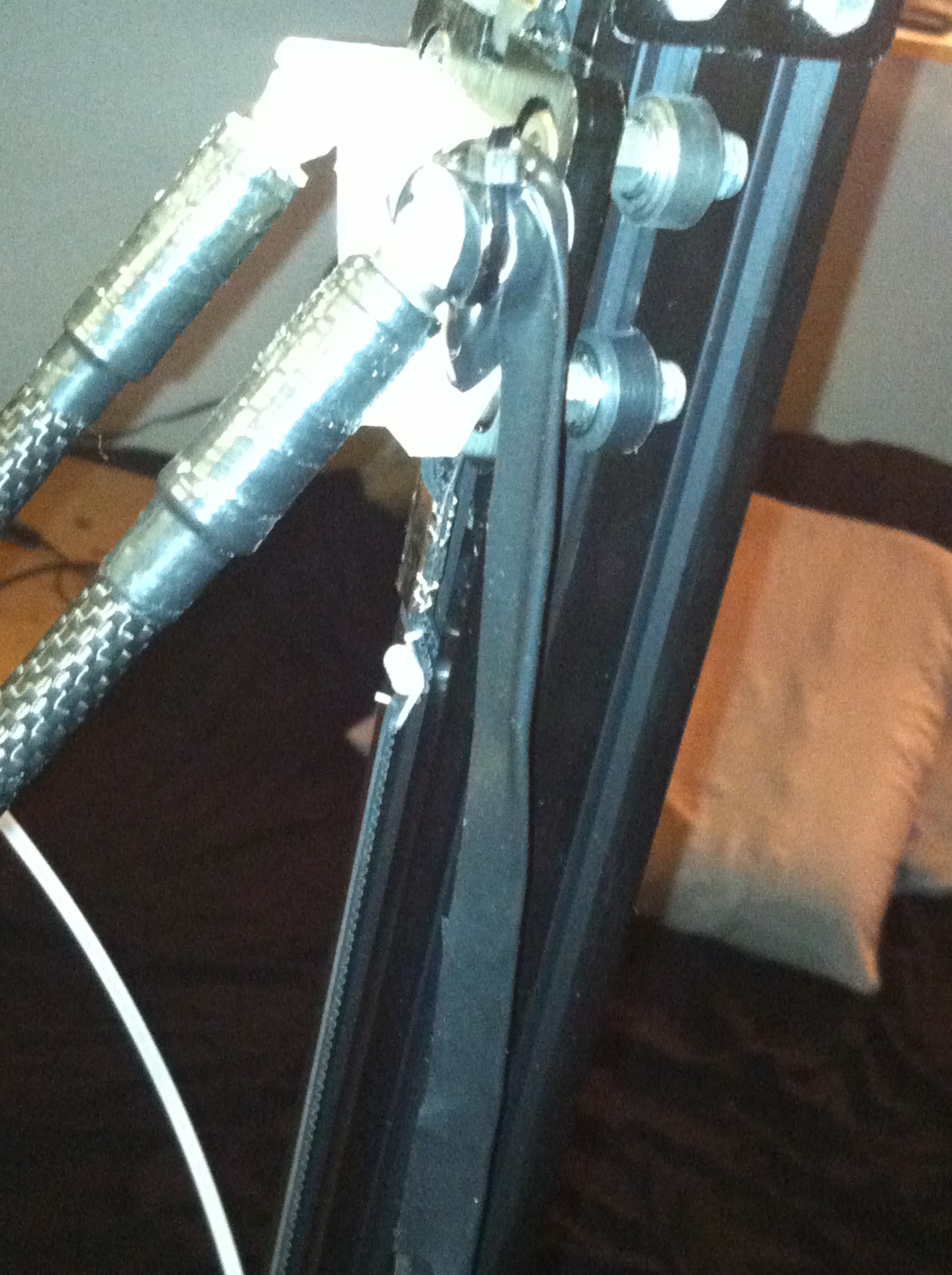

The arms are bolted on.
Wiring up the heated bed. I grounded the plate also.
Wiring plus spring loaded adjustment screws.
And a overall look.

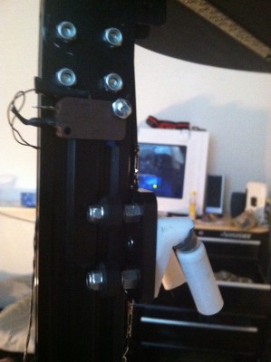

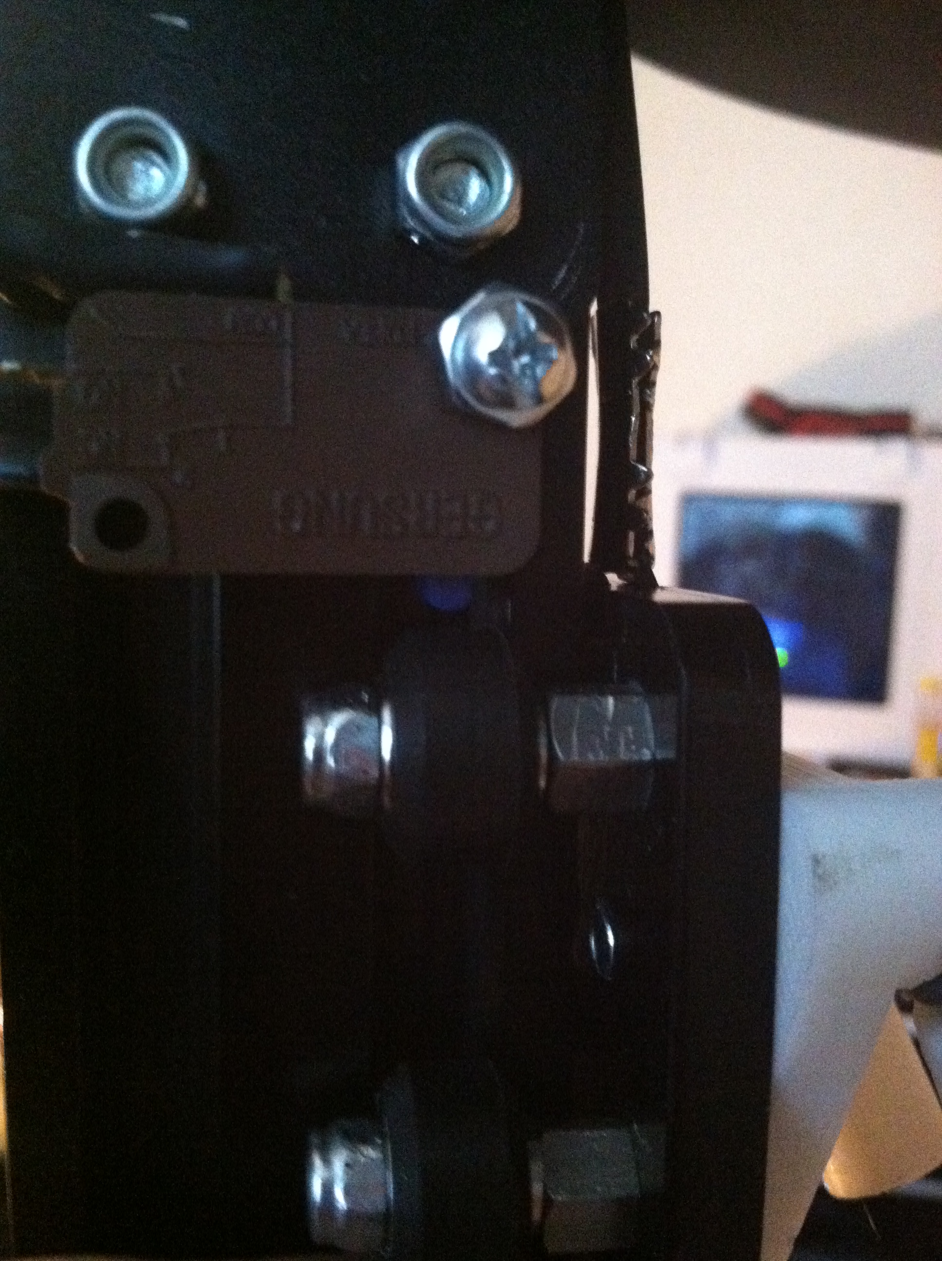

All i did was wire up some limit switches.
I'm waiting on the hotend, the carbon arms, and a azteeg x3 controller because i think i burnt out the ramps :shock: all i saw was smoke and now it wont allow me to put firmware on it anymore. Is there really anything that burns out on the ramps board, or is it just the Mega board?
