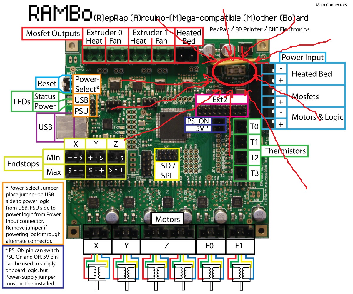

sorry i wasn't been here alot lately , it's exams time and i'm study alot but from time to time, at the night i give the printer to print...
few min ago the printer got dead in middle of printing , as i look at the board i saw 3 fuses, 1 big ( like a car fuse) and 2 very small ones, when i made a jumper on one of them the printer got her life again ,
so now i need new micro fuse that i don't know where to buy, anyone know and can help me ?
the picture here show witch fuse burn to death

The original 5A fuse is
LittleFuse 0451005.NRL
The 10A version is
LittleFuse 0451010.NRL
Available from Mouser.com or Digikey.com
You can use the 10 amp fuses.
Buy some spares.

Thanks Eagle , they sold it only in 5000 pieces, all i need is 10....

Orenfor wrote:Thanks Eagle , they sold it only in 5000 pieces, all i need is 10....
I just went to mouser.com and searched for 0451010.NRL They sell them quantity one at $1.52 and qty 10 at $1.22 ea.

before you replace it with a 10Amp be sure to find out what caused it to blow

well. I didn't find any on the site. But I did find them on eBay so I buy 10 . About the reason i know why it's happan, i try to be smart . I put mono audio connector to the hot end and it's start to disconnect, got heat and make the fuse burn....
