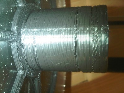

filament gouge issue
well that only took a hour before it messed up again here is pic

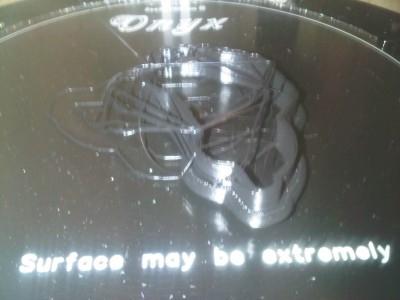

by wildideas1
once again fail
once again fail
once again the failures are killing me ever since the NOV challenge i have not had 1 print complete only changed nozzle to .7 from .5 upgraded firmware host as eaglesoar pointed out today is now .95 host not rambo and just verified that rambo is .80 so i guess i will update that next. but that shouldn't cause issues im having with the ez strudder skipping and eating the filament then not extruding due to the gouge in filament. to day i slowed down the accelerate of prime/suck from 55 to 25 and that helped but still is happening and ez teeth are clogging up fast. THIS NEVER HAPPENED till nozzle change i am determined to figure it out then i will be able to go back and forth on nozzle size.
