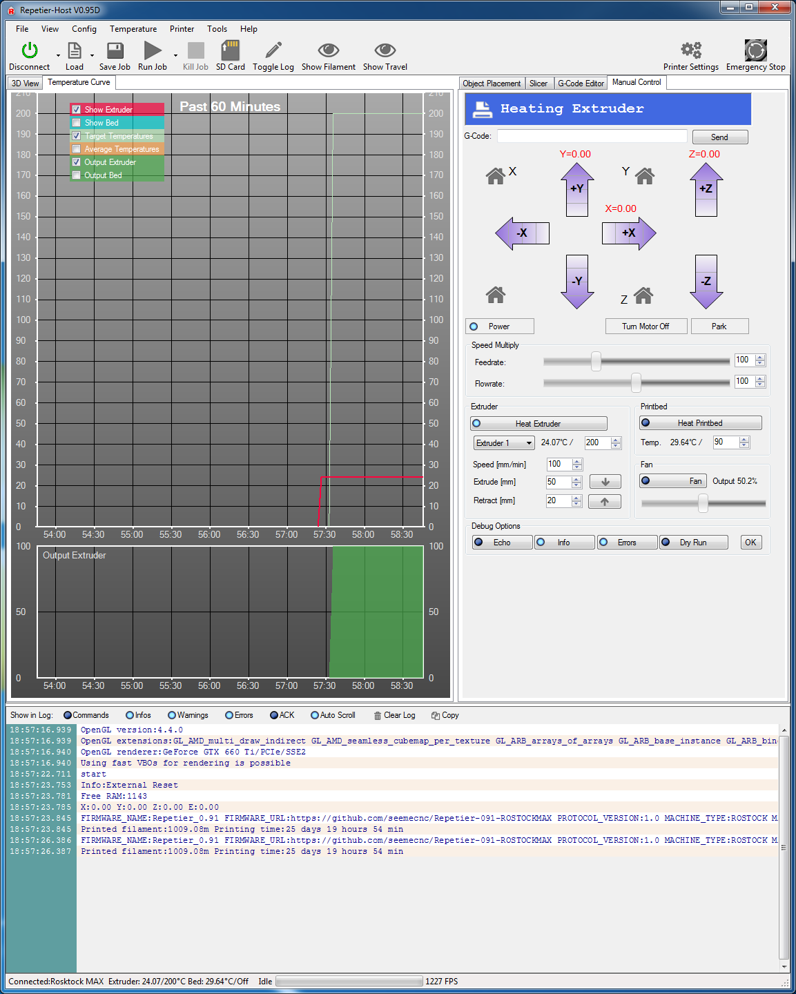

My hotend is no longer working. I have checked the voltage at the “Heat 0” terminal on the Rambo and I get zero. I checked all the terminals at main power port and they show 12v as expected. Repetier shows max power being sent to the hotend.
I changed the line in the config file from
Code: Select all
#define EXT0_HEATER_PIN HEATER_0_PIN
To
Code: Select all
#define EXT0_HEATER_PIN HEATER_1_PIN
And still got zero on HEAT 1 terminal.
also checked the F3 fuse.. should there be 12v across the F3 fuse?
Any suggestions??

I am at a loss here...
aerouta
Posts: 185
Re: Hot End Not Working
Post by aerouta »
It was F3 after all. I got heat!
