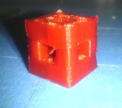

I'm attaching photo of first-print of calibration block. It started out 'ok', first layer is a bit too thick, then seems 'ok' for a few layers, but then layers started to get offset - angling toward between the X and Y towers. I am did calibration, got x y z and center all equal distance, can slide paper below head same on all points. Using 0.91 on the repetier upload to arduino.
It isn't like the X Y is going offset on an angle, it goes up fairly straight, then all of sudden shift over and keeps printing shifted and then later shift again.
This is on a Rostock Max, just completed the build. Please help, really want to get going on printing real files.
Thanks Jim

According to a previous post by Polygonhell the leaning implies a loose belt/pulley or a skipping stepper, it will be leaning towards or away from the offending tower when it's printing.

Thanks for the reply. I looked up a thread on "Maybe Belt / Motor Skipping" and i don't think it is the same problem. I don't hear or detect any belt teeth slipping Or if it is, i am not sure other then listening for it, how to detect it. I ran a test G-Code script that was in that thread for running the head all around, up and down, etc, and never heard anything that could be perceived as a skip or slip.
The part does lean away from the Z axis, and that belt was tighter than the other two. I thought it might be too tight, because it was very taunt. I loosened it, not made it loose, but just loosened it to make it same as the other 2. But, it made no difference. Additional prints seem to look exactly the same, they shift over at the same places, same amounts.
Any ideas of where to go from here. I am running .91 repetier with the standard settings found in Gene B's 2nd edition manual.

Possibly a loose connection where it is loosing steps.
dpmacri
Posts: 314
Location: Beaverton, OR, USA
Re: Leaning offset first print, what am i doing wrong?
Post by dpmacri »
I've also seen this when the motor currents where too low -- specifically after a firmware upgrade. In Configuration.h, search for CURRENT where you'll see something like (175,175,175,225,0). Try chaning the 175's to 195 and see if that helps.
Posts: 5359
If the gear on the stepper is slipping, you won't necessarily hear it happen. That being said, dpmacri's suggestion is a good first step.

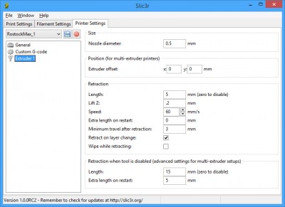

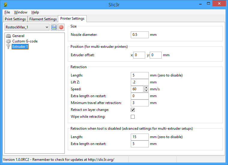

In EEProm the Ext1 Steps per mm = 92.65
Attached is screen shot of the Slic3r extruder settings
I noticed that in the manual controls on repetier it has retract set to 100 mm is that correct?

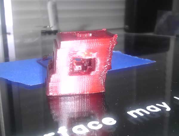

NEW UPDATE OFFSET RESOLVED
Sorry its taking me long time to get back. But, I've been getting somewhere (And it doesn't look like my posts are displaying in right order in the thread - at least not on my system)
dpmacri wrote:A couple thoughts:
1) There have been problems reported where the end-stop wires receive interference from the stepper wires and the firmware things an axis is against an end-stop. Since the problem happens when the extruder motor is running, see if the extruder motor wires are touching one of the end-stop wires (or very close to them).
Yea, We ran both the extruder motor and Z axis home sw down the same tower. That was the problem with the offset issue. I've rerouted the Z axis sw down the Y axis along with the Y axis sw.
But, I don't understand the logic - why would interference on the home sw cause the prints to offset? If the program detected the sw was hit, then wouldn't it be thinking the head is way up and try to bring it all the way down to where it's printing on that axis? Why just go offset at that point? And, the other question is, why is the program even looking for the Home sw when it's printing? Seems like it would only need to look for home after it gets a 'home' command and starts running the head up. Then it would seem that the program could just ignore the home sw while printing. Does anyone know the logic of why the home sw is being monitored during print?
There are tweaking issues i now need to address :
Here is photo of the new block (I scaled the block to 75% to save on plastic.)
The block is definitly more straight, not shifting to one side as before. But, the block is slighter fatter at the base and the bulges back out toward the mid to top. The edges on the holes are not sharp, and at the top there are those rabbit ears on the corners - it prints like that, each layer has those ears, from close to the base on up.
Should i post these issues in a separate thread?
Thanks to everyone who helped out with the offset issue. Maybe Gene should make a note for the next edition of the manual to NOT run the extruder stepper wires in the same tower as an axis sw. When i had an analog input to an offboard arduino hooked up to the sw on the Rambo side (I was monitoring for glitches, didn't work), but it suppressed the noise and i got the same print as shown. But, i tried to put additional pull up resister on the sw input, and that didn't help. It must have been the capacitance helped. Maybe a small cap would have worked, to filter out the EMF, but i didn't have various sizes to try it out. Too large a cap would delay the detection of the sw, so i just re-routed the wires, and got the print shown (did several, they came out the same).

I'm not 100% certain why the firmware checks the end stop switches continuously, but I *think* it's a protection mechanism that's been built in for cartesion printers that use both min & max end-stop switches. That way the firmware won't keep running steppers if they hit one of the end-stops (min or max). And I'm also guessing that it doesn't screw up the position because the SW is just checking whether or not an end-stop is pressed. It doesn't adjust any values based on that.
Regarding your rabbit ears, I think it means you're extruding too much filament. If you haven't already, try doing the extruder calibration to make sure the extruder moves X mm when you tell it to move X mm. And make sure to accurately measure the diameter of your filament in a few places and average those to tell the slicer what it is.

I think what is happening, is;
the switches are probably on an interrupt pin on the microcontroller for the reason dpmarci mentioned. This way the software doesn't have to actually look for such an event. it is kind of hard wired into the IC, and once the interrupt is triggered, the firmware handles it in a specified way.
as far as the rest of it goes, this makes sense. on a delta, when homing, and one of the LS is tripped, the other motors have to run.
where, on the tower that the LS is tripped on, the firmware stops that motor.
Makes me want to do some dead head prints and try it out.
Posts: 2417
Location: Redmond WA
Post by Polygonhell »
When not homing, the switches are just a safety all it does when they open is stop moving the axis, this results in the shift.
The firmware just assumes the head is always where it should be.
There is a flag in configuration.h that disables testing the switch while printing and a lot of people run with them disabled (me included). On Cartesian printers what happens is when you hit the end with no checking is the motor stalls, it just buzzes a bit, and ruins the print. The issue on a delta printer is that if you are printing something very tall, and you do hit the top it will destroy the belt because with the long belt run the stepper has enough torque to eat the belt, rather than stopping.
