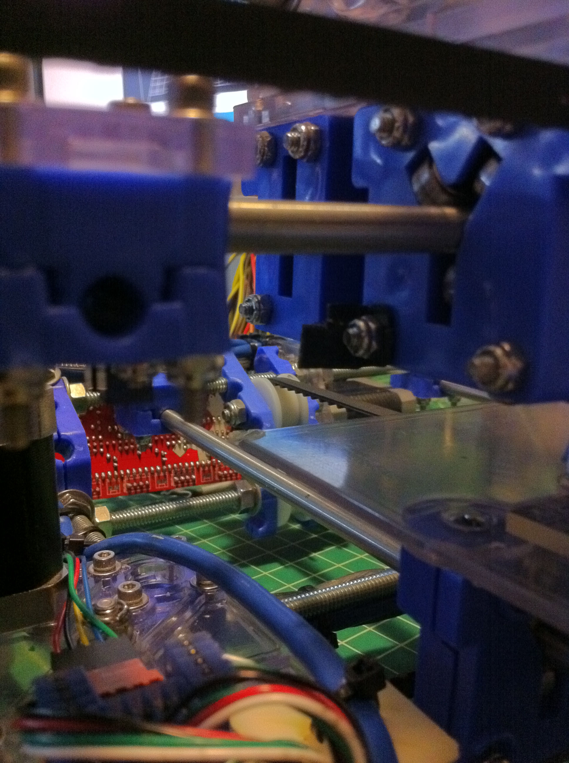

Well I was installing the "hose clamp" X axis tensioner this evening. No daughter or grand daughter around so it was pretty quiet. Got everything buttoned up, loaded a file, and let-r-rip. Well snap is more like it. The nozzle hit the print bed going to 0,0,0 then as it moved to start the loop I drug the tip across the kapton-on-glass and the next thing I know it's all fubar'd.

Here are some pics of the photo-interrupter endstops. They are old (~3 weeks old) but the endstops are in the same location and look the same.

There is a place in Slic3r where you can add code for it to do. I am thinking about adding some to raise the Z a bit before the move to the center of the bed for just this reason.
Mine is a Prusa, but not immune to this very thing. Where it homes, there is no bed under it. Nice to be able to purge the nozzle, but if you forgot to readjust the bed or it is just a bit low for some reason, wham. If the Z lifts instead and then goes to center and then down again, there is no real crash. My bed is on springs, so easier on the hotend.
You might consider that as well.

For my H-1 I have the standard/basic bed (the one that comes with the kit) attached to the carriages and then a heat bed (custom built) is held in place with bolts and springs to make leveling/adjusting a breeze.

So I *had* 2 days home between trips and still haven't had a chance to touch my printer. I'm hoping for this afternoon when the storm comes in and its just me and the Mrs. in the house.
My current problem is getting the rest of the melted PEEK out of the aluminum part of the hot end. Even with dental picks its a bear.
Anyone have any ideas? I also thought of running a tap through it but I bet its non standard.

heat it up first with a torch.

Yep, torch or heat gun set to burn :-)

3/8-24 is the thread size chris

But when my wife wasn't looking I grabbed it and held it over the gas stove for a few minutes and let it burn the PEEK out. I now am reassembling it and just got done with the RTV on the thermister. Hopefully when I get back in town Friday night I can get the rest of it back together.
